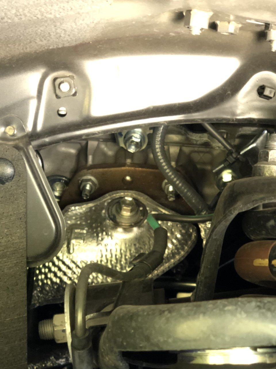

    Anyone else missing this bolt ?

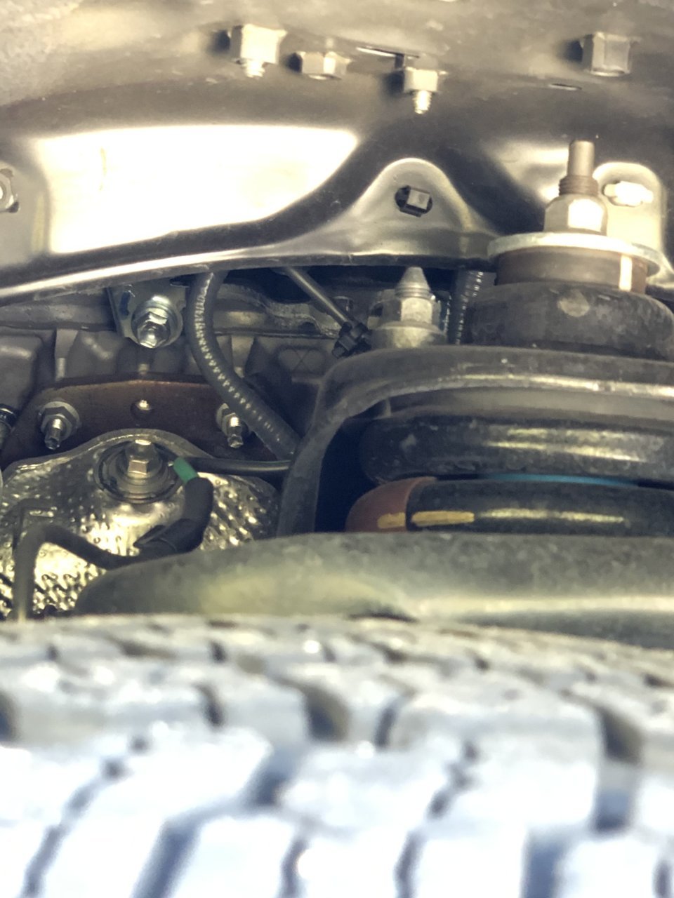

    Front both sides are missing

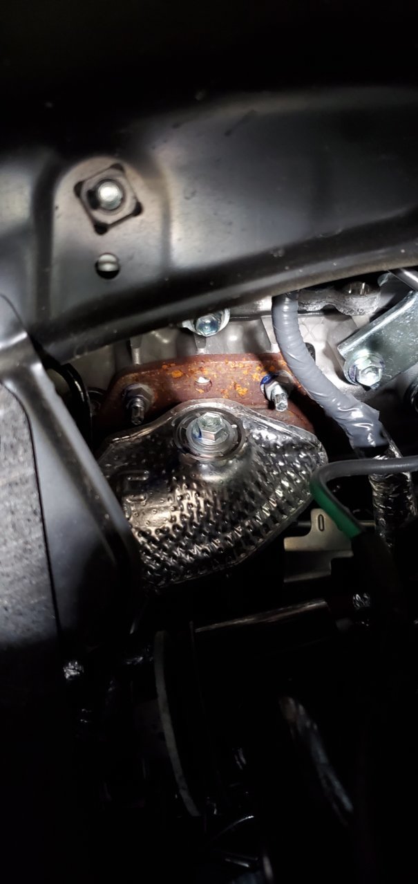

    i'll check after work. guessing it's intentional though.

    Even though the manifold flange has a hole in that spot, there is no hole in the head. The manifold has 4 studs and nuts that hold it on. You're not missing anything.

    I'll also add that different models of Toyota/Lexus do use that hole to mount up a heat shield.

    Just to put you at ease OP
