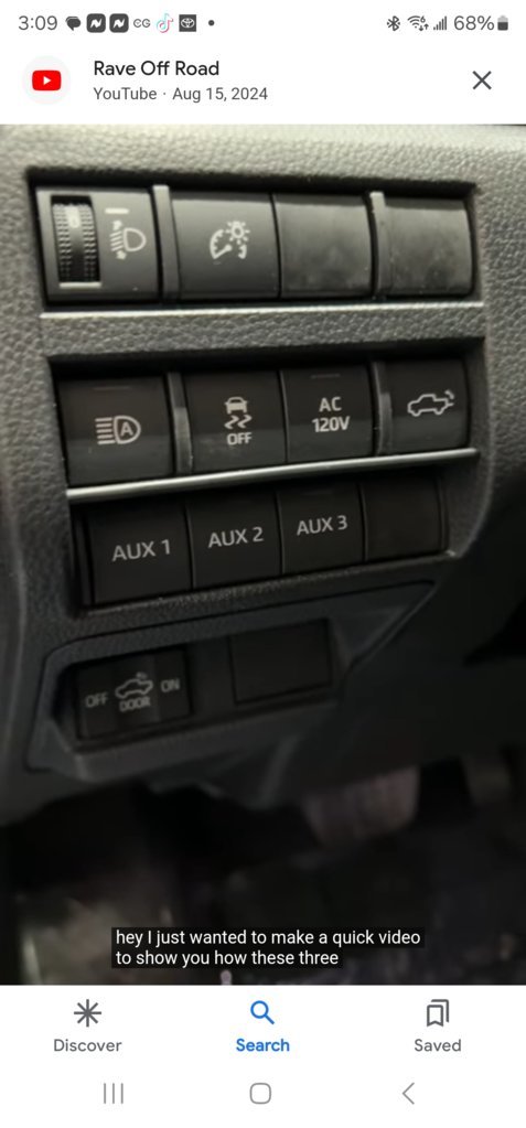

    This is what is missing; AUX1, AUX2, and AUX 3 Screenshot_20240921_150914_Google.jpg

    AUX switches only come with the upgrade and premium packages. Standard on PRO and TH.
    You’ll need to run wires and add switches.

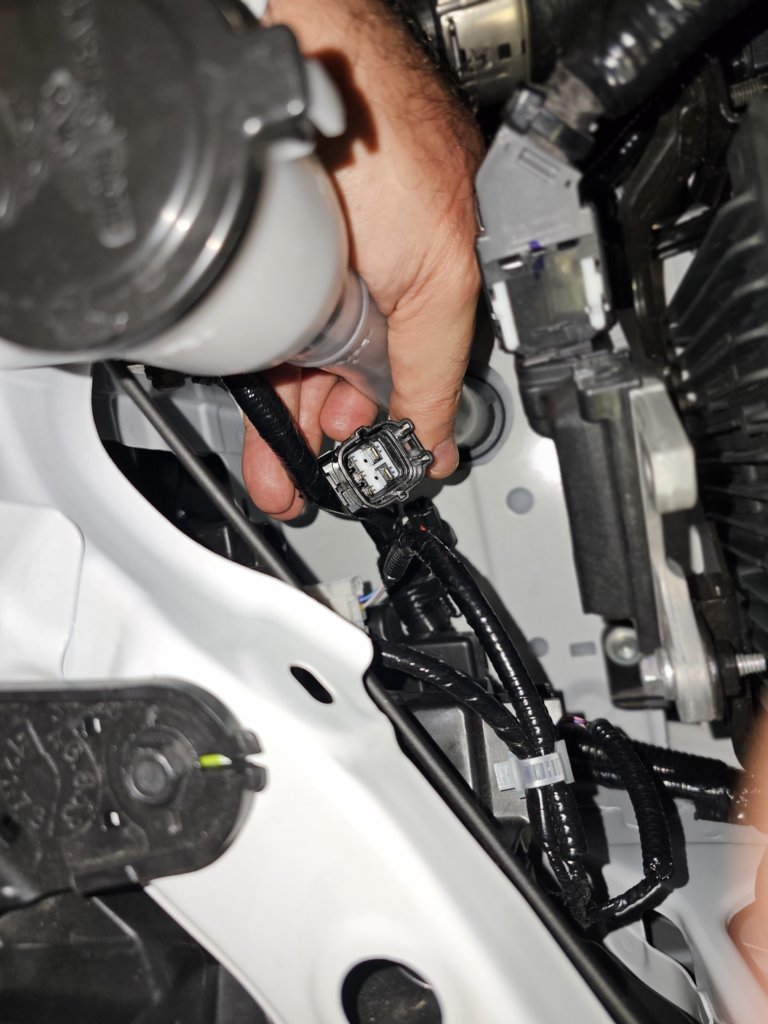

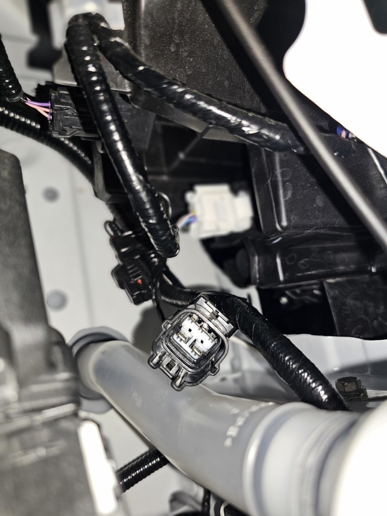

    I was looking on you tube and I saw this video, so I started to poke around inside my hood and I found a covered connection next to window washer fluid filler shown in the video and it had a cover. When I removed the cover, I saw a connection so I think that means some of the wiring harness exist, but clearly the switches inside don't and who know how all of that connects on the inside. I wonder if anyone knows. Hopefully the switches all come together with a plug and play options.

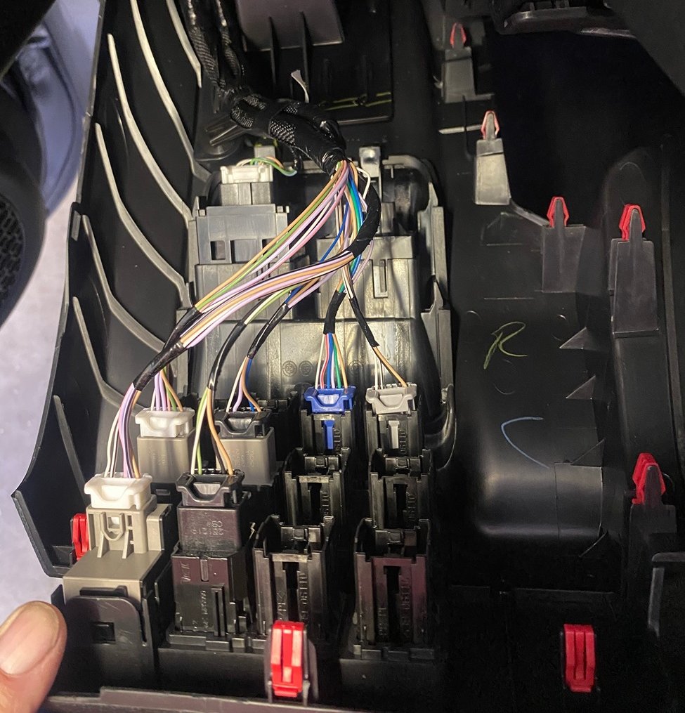

    Have you even removed the switch cover and looked? Toyota has the habit of taping the connectors to the harness when switches are not installed.
    Panel is held by horizontal plugs. Pull straight back to remove.

    Re: That video. That youtuber missed that there is a connector cable with its own pigtail. The cable will plug into two different plugs. You should see two plugs taped very close to each other. One will stick up closer to you than the other. The forum link provided goes into further detail.
