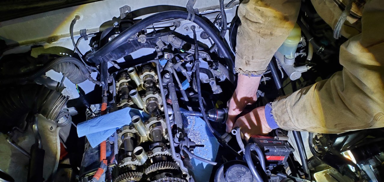

    98 toyota tacoma 2.7 3rz
    Just finished my swap, I ran out of coolant on my 98 2.7l and warped my engine block. Bad compression gasket the works. Decided a motor swap would be easier and lo and behold I got a distributor type 2.7l off ebay. Distributor was easy, pull it out, cut a piece of sheet metal to fit the coil packs off the original motor over with form a gasket to help seal the hole underneath them. Next issue was the camshaft sensor, I pulled off the valve cover on the new motor, and used a dial caliper to discover the hole for the camshaft sensor is 18mm, I found a close match in standard I think it was don't quote me but a 23/32. Just order an 18 but double check before you drill. At this point the motor was in the engine bay, wish I had drilled on an engine stand or even on the hoist... drilled and tapped a hole for the screw to hold the sensor in and I missed. I elongated the hole made sure it landed in roughly the right spot and used black formagasket and the newly threaded bolt to hold in the sensor. Hand drill and a 20$ drill bit. Use a punch to mark your centers on both hole and tap before you start. Computer doesn't know the difference. I did buy a new camshaft sensor cuz I figure it's out, and it will suck if I ever have to change it.... I don't want to remove the value cover again if you know what I mean. Anyway next issue was the intake manifold, I started with a 4 port and the new motor has an 8 port. I just used the one on the new motor, modified hose lengths and it now purrs like a happy kitten. Actually better than my original motor ever did. The truck has been in the family since it was new and now it has been reborn with some 250+ miles on it.
    Make sure you don't leave any shavings in the valve cover! Also plug all the holes of your intake with something clean as shavings in there will also reak havoc on your engine!
