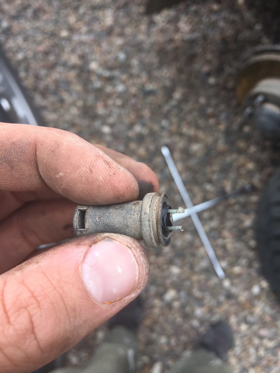

    Hey this clip fell off of my starter when I replaced the contacts/plunger. The clip broke so I can't put it back on.
    Starter works fine and I've been driving it for a week but I want to know:
    1. what does it do?
    2. what should I do - just tape up the hole on the starter or something else?
    Thanks

    It's a vent, should be fine without it but it really just shields water and debris from getting in.

    Good to know it's a vent hole - but probably means I can't just tape it up like I had hoped.
    I spend a decent amount of time driving on forest roads in dirt mud and snow, along with an occasional deep puddle crossing now and again, and I figure some debris or water would kick up into that hole at some point, possibly grinding/shorting inside. Anyone have ideas for replacing/fixing?
    I'm sure I could JB weld it on or something, and I might be able to fix that broken clip itself though it may break off again soon. Preliminary searching online hasn't shown any part number or availability. Any ideas?

    I would go to a local auto supply store and see if they have any starts being sent out for a core rebuild and see if you can snag one off there. I'm sure they are replaced when they rebuild the starters.
