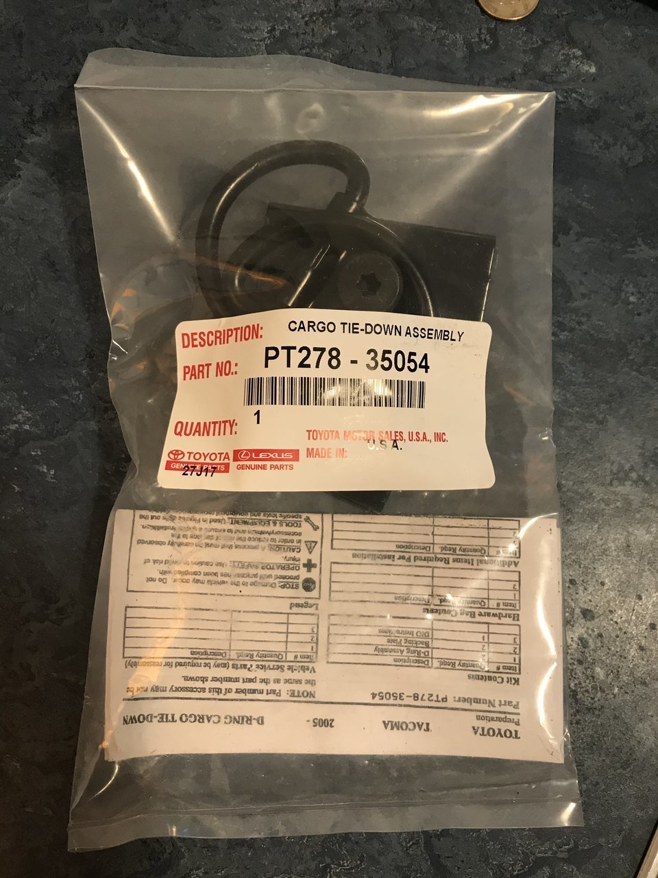

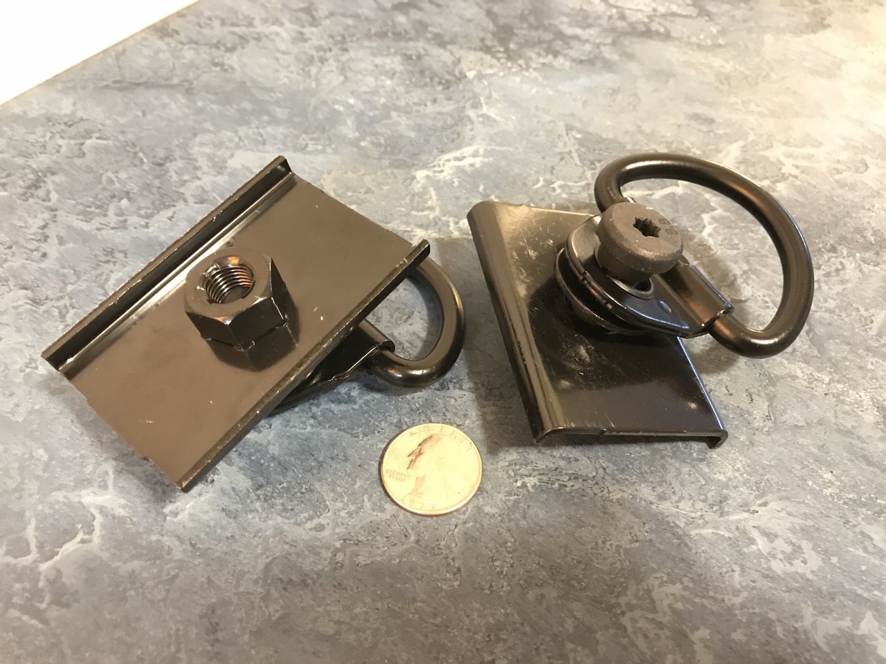

    Wonder if it's possible they "forgot" to install them at the factory? This is strange.
    For what it's worth, the OEM "D" loops are great (like what's on the bed floor at the back corners). You can get them for like $25 on Amazon or at a dealer. They come painted, with a heavy duty backing plate that has a nut welded to it for the underside of the bed. Imo it's the best option out there. They won't rust, they maintain rotation, and they're heavy duty (front side and back side).

    Here they are...

    The factory instructions have you install them on the wheel well. For me, it's too close to the hooks that the op is missing (but are present in my truck). So I put them elsewhere.
    There are a couple other great places to put them on the bed floor. The backing plate will sit nicely between ribs on the floor. Just get underneath the wheel well and look for a spot where the backing plate will fit.

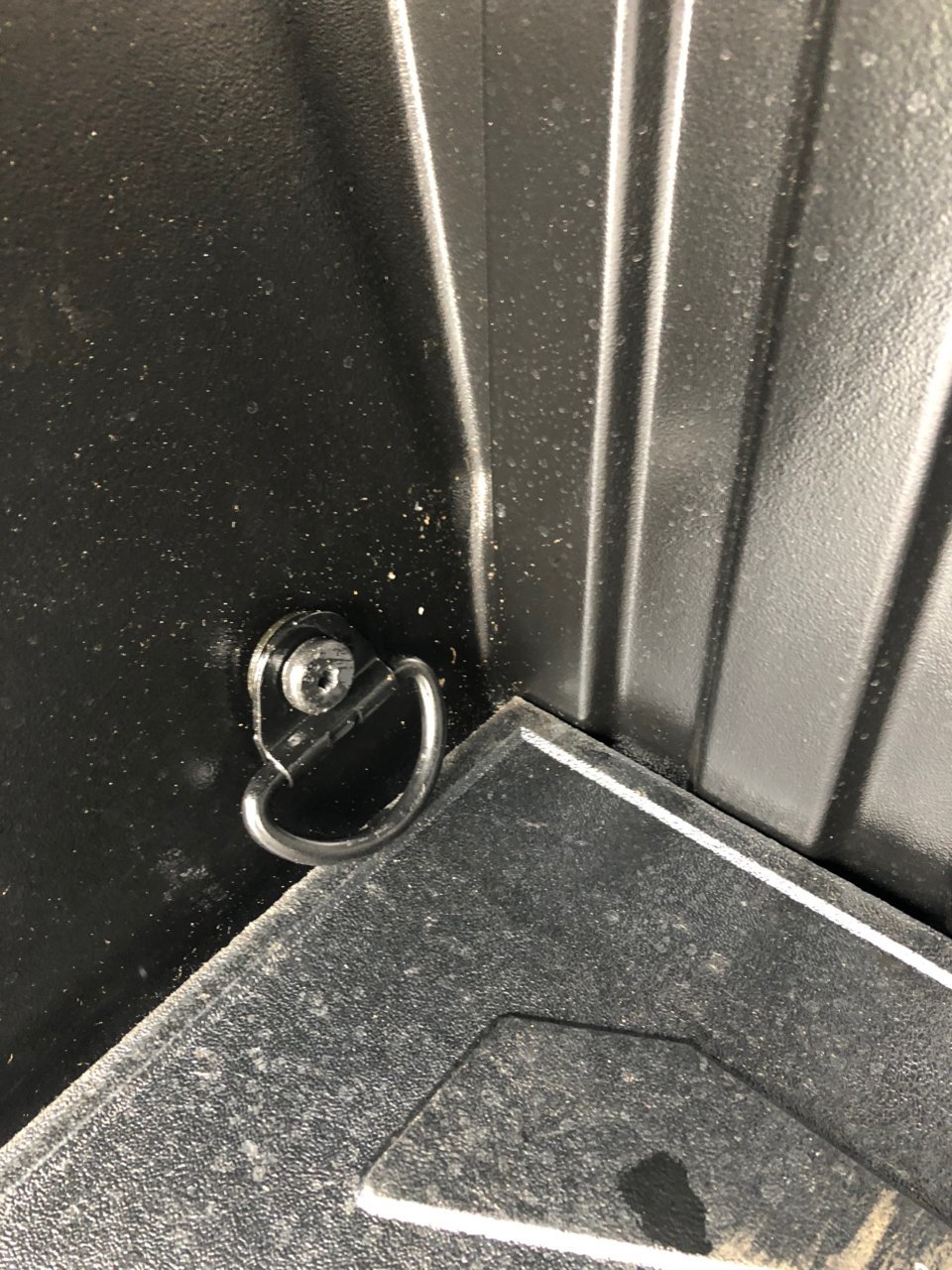

    D-ring tie-downs.

    My 2018 ACC CB has what the OP's truck is missing, but these are a better answer. These trucks should have come with two in the front to match the two in the back.
    Thanks for the part numbers..

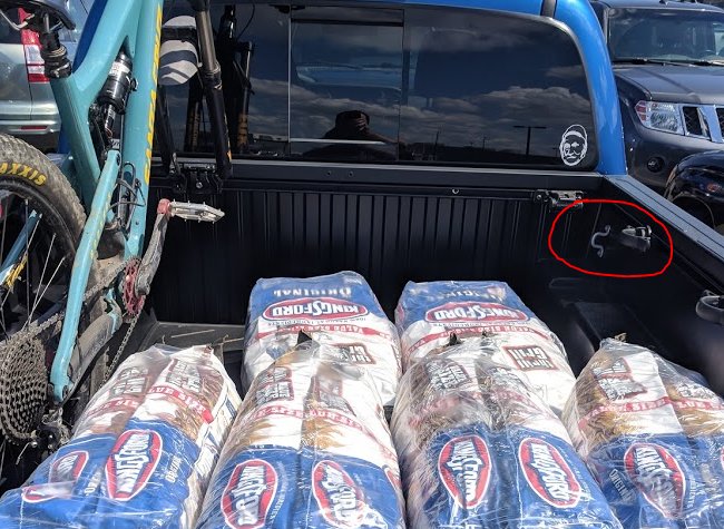

    Check with Toyota directly but I believe the threads here discuss the weight capacity of the stock cleats are under 200lbs of force. As this picture indicates the touch points of the factory cleats
