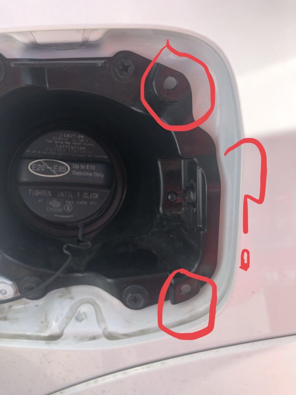

    But I kept hearing a rattle and thought it was something in the backseat. It was until I was pumping gas did I notice that the gas cover felt loose when I closed it. It closes fine. But rattles. I assume it’s missing a rubber or something
    Anyone have a P/N number for these or a link to buy some?
    If not you think dealer would fix on their dime? And can I go to any dealer?
    Thanks in advance.

    Yep, two pieces of rubber.
    Mine are missing too. Caught myself knocking them out with a washing mitt, but still ended up losing them.
    Easy in, even easier out.
    My door doesn't rattle so no mas for me.

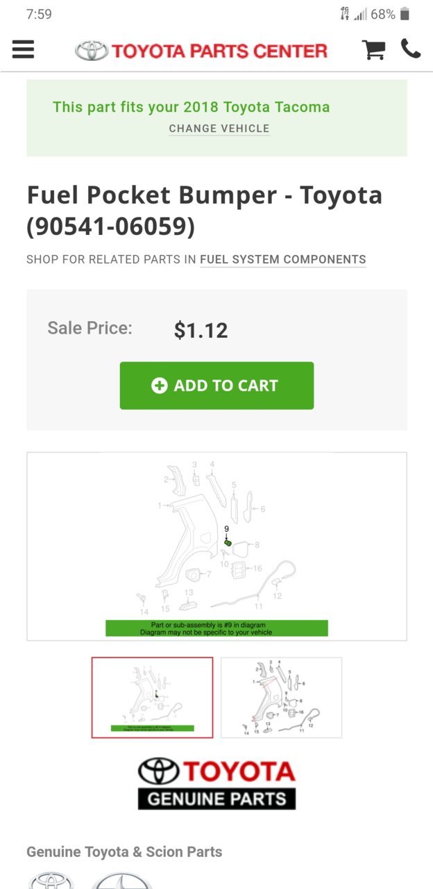

    Does this look right?
  9. Jul 16, 2019 at 6:07 PM
    TacomaStevie
    TacomaStevie [OP] Well-Known Member
    Jan 2, 2019
    #277811
    112
    San Antonio, TX
    2019 White Tacoma TRD Sport
    Thank you!!!
    daddy_o[QUOTED] likes this.
  10. Jul 16, 2019 at 6:09 PM
    daddy_o
    daddy_o Well-Known Member
    Nov 1, 2015
    #168380
    5,472
    Bossier City, La
    2018 TRD Sport, Inferno, w/tech package
    Factory Blackout package, Soft roll up bed cover, Cheap seat covers, Front and rear dash cam, AVS in channel vent visors
    You're welcome. I think that's the right part, but you can now google that part number to verify.

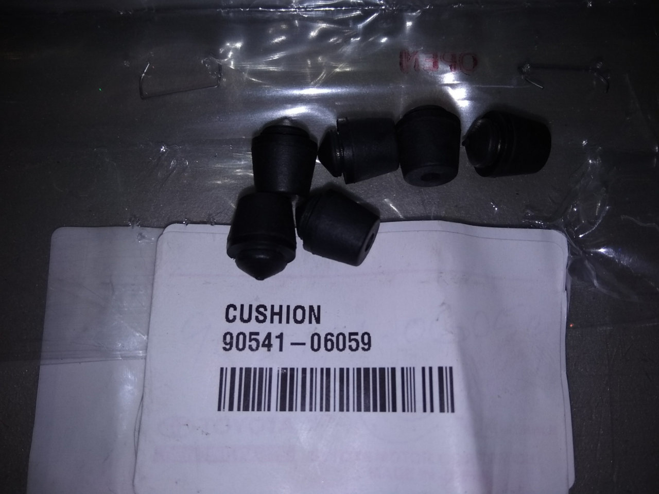

    I wasn't 100 percent sure. Here is an image from Google.

  14. Jul 16, 2019 at 6:17 PM
    whitetaco97
    whitetaco97 Well-Known Member
    Mar 21, 2016
    #181939
    519
    Tyger
    2017 White TRD sport

    I stand corrected. That's def them. :thumbsup:
    Different than the profile in the linked diagram, in my defense. lol
