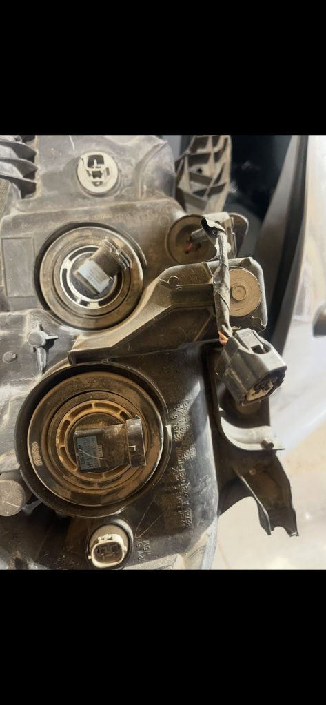

    Can you post a pic of the connector(s) on the back of the headlight?

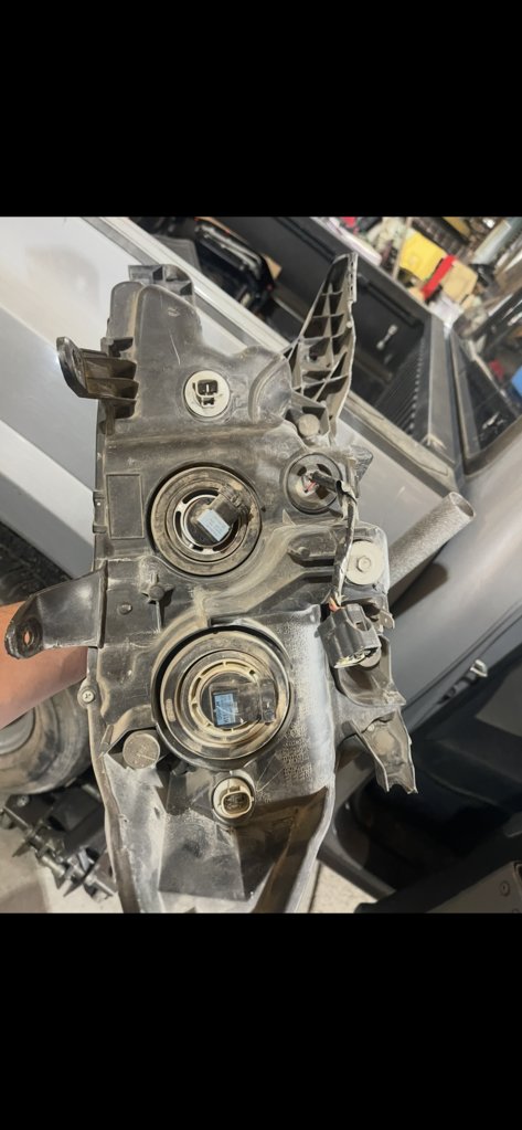

    That is the Halogen headlight not LED. I assume pigtails are available for that.
    Someone here will know where to get them.

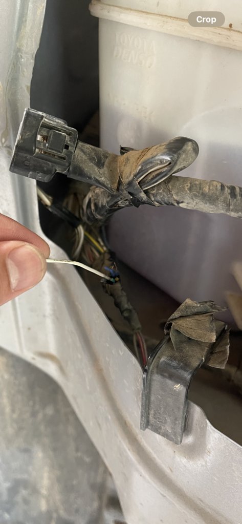

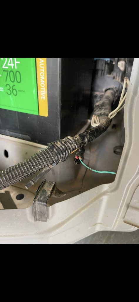

    2019 Black SR
    Sure you don't need one to mate to this plug? I see a cut green wire in one of the pics, and this plug would be the only one with a green wire.
