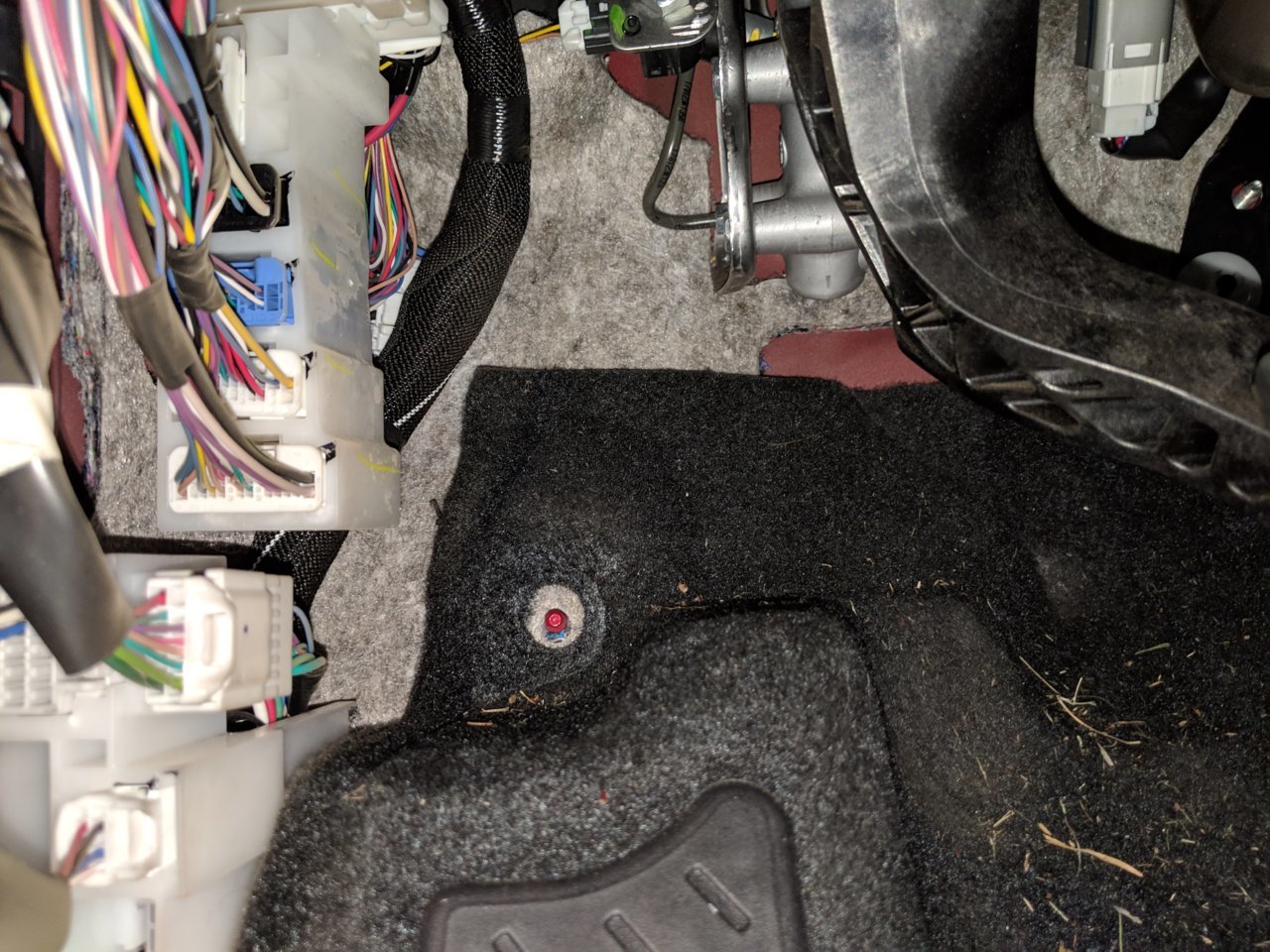

    Dang it! I am using the non-keyed power pin on that connector for my dual usb port. Looks like I'll need to switch it up if we ever get a TT.

    Do you have any pictures/info on this and which wire it is with constant power? Any idea what fuse it comes from and what it's rating is?
    I was thinking that using the trailer brake adapter harness they sell I could rig something up that is plug and play for always on 12v and easily removable if needed.

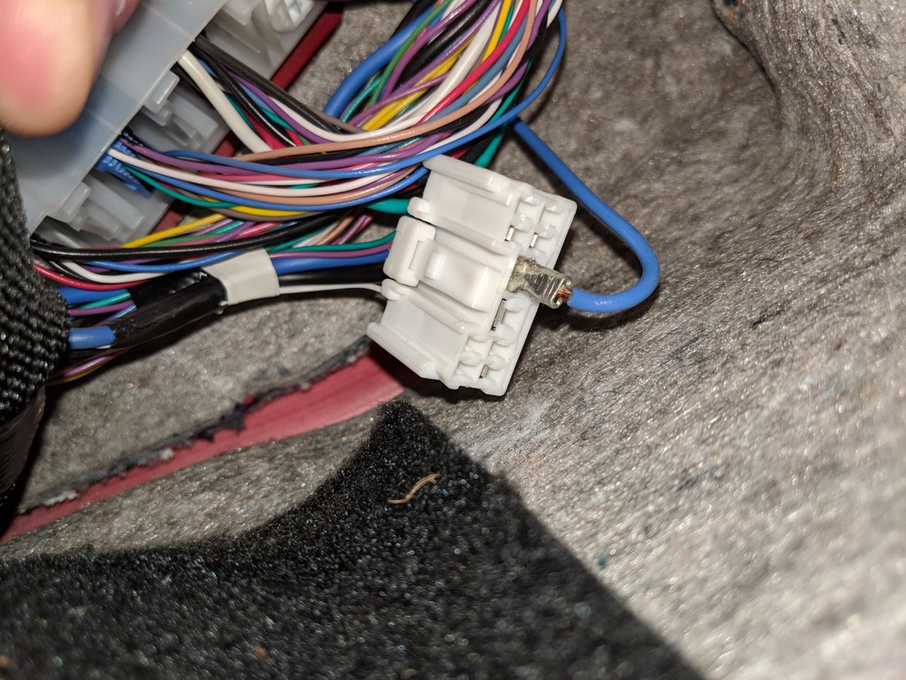

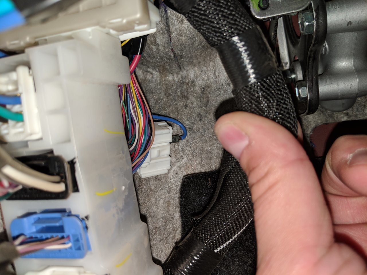

    Yes, I do.
    I will get you the pin later, and a better pic.
    I have no idea about the fuse, but it looks like the pic above.
    The blue wire is my spade / tap.

    Nice! I can look through the tech manual to find the pinout. It would be cool if there is a ground wire in there too.

    Thanks!
    It has supported full charging of two phones with no problems.
    There are a couple chassis grounds. I used the one directly behind the HVAC panel. I think there is one behind the kick panel also?

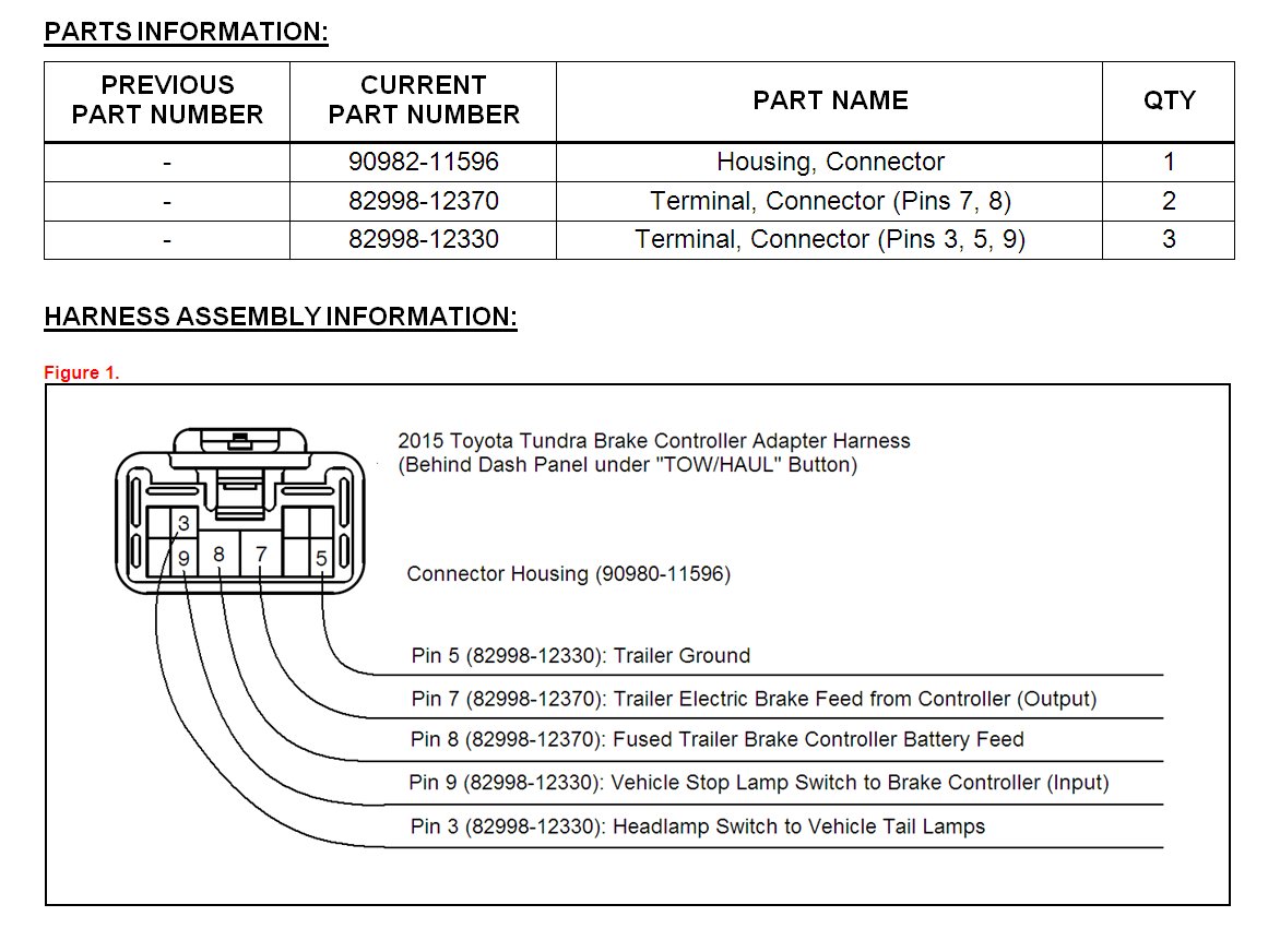

    This diagram is from a 2015 tundra, but probably the same.

    That looks like what I used.
    Good stuff.
    It is funny though, as it looks like Pins 3, 5, and 9 are flipped? Or, is that the back side of the connection?

    I think that diagram is from a Tundra, could possibly be different?
