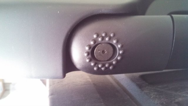

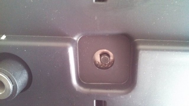

    I just recently installed an OEM roof rack on my truck but during installation I noticed that there was nothing to screw the pivot torx bolt into on the passenger side. The driver's side had basically a threaded piece of metal that it screwed into but there was nothing on the passenger side. Did anyone else have this problem?
    Passenger side, looking down into where the pivot bolt should screw into.. The black that you can see is the top of the roof.
    bottom of Driver side
    Pivot bolt on driver side

    If I'm reading you correctly?
    If your talking cross bars, then 1 side screws on and the other snap locks in place, so you can open and close them?
    They should also be staggered, my passenger side is screwed and my drivers side is snapped in

    Yea the issue is I cant screw in one side. Basically the nut that you screw the pivot bolt into is missing. I can snap the other end into place its just not sturdy enough without being able to have the pivot bolt tightened into something. If that makes sense

    Ive been talking with TRDparts4u and it seems that it was shipped without a square nut and o-ring in the rack itself. So I have that coming in the mail and hopefully that will resolve the issue.

    Here are the missing pieces. Put them in the rack and it was good to go. Real happy with the customer service from TRDparts4u. I would definately recommend them to others
