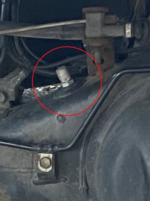

    Configuration of the hole? Are you sure you're looking at the breather?

    Ya it's definitely the breather, same location as your picture. I'm just wondering if it is merely an open hole, it doesn't look like it from my video

    I agree that it doesn't look like just an open hole in your video. I tried to google for some images of the empty axle housing, and while I did find some, I didn't find ones with enough detail there.
    I could see there being a baffle in there to stop oil from directly "splashing" out of the breather, but someone with an axle housing laying around, or someone willing to go out to their rig and remove their breather will have to chime in to let you know for sure.
    It's not terribly difficult to pull the 3rd member, but it's a ton of work...
    Edit:
    Found a 3rd gen pic with some detail. There does appear to be a baffle there.
