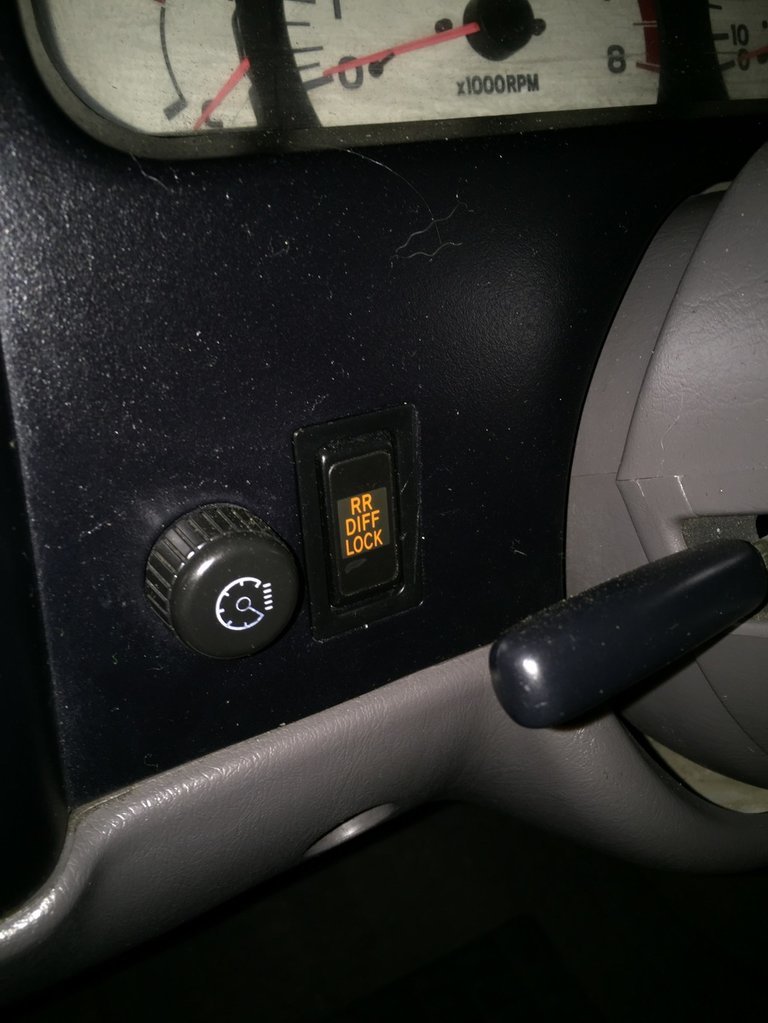

    How about a picture of the lock button on the dash?

    Here a pic of the switch:

    I'm pretty sure the VIN does not indicate whether or not it was a TRD from the factory. The axle code doesn't either.
    B03A means 4.10 gears, and open. There is no letter code for e-locker
    You've been scammed. If he eliminated the cat, then he likely disabled the EGR (cheaters gonna cheat). I'd check that out. Disabling the EGR, unfortunately, is becoming more popular thing to do. In the old days, it made a difference, nowadays it does not.

    The fuse is not related to the e-locker, it protects the circuitry for engaging/disengaging the front axle (ADD system). And you have a 2WD pre-runner, right?
    Does the 'RR Diff Lock' switch illuminate at night?
    Use a very small standard screw-driver to pop out that 'RR Diff Lock' switch, and check for wires attached to it.

    No, the switch doesn't luminate.
    I have popped the switch and there is a harness attached to it.

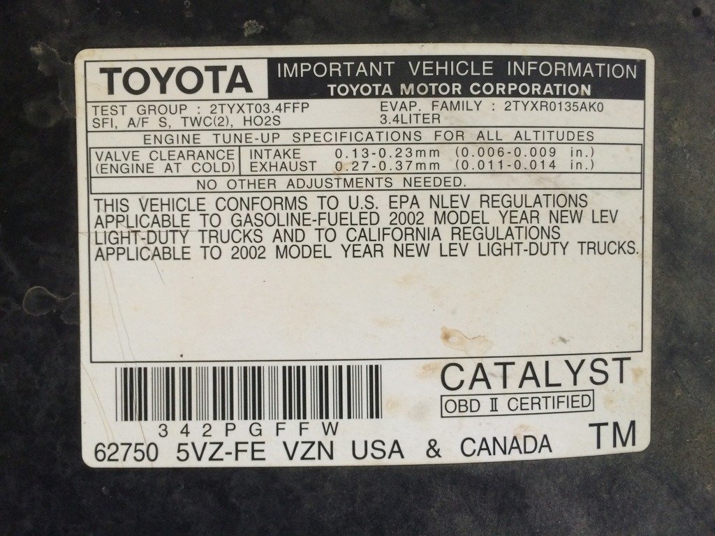

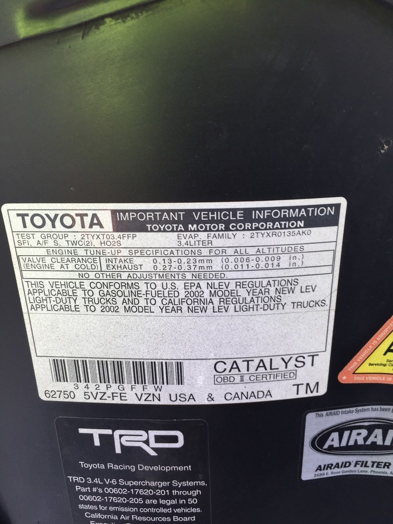

    This is my tag info under the hood.
    2002 V6 TRD 5 speed 4x4
    The extra cat I have is for FFH engine family.
