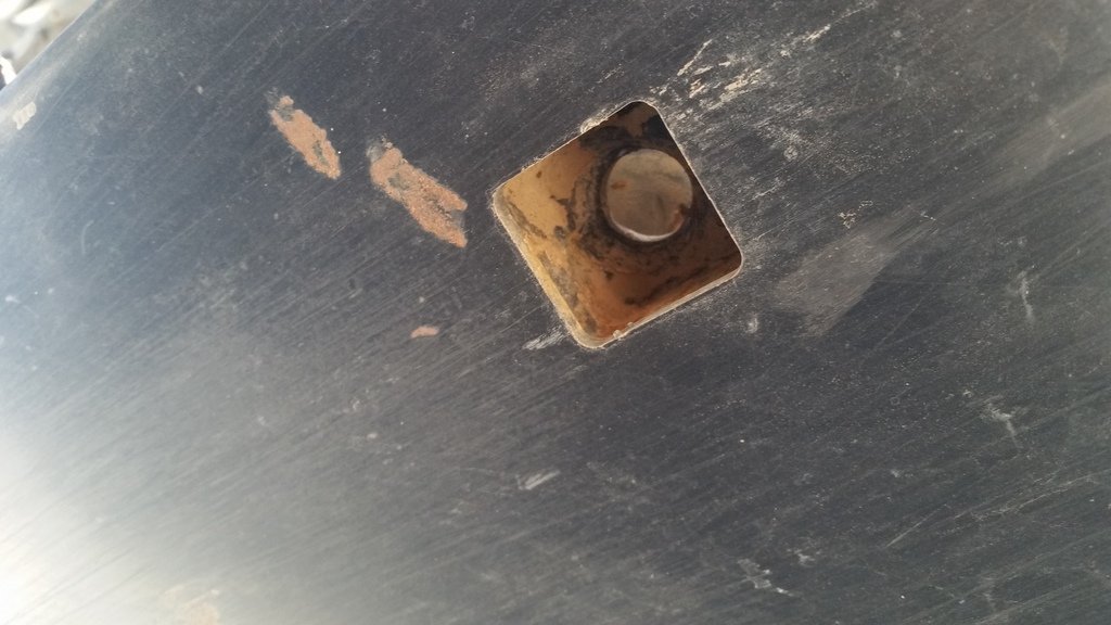

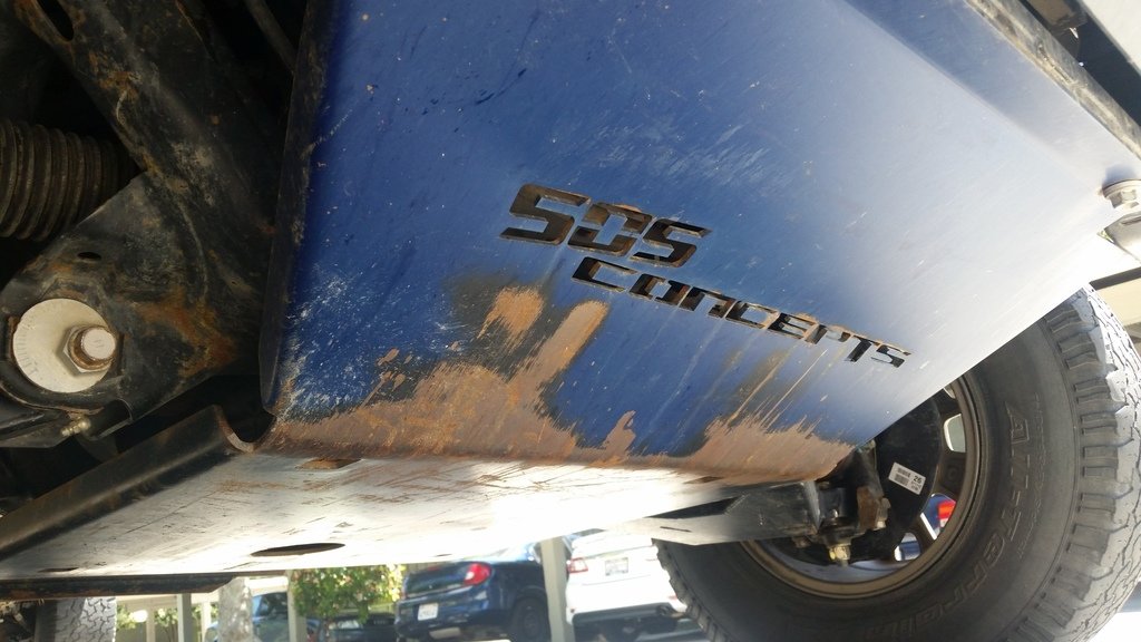

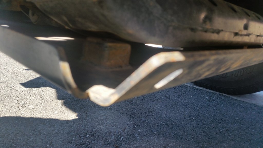

    Um... I don't know what the hell happened here. I know I have not touched the bolts myself since I installed them and have checked their tightness some time ago, but both of the rear bolts are suddenly missing, and now to make matters worse the rear of the plate bolts won't line up to the frame anymore, rendering this skid not even close to useful (not that it did much anyways). Did I bend the frame because of this, or is the plate itself just bent no longer allowing line up? The skid in the front is dented in right where the writing is. I made a post about how it took almost nothing to dent it in a while back in the MT with BS thread. SOS Concepts 3/16 skid btw.
    Here is the dent, may it be related to the fact it no longer aligns?

    The bolts probably vibrated out unless you used locktite or lock washers... The dent knocked the holes out of alignment.
    Take it off and straighten the dent and you could probably get it back on. Use lock washers or locktite.

    Interesting. The problem is I can't see any other dent except the one that is in the front. It may be difficult to realign it since we are talking about exact placement and thick metal here.

    Take it to a metal fabricator with a hydraulic press. They should be able to press it back into shape.

    I bent an allpro ifs and ripped a bolt out of the frame. I put the skid on some 2x4s in the garage and hit it with a sludge hammer till it was flat then retapped the frame and then made the hole in the skid twice as big so it would line up.
