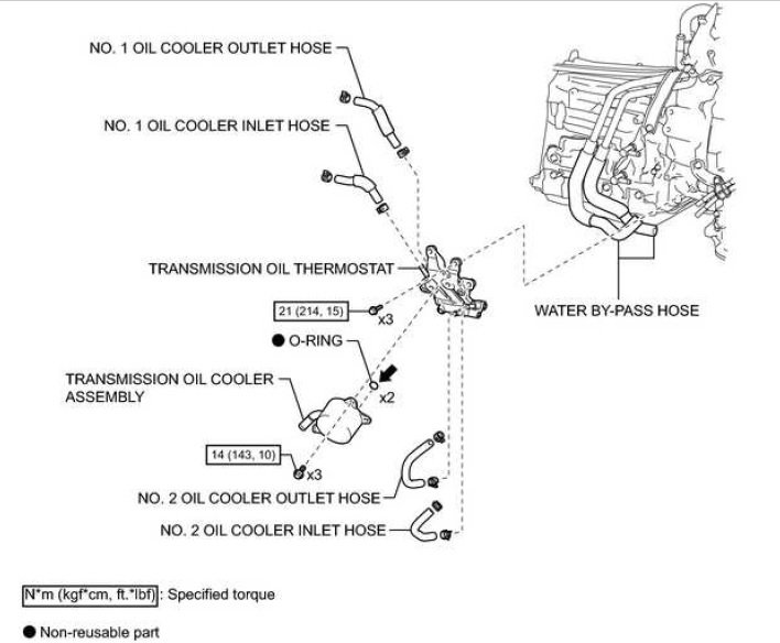

    The short cylinder thing on the thermostat is called the oil cooler; your inquiry is about the air-cooled oil cooler...according to Toyota nomenclature.

    If your rad has an atf cooler built in, the rad will have a transmission line coming in and going out. Just like an external cooler would. Check your radiator for lines that go to and come from your transmission.

    That's the thermostat. It opens up at a certain temperature to send oil to be cooled by the rad/ ext cooler.
