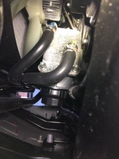

    As far as I know, the aux ATF cooler has always been plumbed in series with the radiator for the past 15 years.

    upgraded? Who knows. :notsure:
    RobP62[QUOTED] and Skydvrr like this.
  12. Jun 15, 2020 at 7:12 PM
    #272
    Skydvrr
    Skydvrr IG: @kalopsianick
    Sep 13, 2017
    #229889
    12,652
    Nick
    YMH
    Black '17 OR
    Yeah like @Nito said, probably upgraded.

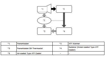

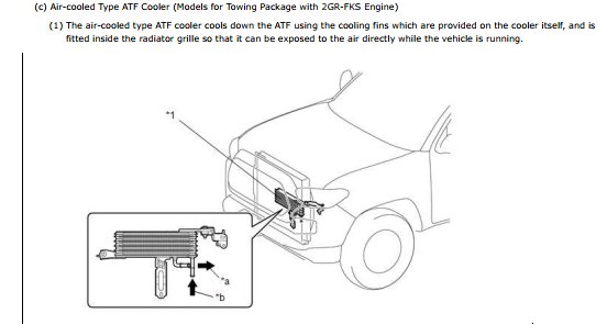

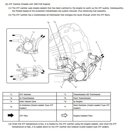

    That canister is the warmer/cooler - the thermostat heats the ATF from engine coolant while warming up, then it functions as a cooler along with the main radiator and air cooler. Below is the ATF cooling flow diagram from TIS.

    Wow, very interesting. How does the warmer/cooler work as far as the cooling function. Thanks for the info.

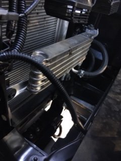

    2/2020 TRD Pro...ive got coolers to burn.
    Trans, engine oil and steering.

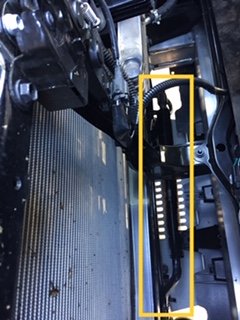

    I wonder if we're using the wrong terms here.
    AFAIK every transmission with a torque converter needs a way to cool itself. What the OP is technically missing is an auxiliary transmission cooler, correct?
    If that's the case it's easy assume it got missed at the factory and nobody caught it. My previous idea about it getting robbed also stands
