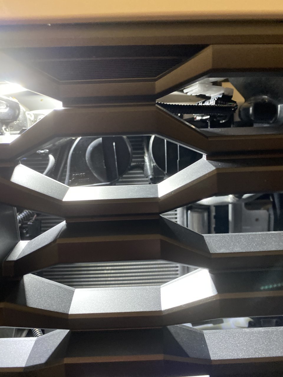

    based on this picture there wouldn't be a transmission cooler because it would be mounted on the right of the center grille pillar on the driver side from where your hand is and where your looking, im starting to think this is another well executed Friday 3rd gen prankster who purposely omitted taking a picture on the right and correct side of that center pillar where the trans cooler can be seen and located based on all the info that has been provided so easy a caveman could find it

    I spoke with my dealer today and verified that there is a puck like cooler on the side of the transmission and another cooler built into the rad so they are not going to do anything. I plan on adding an external cooler in front of the rad like the OEM one.

    Yeah, I asked the service mgr. if it would void my warranty if I install an aftermarket cooler. He said no but that I would have to have fluid added before driving very far.

    Your serv. mgr. should have said "you'll need to add more fluid before you drive anywhere". Not just far.
    There's a very particular method of adding fluid too. Unless the cooler has the exact specs of how much it holds, and then you need to calculate for the lines too.

    if you're going to add a cooler make sure you get extra transmission fluid so you can add it before you connect the hoses to the new cooler. You have make up for the amount of fluid that will now go through the new cooler.
