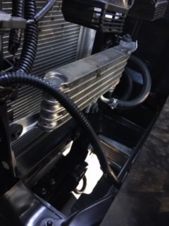

    Nope. I did a drain & fill and then put it into temp check mode as per this thread. It's not hard, just mundane.
    https://www.tacomaworld.com/threads/how-to-drain-refill-automatic-transmission.63851/
    Then I made sure to get it to a temp where I needed the cooler to work (because it then opens additional cooling area in it) and topped it off again.
    I will say it made a HUGE difference in towing 4k+truck loaded in the ADK mountains. Probably a 30-40° swing and I pretty much never hit 200° max
    Skydvrr and RobP62[QUOTED] like this.
  13. Jun 17, 2020 at 6:39 AM
    #433
    RobP62
    RobP62 NVR20LD
    Jun 4, 2017
    #220718
    41,519
    Rob
    Street, Md.
    TTC Member #0125
    This is a perfect example of how things not acting right aren't just related to towing. The transmission fluid rests in a pan just like the engine oil. If you are driving on extreme angles, especially in extreme heat, things could go south real quick. Sadly, there's no way for you to check the fluid in the transmission easily and unlike engine oil, extreme heat will damage it quicker than engine oil.

  14. Jun 17, 2020 at 6:41 AM
    #434
    RobP62
    RobP62 NVR20LD
    Jun 4, 2017
    #220718
    41,519
    Rob
    Street, Md.
    TTC Member #0125
    Nice, I may consider adding one too. 30 - 40 degrees is huge when it comes to tranny fluid temps. So this additional cooler only opens up at a certain temp? How is the bypass plumbed in?

    From the tru-cool site:.
    "Automatic transmission fluid (ATF) is more viscous when it’s colder. Tru-Cool Low Pressure Drop (LPD) Transmission coolers have a unique cold weather passive bypass that allows the thicker ATF to flow more efficiently through the cooler at the top of the system."
    Plus I pretty much took brand recommendation from @gearcruncher after a discussion with him.
    I need to add the additive he suggests at my next self-flush....which I'm long due for.

  16. Jun 17, 2020 at 6:52 AM
    #436
    rblalliance
    rblalliance let the wookie win
    Apr 24, 2017
    #217208
    2,739
    08 TRD OR DCSB 4X4
    Looks good! Nice and clean install :hattip:
    pmstoy10[QUOTED] likes this.
