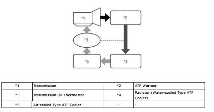

  8. Jun 21, 2020 at 6:46 PM
    #628
    splitbolt
    splitbolt Voodoo Witch Doctor
    Mar 7, 2010
    #32761
    7,858
    NW Arkansas
    2016 TRD OFFROAD DCSB MGM
    So it was either 4 or 5; not 4 and 5.

  9. Jun 21, 2020 at 6:50 PM
    #629
    Jeff Lange
    Jeff Lange Well-Known Member
    May 19, 2015
    #155616
    2,267
    Calgary, Canada
    '86 AE86, '05 NCP13, '11 GSE21
    No, it was 4 and 5.
    Jeff
