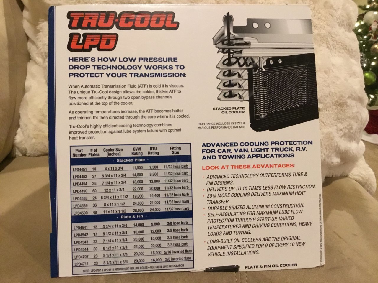

    TruCool LPD 4589 or 4590 by Long Manufacturing. Easily fits in the space of the OEM cooler.
    About $100.00

    So is this aftermarket cooler more efficient than the one that comes from the factory. Would it be a worthwhile swap?
    Living in AZ and about to start towing in 110* plus weather has me a bit concerned the auxiliary factory cooler may not be enough for a 5000# trailer.
    Bought an ultragauge to monitor temps, so I guess I will see how it goes.
