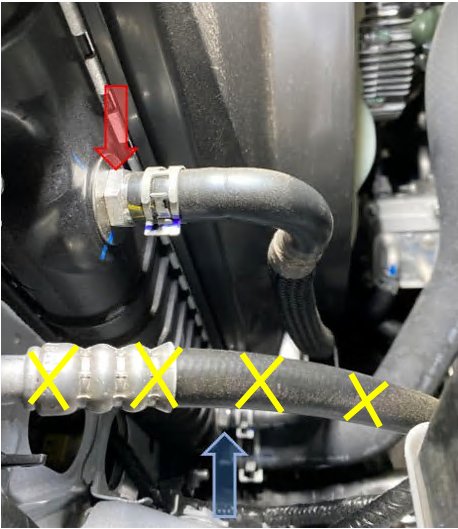

    Just to add to this. You also need a quart of ATF because you have make up for the difference due to the new cooler. When i did mine we used about 3/4 of the quart for my cooler.

    Definitely! I would also add that you can use any type of locking pliers, aka vice grips, to pinch all rubber lines to keep fluid from running out of them. A catch like a old coffee can, or milk jug or whatever too to catch whatever comes out of the radiator ATF cooler.

    Thanks, I will study up. I will only be towing around two thousand lbs. but I live in Oklahoma and tow in Colorado and South Dakota. It gets really hot here in July and August.
