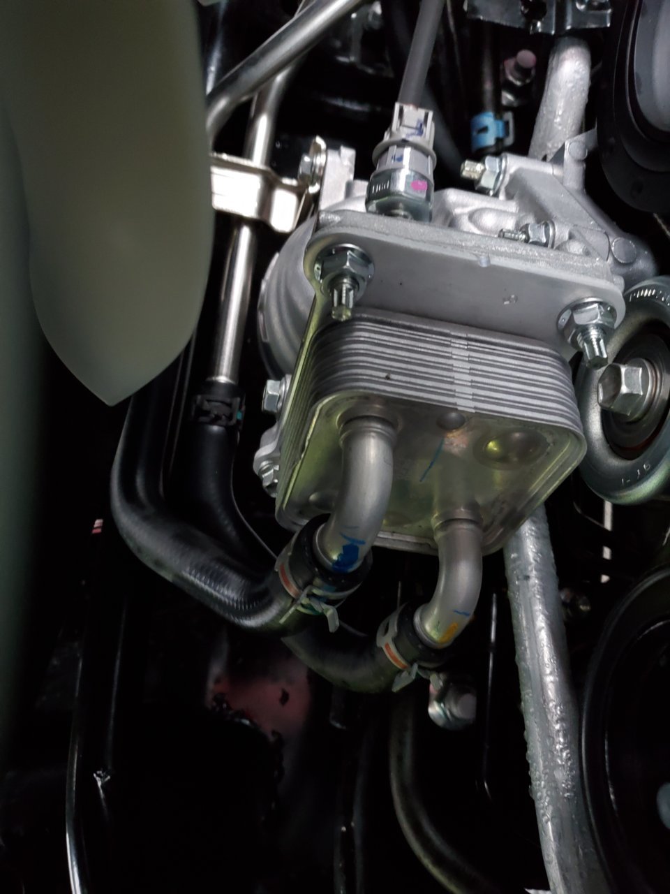

    Just picked up my 2020 SR5 and no trans cooler. Need to take a look tomorrow for the trans lines so I can properly install an aftermarket one.
    What is this part and is it transmission related.
  5. Jul 22, 2020 at 6:40 PM
    #765
    Skydvrr
    Skydvrr IG: @kalopsianick
    Sep 13, 2017
    #229889
    12,652
    Nick
    YMH
    Black '17 OR
    Engine oil cooler

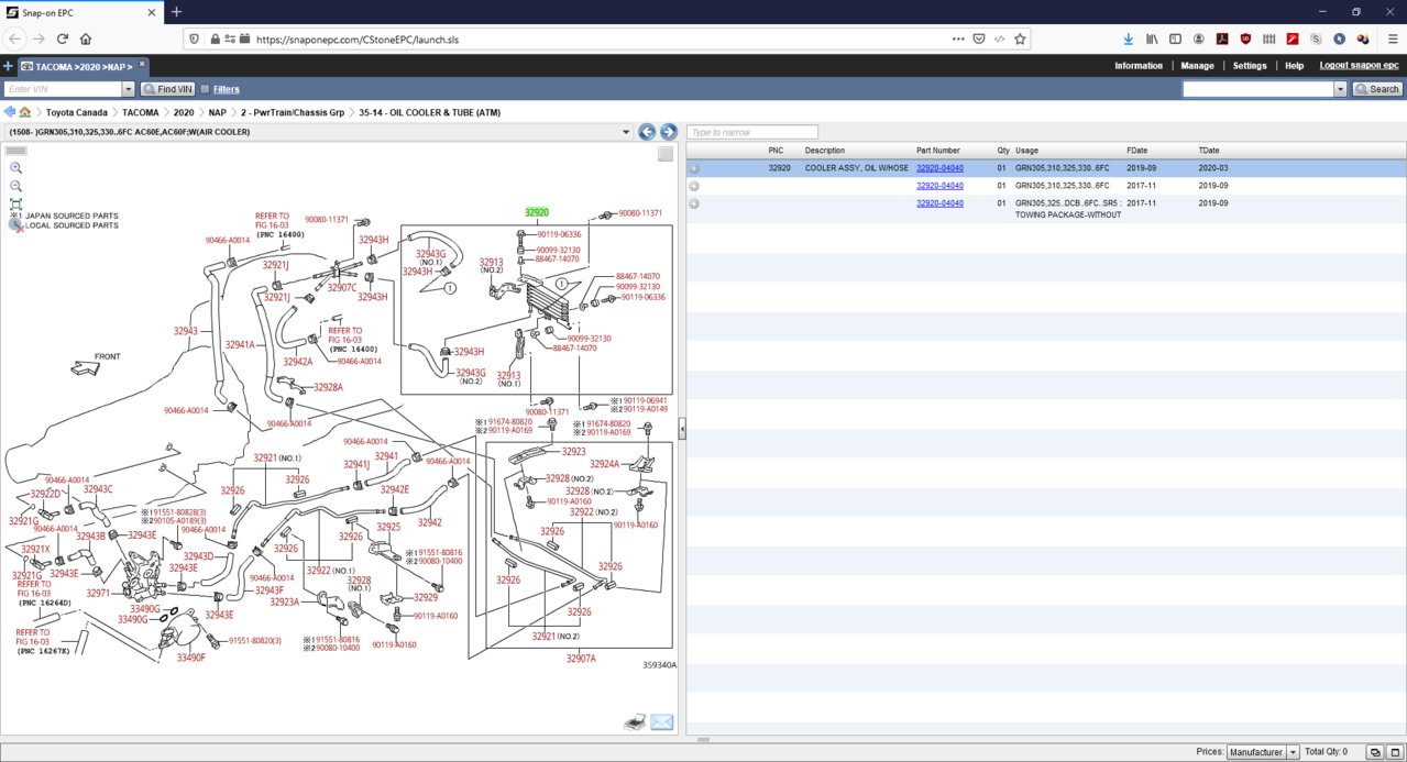

    06/2020 Baja Factory TRDOR here and no cooler.
    My vin specific parts catalogue shows I should have one per the parts counter at my dealer. They’re looking into it and will get back to me.

    The parts catalog doesn't list it for any trucks that were manufactured after 03/2020. Toyota doesn't really have VIN-specific parts catalogs. They have a VIN filter that narrows down options from the catalog using the VIN-specific data, but that doesn't make parts that aren't listed otherwise appear.

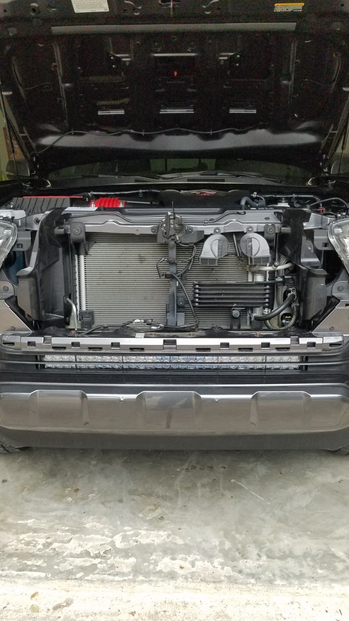

    Just finished the install of a B&M 70264 external transmission cooler on my 2020 SR5. It sucks that a truck with a tow package doesn't come with a aux trans cooler.
    I tow a camper in the mountains so I'm not taking any chances.
    The install was pretty easy, the hardest part was locating the best install location.
    I was able to plug all of the lines so I only lost a few drops of fluid and I filled the new cooler with trans fluid. The only transmission fluid lost was in the lines, so no need to top off the transmission fluid.
    The new cooler is bigger than the stock cooler that used to be installed, so it should do a good job keeping things cool.
    IMG_20200901_134105497.jpg IMG_20200901_150512332.jpg IMG_20200901_150611677.jpg
    Looking down from the top you can see the cooler has plenty of space front and back.

    Nice job! Looks good and clean install.
