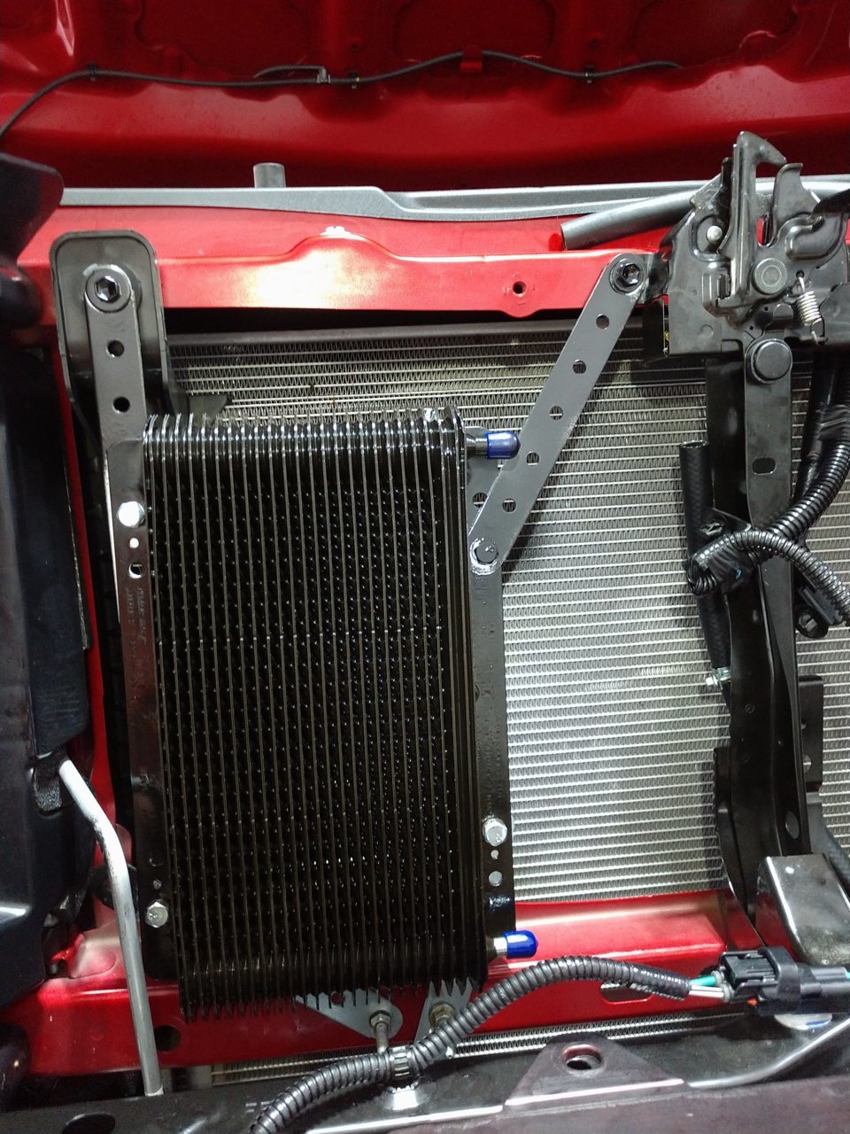

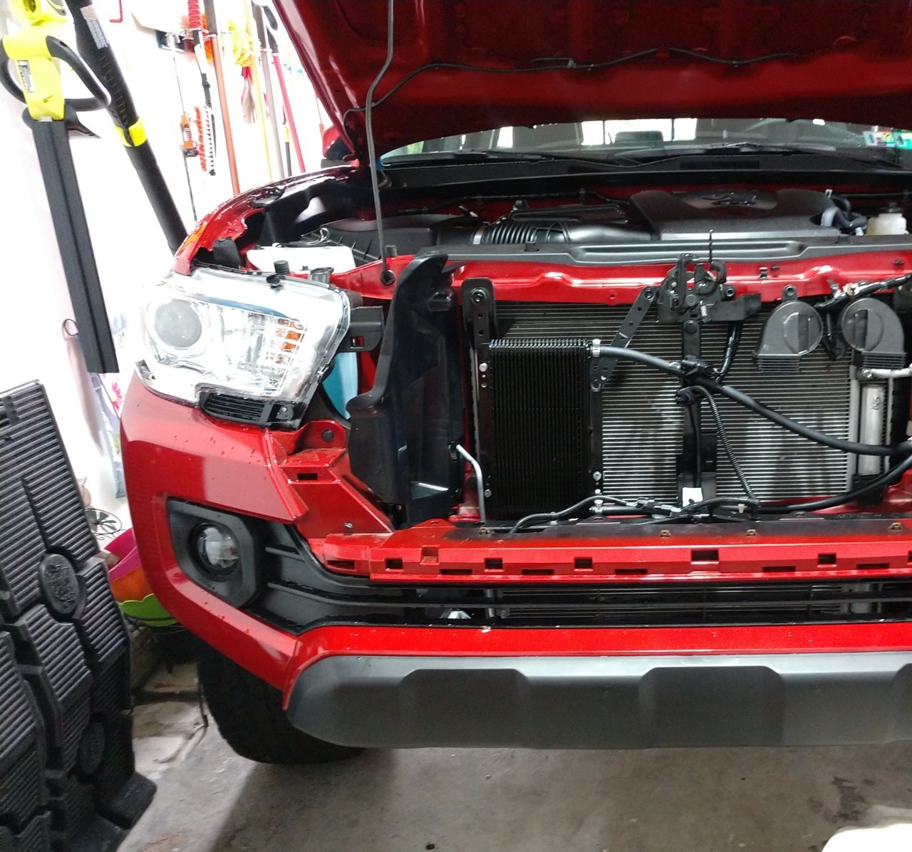

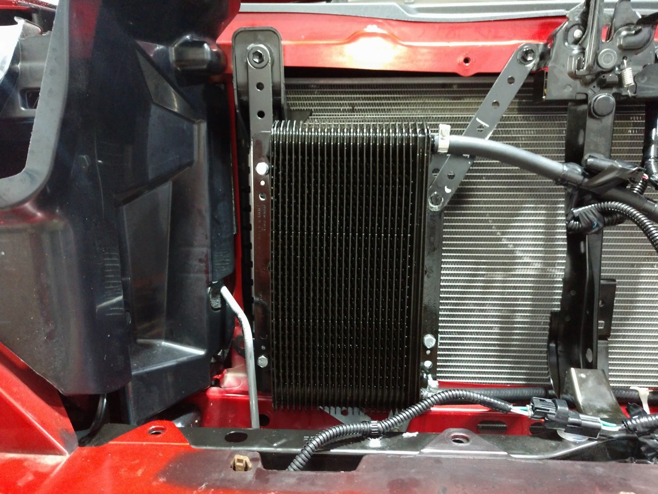

    Thanks! It took about 4 hours to install, the longest part was figuring out where to put it.
    I took my time and didn't want to screw anything up, transmissions are expensive! Lol.

    Would you be able to show where you hooked up the new lines to the truck? Even if it's just through the grille?

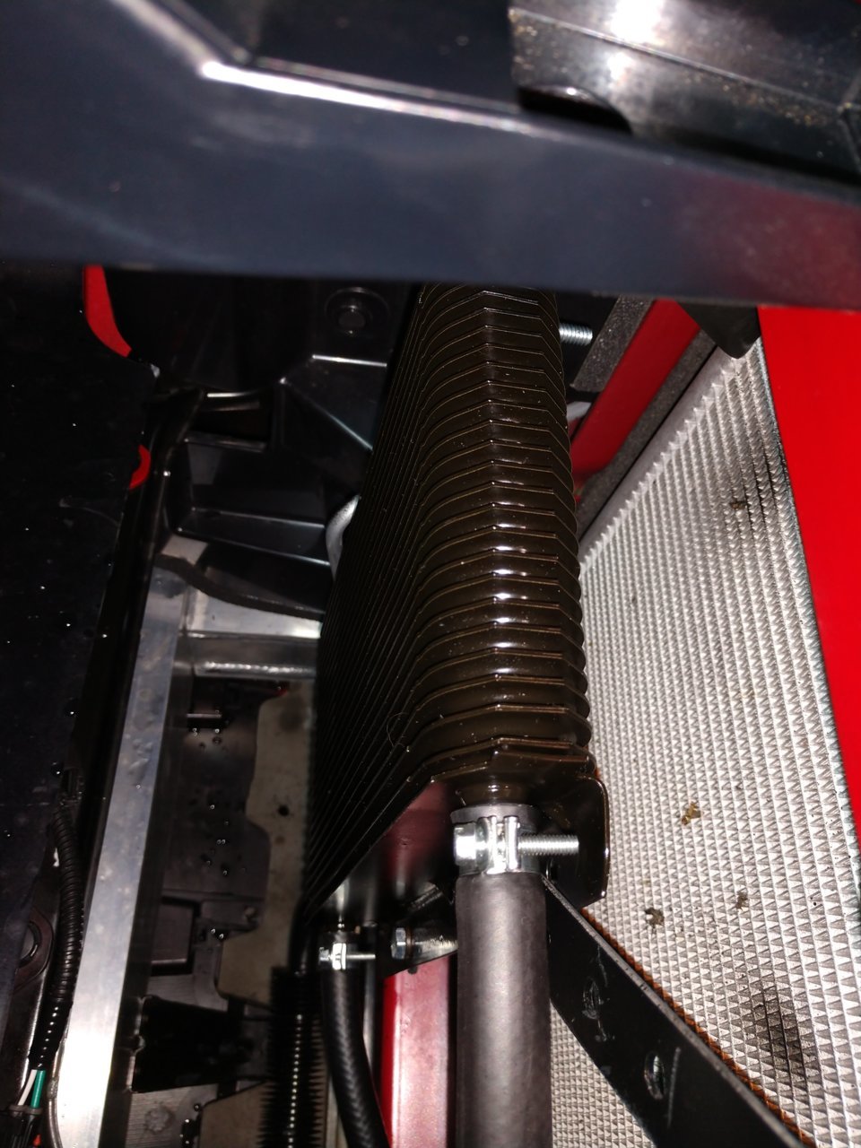

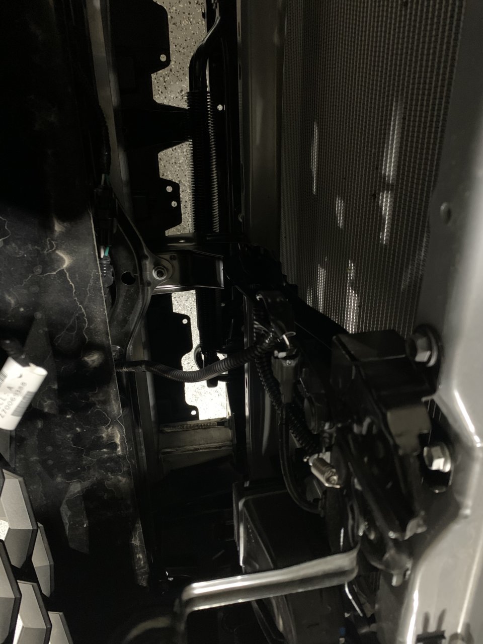

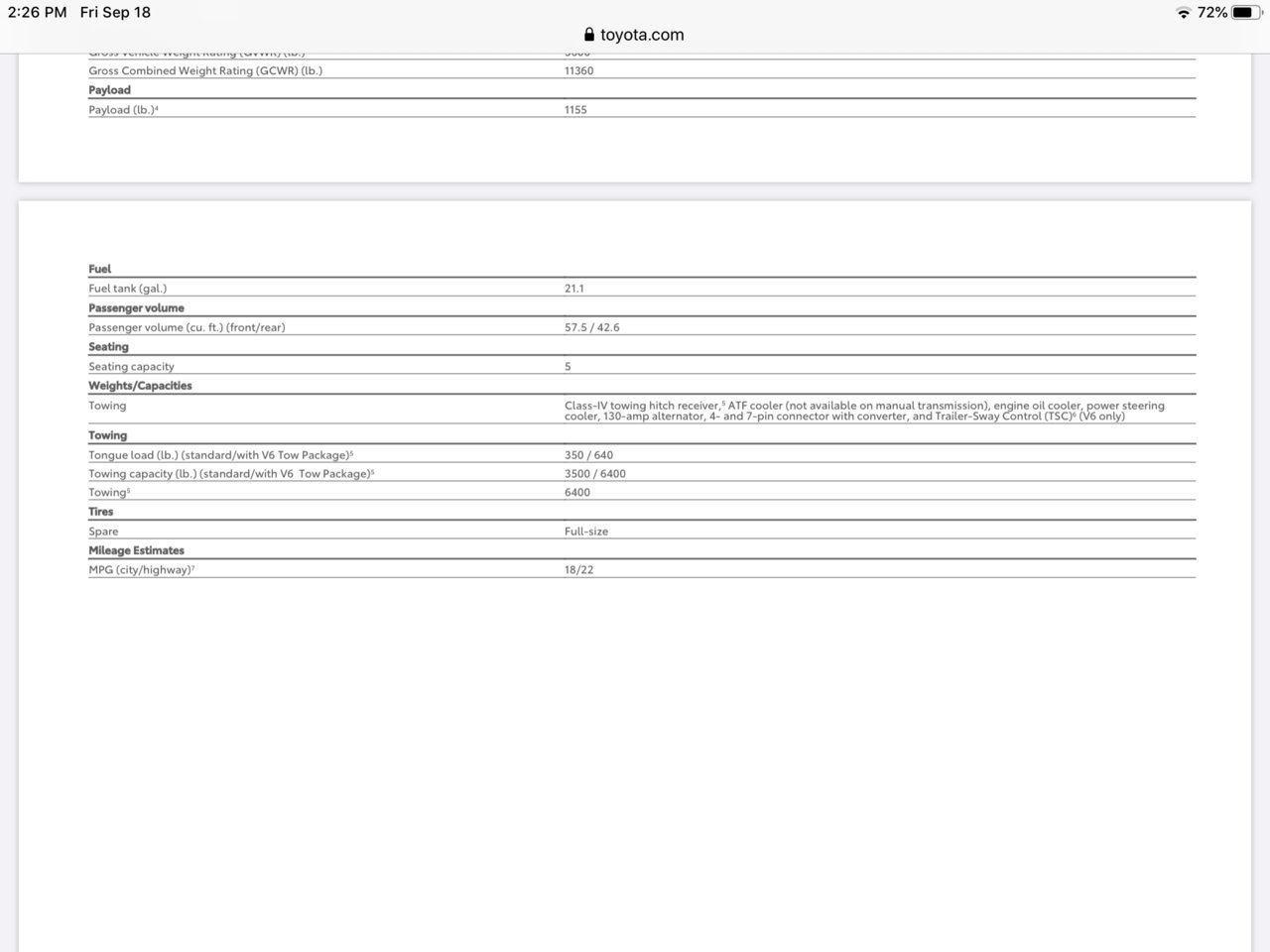

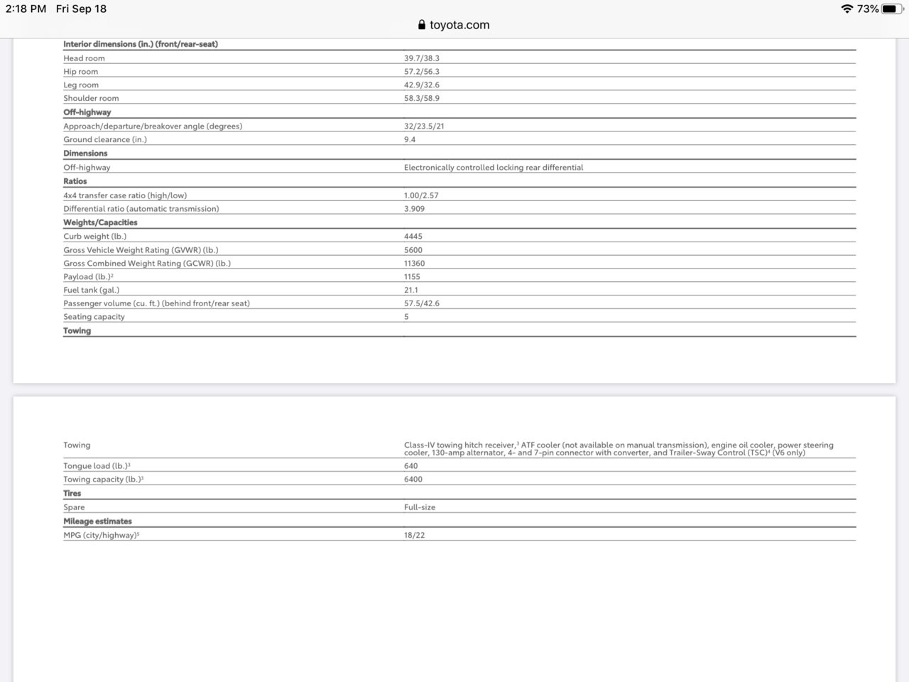

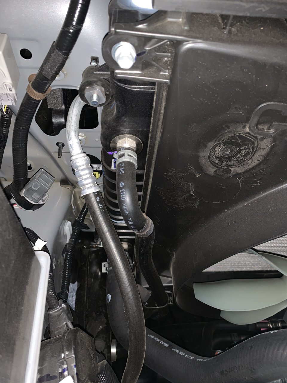

    It says a off road has the cooler according to their website.
    This is a 2020 build.
    27FBF214-E6ED-43CC-89D0-8D68EE135D07.jpgThis is a 2021 build.EA00C3E3-78EA-44E9-B5FA-C5D1F7354313.jpg

    I just tapped into the cool return line coming out of the radiator, routed to the B&M cooler and then back to the transmission.
