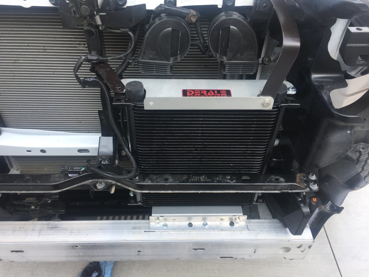

    2,466
    5ADF708C-5F50-430B-9CEF-0CCFDB6A447A.jpg Mine was “missing” it , now I have a extra 26oz and a spal cooling fan 0C0401D9-C39B-4429-A1B9-3094796CFA5F.jpg

    2020 Cement DCSB OffRoad Premium
    How did you wire up the fan? Is it automatic in that it fires up at a certain temp? Looks like an awesome set up.

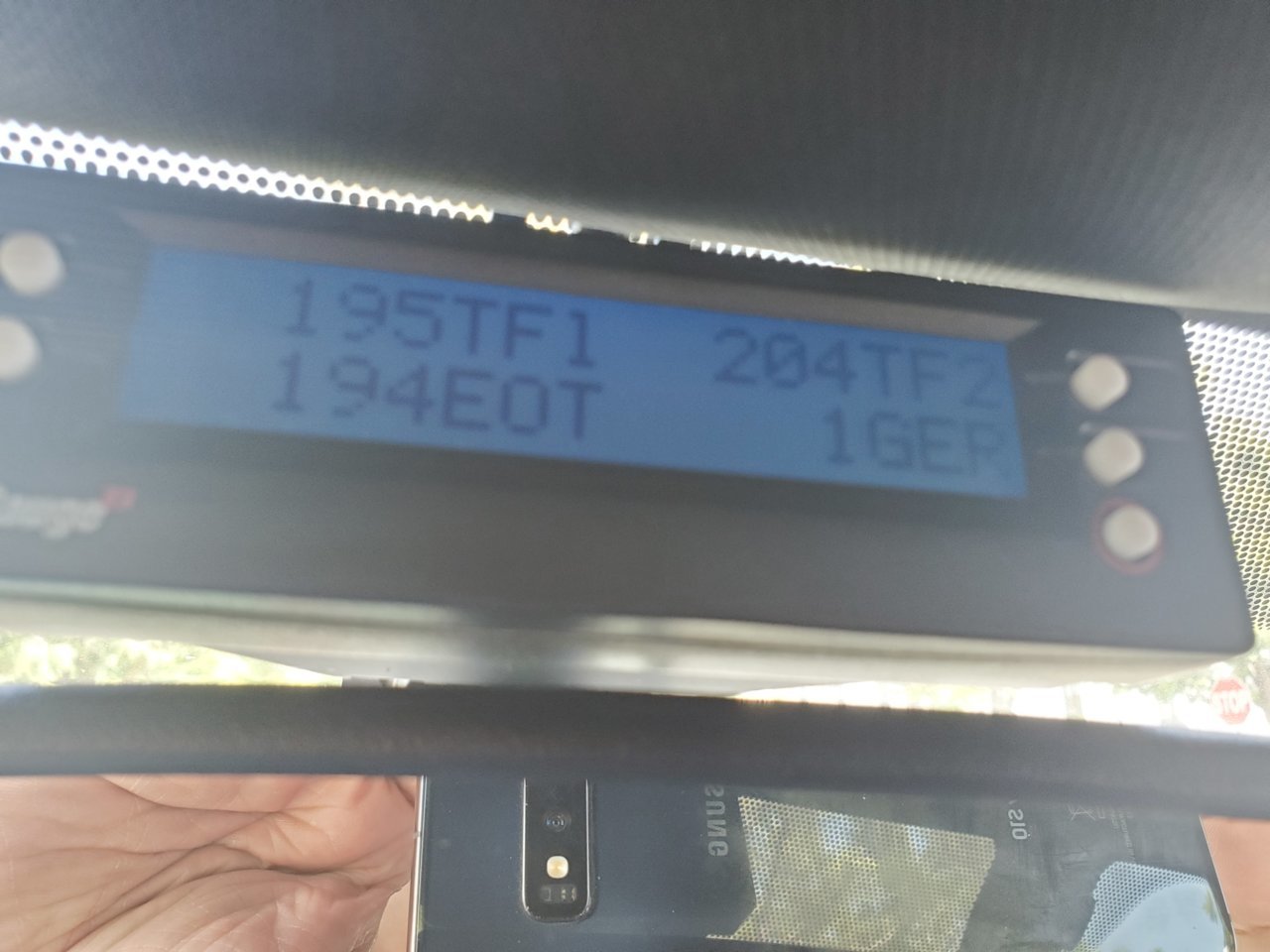

    Morimoto XB LED Head & Fog Lights, Cali Raised Stealth Light bar, OEM Roof Rack, Homelink Compass Mirror, Power Tailgate Lock, LED bed lights, MESO mirrors, gashole, switch panel & Stage 2 tails, PRO grille. Where's the mall?
    @gearcruncher I read your thread on expected transmission temperatures, it was very informative.
    So what should we be expecting a Scangauge to report the transmission temperatures to be? I note that my SG reports for TF1 and TF2 the temperature with regular street driving and not towing anything is around 190 (ish) degrees F. I assume TF2 is the torque converter since at idle the temperature jumps to 220 degrees F or so.
    TIA! Would the folks without a secondary cooler expect higher temperatures?

    Thats a little too warm for my liking .
    Yes, we gotta boil that condensation out of the fluid @ 212 farenheight and the demulsifiers are in new fluid to assist with removing that water .
    TF1 measures the fluid in the pan
    TF2 measures the fluid at the torque converter .
    The hottest spot in a transmission is the torque converter , therefore transmission fluid in the torque conveter is sent directly to the cooling system to be cooled ( TF2 )
    Transmission fluid from the cooling system then returns the fluid to the pan ( TF1)
    Whats strange here .... when you idle your truck , the fluid in your converter should cool quickly becuase its no longer under any load . The fluid should not increase in temperature at idle . Even though you are no longer moving and there is little to no air flow through your radiator , the internal radiator transmission cooler should drop the temperature of the transmission to engine temperature .
    Folks without a secondary aftercooler will see higher temps , however , this does depend on outside temp , towing etc etc

    2,466
    I have it wired to a relay/switch , under normal driving the fan really won’t need to be on . While in traffic, towing or off-roading it will always be on . I have a scan gauge with the pan and converter temp read out and will base it off that .
