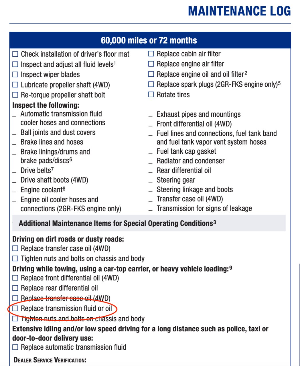

    In looking at my 2020's Maintenance Log I found a "replace transmission fluid or oil" entry at 60,000 miles if towing, etc.
