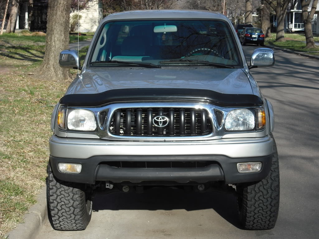

    I had the same problem as you. When I bought my truck it was missing the "lower headlight filler" on one side. I bought one off Ebay for $10 and went to the auto parts store (NAPA, I think) and had them mix me an aerosol can of my factory paint color for less than $10. Then just spray it with a Dupli-Color or similar clear coat aerosol spray and you won't be able to tell the difference. I wouldn't try to paint a fender or hood with it, but the part is small enough that you can't tell the difference from factory.
    Here's a pic, you tell me which side isn't the factory painted one...
  7. May 7, 2009 at 8:03 AM
    higherlux
    higherlux Well-Known Member
    Dec 5, 2008
    #11307
    6,929
    Blake
    middle of S.C.
    1998 tacoma 2.7l 4wd/1986 POS
    Mall crawler status
    pass side is factory
