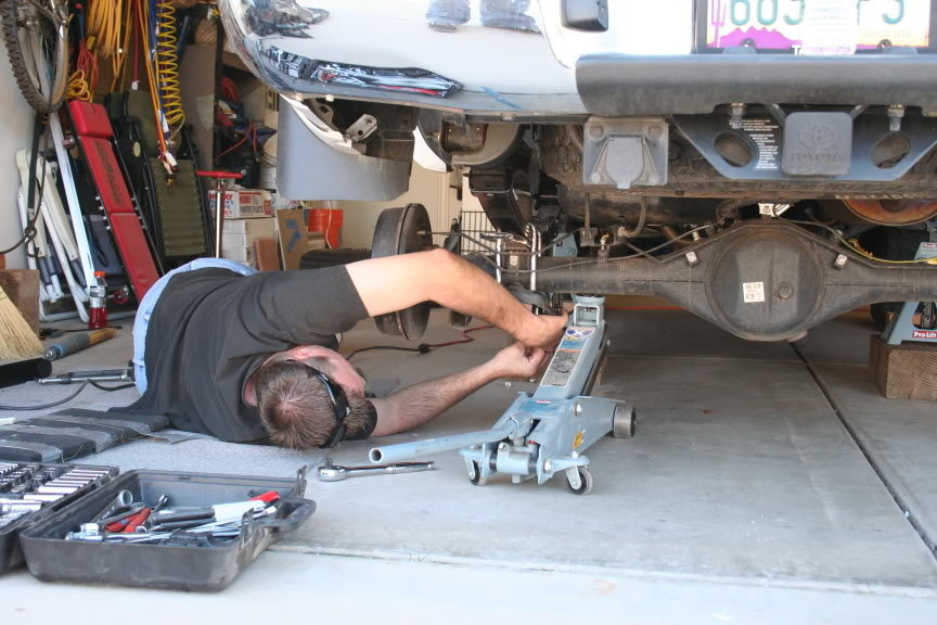

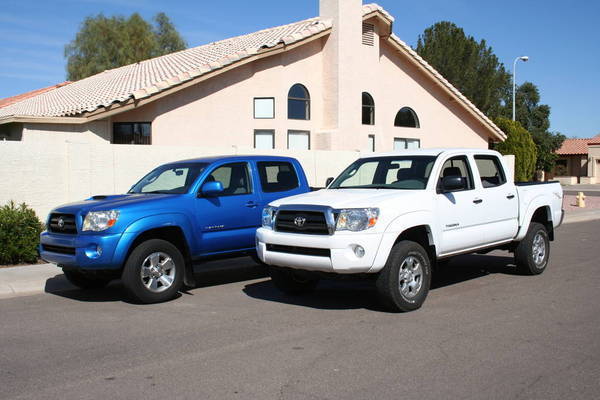

    With everyone’s help, we completely installed my Front & Rear suspension lift & UCA on my 08 Tacoma, TRD, 4X4. Those in attendance: Chris 4X4, Brain R, PackerfanXD, & Tightshirts. We had a SEAMLESS install that took just over 5 ½ hours. It was a casual pace, moderate BS’ing, & all around good time. Thanks to ALL! Tightshirts will be posting a kickass HD 1080P video & pics shortly, with a detailed write-up.

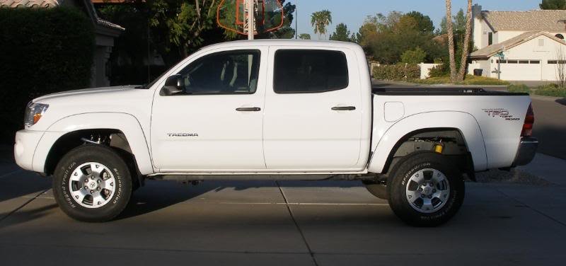

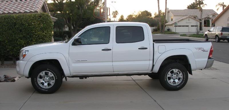

    I achieved a 3 1/8” increase in front & 2 ¼ in back (in addition to the rear TSB I had done last week).
    The average person probably would not notice a difference in the ride. It has a little more of a "firm" feel to it, definatley not "stiff". You can feel the smaller bumps a little more, but the bigger bumps smoooothlikebutter.
