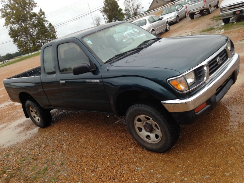

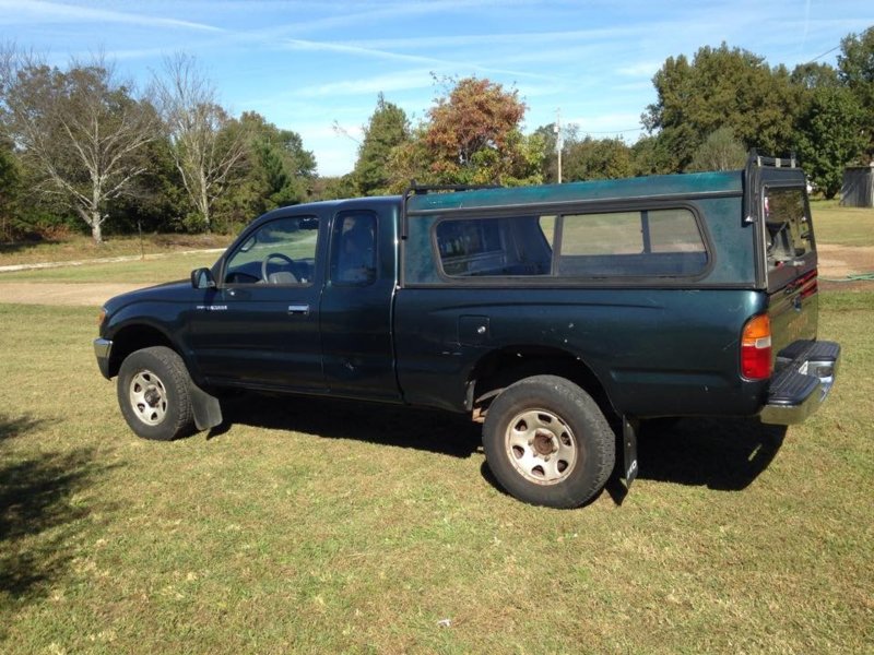

    The year is 2014 in the month of, eh let's just say it's May. I am 23 years old working at an Independent Automotive Repair shop in Oxford, Mississippi.(Ole Miss! Go Rebels!) We mostly only did European stuff, a lot of VW, audi, land rover, BMW, blah blah blah. One of the regulars brings in his wife's truck which was the first vehicle she ever bought brand new but we had never seen it. A lovely green 1997 Toyota Tacoma extended cab 4x4 with the 2.7 4 cylinder and just a little dent behind the driver's door. The poor old girl had a blown head gasket at 248k miles, the owner needed a quote to fix her up but were already looking at new cars and were not sure if they would fix her or not. It actually wasn't very well maintained and needed some other stuff which we let them know about as well and quoted them the repair for the head gasket. They him-hawed back and forth about it for a minute and decided they would sell it but not sure for how much, I at that time offered them $700 bucks cash and I would cover any charges from the shop for the estimates. They got back to me a few days later with a counter offer of $1100, it had newer tires so I went ahead with it.
    I was the owner of my first 4x4 truck! *cue dixie horn music* Yee-haw!upload_2016-12-6_21-11-22.jpg
    The truck just sat on our lot for about a month while I saved up some money, but eventually I pulled in it and tore it apart and fixed it, only had $400 or so in parts to get it all running good. So there I was driving my 97 Tacoma 4x4 that I had about $1500 total invested, already having neighbors and random people at gas stations offering to buy it so I knew I bought the right truck!
    The previous owner came by after about a month of me having it fixed to show off their new car, a 2012 Subaru Outback of all things, which was funny to me because my fiance at the time had a 2003 Subaru Outback that I bought for $400 and fixed up kind of the same way I did the Tacoma. You also don't see many Subaru's in the south, you don't really need an AWD vehicle for anything. At that time they offered me the old "topper" for the bed for free just come get it out of their yard. You know that's a good price. "If it's free, it's for me!"

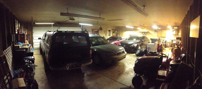

    So Yeah, it happened I moved to Ohio and was staying with my mom until we found a place, November 2014. I started work about 3 days after getting there, and the first or second week and this happens.

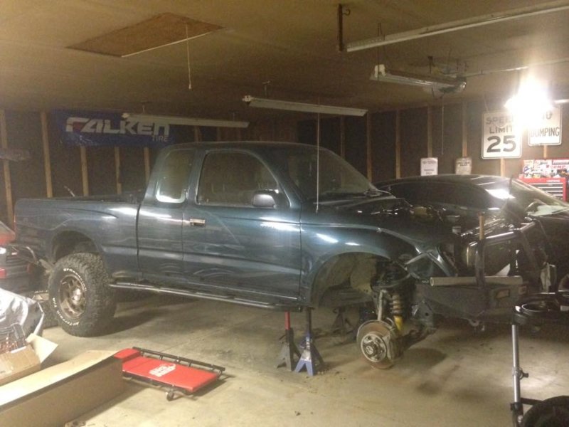

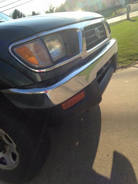

    One day I am over visiting my mom at her house and she was running a little late leaving for work, in a bit of a hurry she "barely bumped" the truck, her 2010 Buick doesn't have a scratch but the Taco had a fat lip.

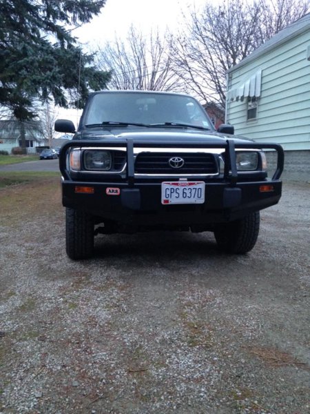

    No big deal, life goes on. I actually bought new bumper brackets on ebay and it looked great after I fixed it, but it got me to thinking what if something hit it like for real?
    WE'LL FIX THAT!
    This was my first major purchase for my truck and I had literally no intentions of it ever being an off road toy, the bumper was purely for protection and for looks of course! :D
    Funny story though it didn't quite fit right and instructions were clear in saying don't grind anything to make it fit. So I emailed ARB and two days later they got back to me, well by then I had already ground on stuff and made it fit.
    :anonymous:
    At least I took pictures of what I did, I didn't hurt any structural integrity of it and I knew that. The guy from service was cool about it, wanted to send me something for my time and effort and I'm thinking yeah cool give me your stupid hat or t-shirt whatever.

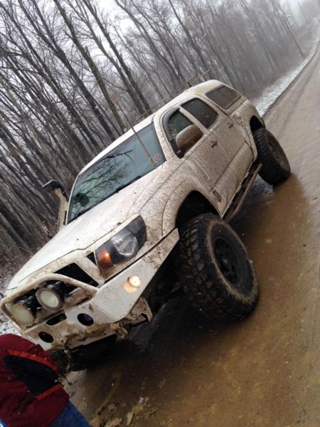

    My next Mods were my new shoes 265/75R16 BFG A/T and the TRD bronze wheels, CB radio and antennae, CBI ditch light bracket used for my antennae mount. 2.5" OME lift kit with replacement rear leaf pack from wheelers off road. I was pleased how it turned out. Perfect for the weekend warrior it was becoming, looking back I'd have gone M/T tires but that's because my commute is very short to work. Other notable mods here will be the D-ring shackles and of course my trademark now to all my local friends "Old Taco" custom plates! Also no pictures of the install but right around this same time I added a lock-rite noslip style lunchbox locker. Replaced the rear wheel seals and bearings(the kind that press on the axle, stupid.) and the rear brake drums and shoes were also replaced.
    Did some light exploring alone trying to find places close by that I could ride, not too much luck but I had a little. Took along a local off road enthusiast who drove an Xterra. I didn't like going alone and didn't do it too often but didn't take long before I knew I needed a winch. This picture just happens to have it installed. Oh and the ARB bumper is heavy, the winch is heavy, them bolted together is extra heavy. My little tail picking it up and installing alone was priceless.

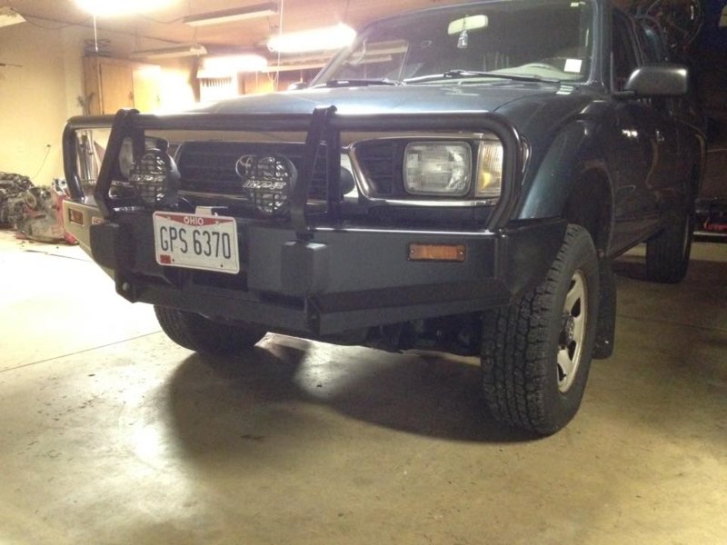

    All-pro slider group buy, I also opted for the rear bumper.
    No sliders on yet but I had to explore! You may also notice I got rid of the rings on my wheels, they are great at holding mud and that's about all.

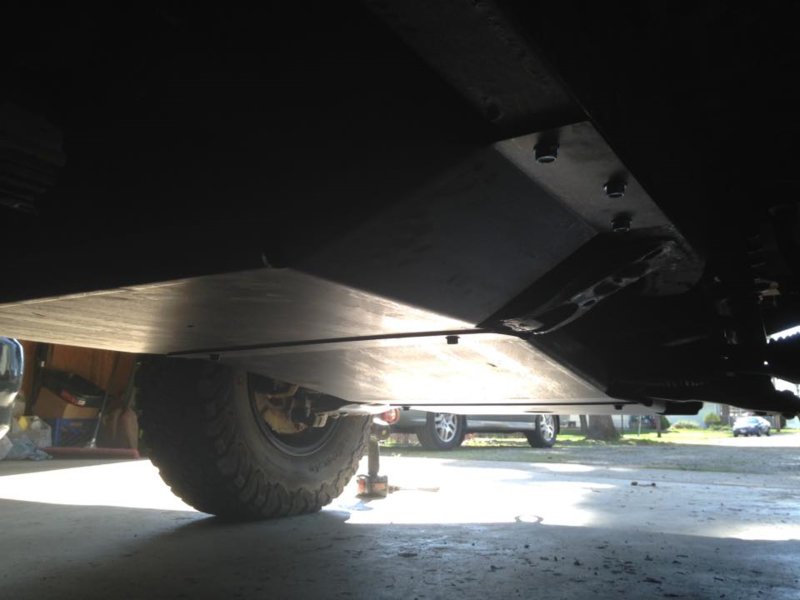

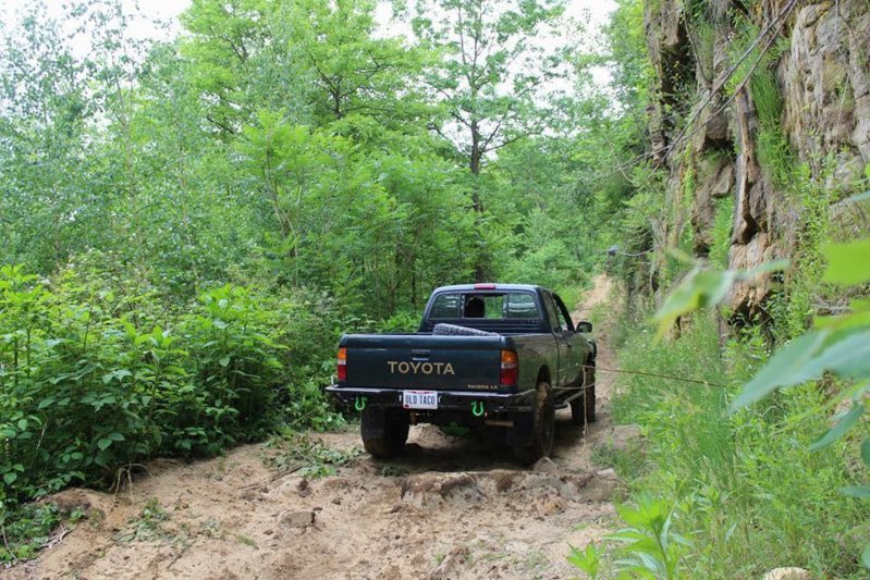

    RAT 3/16" steel skid plates 3 piece set test fit, covers everything back to the transfer case. Then of course I had to put my personal touch on them with my daughter's help.
    I also had the sliders welded on by a friend in my local off road group, no pictures of that, I remember taking one with his belly hanging out while laying under my truck welding. I guess your spared of that one because I can't find it. Darn.

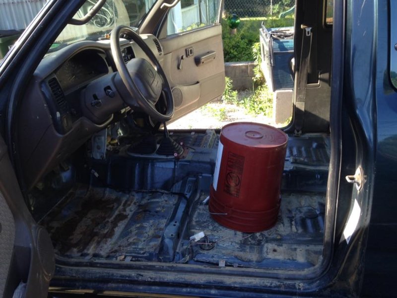

    This was the first time I experienced water coming into the cab from under the door. They laugh about me being on the CB saying "Uhh, TOM HELP! HURRY!" Lol anyway my carpet never did smell the same after this so I removed it and truck bed lined the floor in the cab. I like how it turned out.
    Can't find the picture of after the bed liner but this was during the interior stripping and me being funny saying I added a bucket seat.

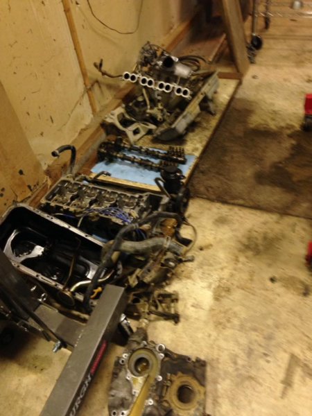

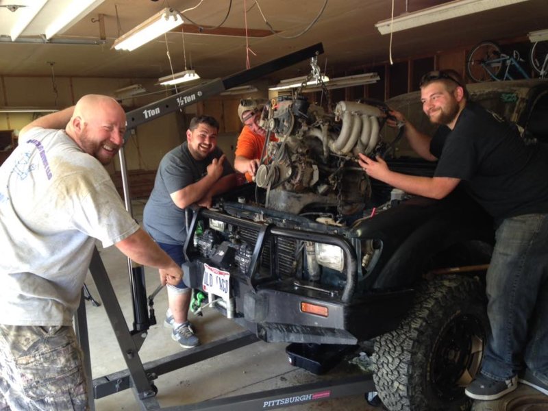

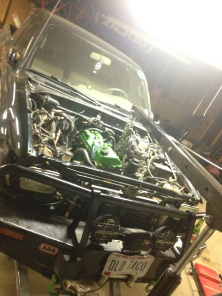

    So yes it was my fault, I was off-road with one friend and I was testing the rev limit in a mud hole which doesn't seem to actually have a limit. Lol anyways I started to hear a little knocking at high rpm and we decided it was time to go. Got out of the trails and on the road about 10 miles taking her easy and the knocking got bad so I shut her down. Funny story It was like two hours away from home. DOH! Thank god for good friends and you should never off road alone, he drives a v8 grand cherokee and tow strapped me to the nearest town, and then to the next nearest bigger town, and then said hell let's just keep going. So he tow strapped me back home, lol it was over 100 miles. CB came in quite handy but my tow bill was cheap.
    The OLD TACO sat idle for a while, I wasn't sure on what direction I would be going. Motor swaps came into question, full rebuild, what do I do? Either way a lot of research and money was going to be needed so I took my time on it. About a month in I actually decided just to rebuild my old 2.7 because I am a technician not a fabricator. It's all fine and dandy to say LS swap it or cummins swap it but there is so much custom work that goes into those things and I just needed a motor. I decided to rebuild my own motor, after the tear down I found the only problem was a spun rod bearing on cylinder number 1. well of course it had chewed up the crank too. So just throw in a set of bearings and machine the crank. Right? Right... :rofl:
    This whole taco down thing actually took over some time, about 5 months give or take.

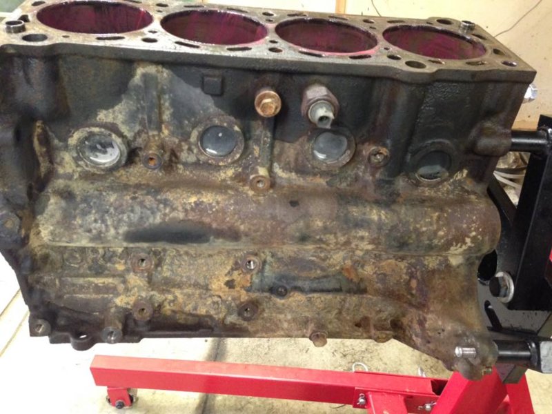

    Here is a picture of the truck in that condition, visual evidence of off road abuse, tree branch pinstripes everywhere, a little dent, those kinds of things, yes I am a horrible person. Got it.
    So a visit was paid to our friends over at LC Engineering, a couple thousand may or may not have been spent. The goal was a reliable built bottom end and not sure what the future held. I am actually a little displeased with how MY personal experience went with LCE but I had heard nothing but good things so that is where I went. I'm about 90% sure it was just a sales guy that screwed up my order but won't go into details, anyways...

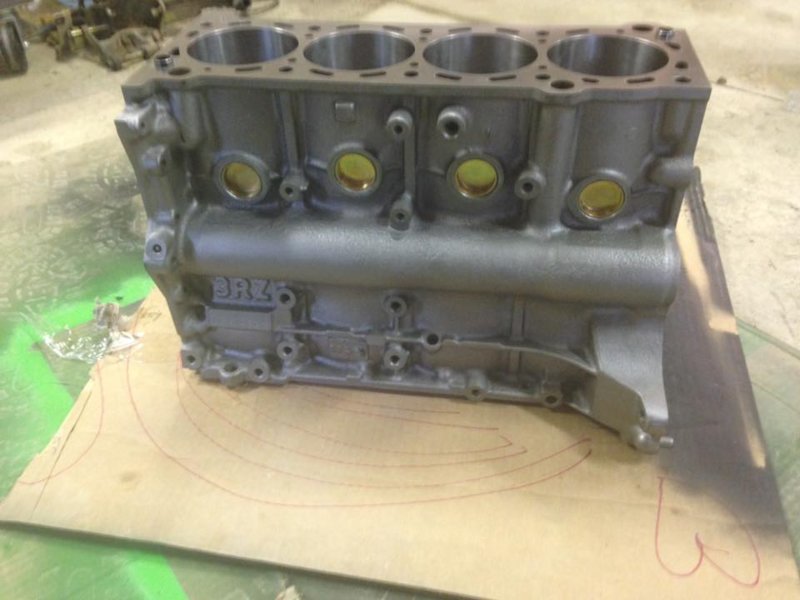

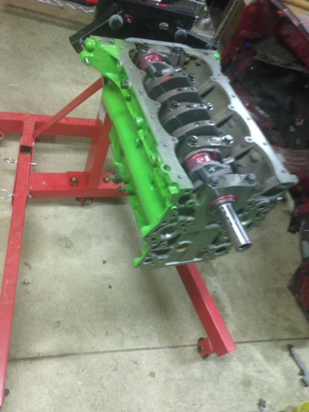

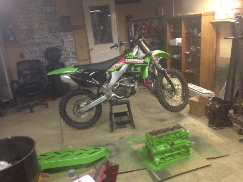

    I got a new crank, forged pistons, H-beam rods, all new bearings, underdrive light weight crank pulley, balance shaft delete kit, gasket kit(which was junk honestly), head stud kit, new timing chain, oil pump, water pump, etc, etc.
    Had my block at my machine shop for about a month but they did a good job for a good price.

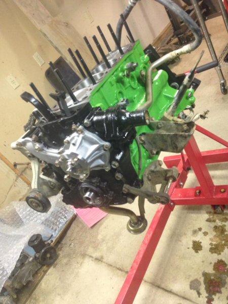

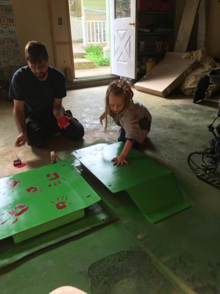

    It was pretty but I knew it wouldn't stay that way, BREAK OUT THE GREEN PAINT!
    Also randomly got a fuel tank skid plate from low range off road and was painting it too.
    Time to put her back together!

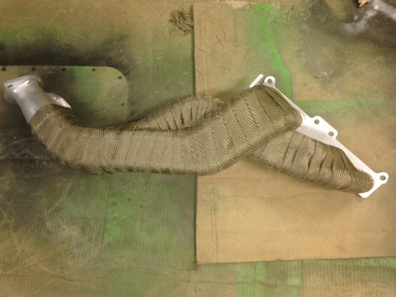

    Header from LCE as well.
    And after a long 5+ months the old taco had a motor sitting in her again.
    It's all back together, had a couple of hiccups after the rebuild. A small fuel leak and a small oil leak that were fixed quickly. Had a lot of stuff apart for a long time so that was kind of expected. I've only driven about 1000 miles on it since the rebuild but everything seems to be doing good.
    To be continued... just to keep things interesting...

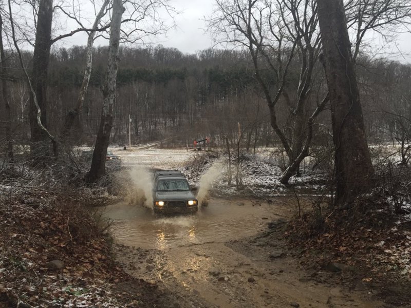

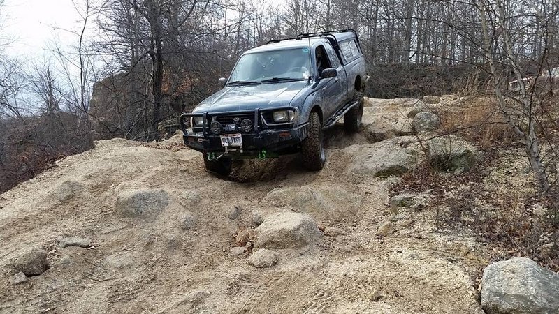

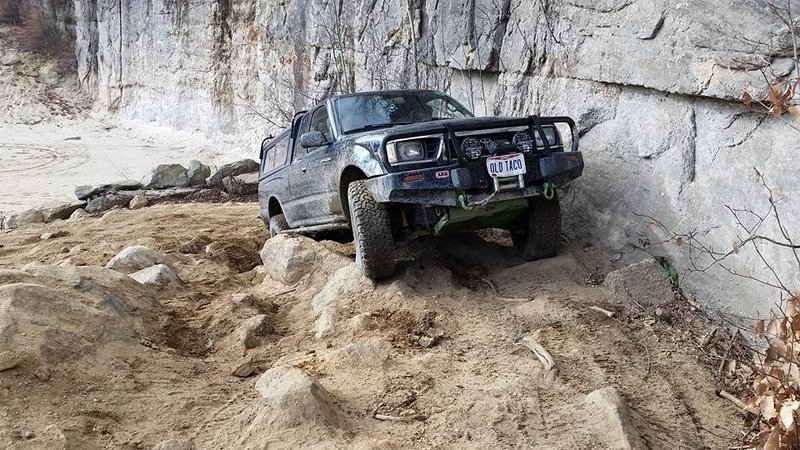

    Went on the first off road outing since the motor rebuild. It had been about 6 months so I was over due! I think the only different thing I did suspension wise was remove the sway bar when the motor was out and replaced my old leaky steering rack as well, I honestly could not tell a difference on highway driving or off road driving, maybe I got a little more flex but who knows. It was at Southington off road park in Northeast Ohio. We got a few good pictures but had a lot of fun.
