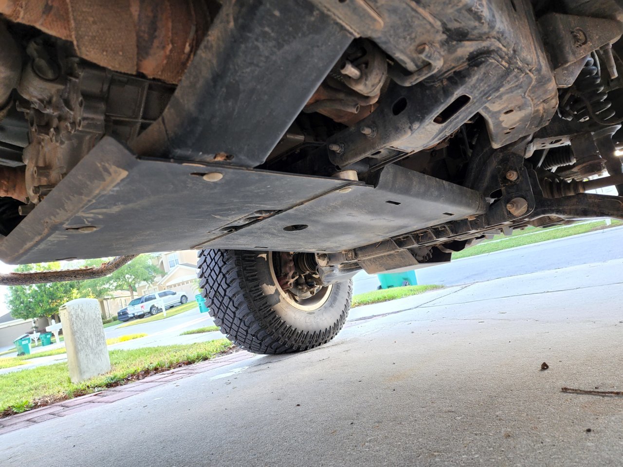

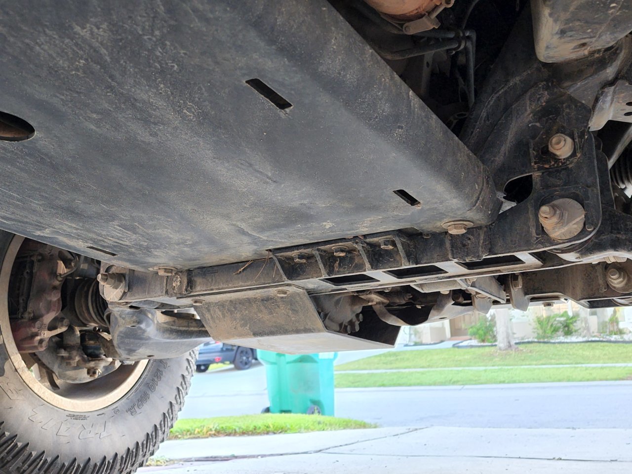

    I have an RC 6" lift and was told it was impossible to add trans and xfer case skid plates since they wouldn't bolt up. After taking some measurements I cut out some cardboard templates and tested it. I went out and bought the RCI trans and xfer case skid plates and made them work. Point is anything is possible if you have a welder and plasma cutter. Plasma cutters don't cost that much anymore. I used one from Amazon $250 and cut the skid plates like butter.
