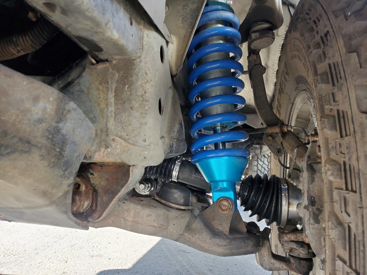

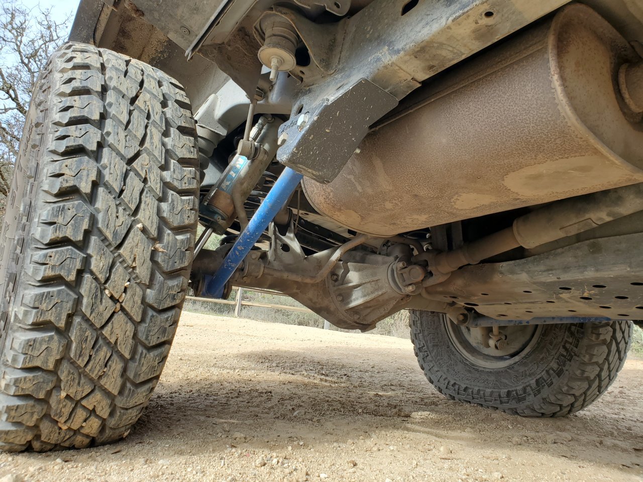

    Here is my personal opinion; just get Bilstein 5100 rears.
    Reason being, spending any more money on quality shocks in the rear is somewhat pointless without a rear shock relocation done. You're limited to an 8" traveling shock (9" - 10" if you go Bilstein short-body) so spending a lot of money for limited travel is a bit of a waste.
    Being a hypocrite I know, as I ran Fox 2.0 9" traveling shocks in the rear of my Tacoma, since I had Fox 2.5 up front.

    Bilsteins are so cheap, I bought a set for the Tacoma I had, as well as the 4Runner I have.
    I intended to use them as "back ups" for when my suspension needs servicing (my 4Runner has King front and rears).
    Get this though, I damaged one of my King rears so I uninstalled both rears and used my Bilsteins much sooner than expected.
    In the Tacoma's case, I only used the Bilsteins when I ran unloaded as the Fox were valved to be way too stiff and really only worked well with weight.
    If you want that "smoother ride", airing down will help significantly.

    Just don't go doing any "real" off roading, as in, don't go tucking in those wheels.
    Extended bump stops will prevent any fatal collapsing, as seen in the rear of my vehicles above.

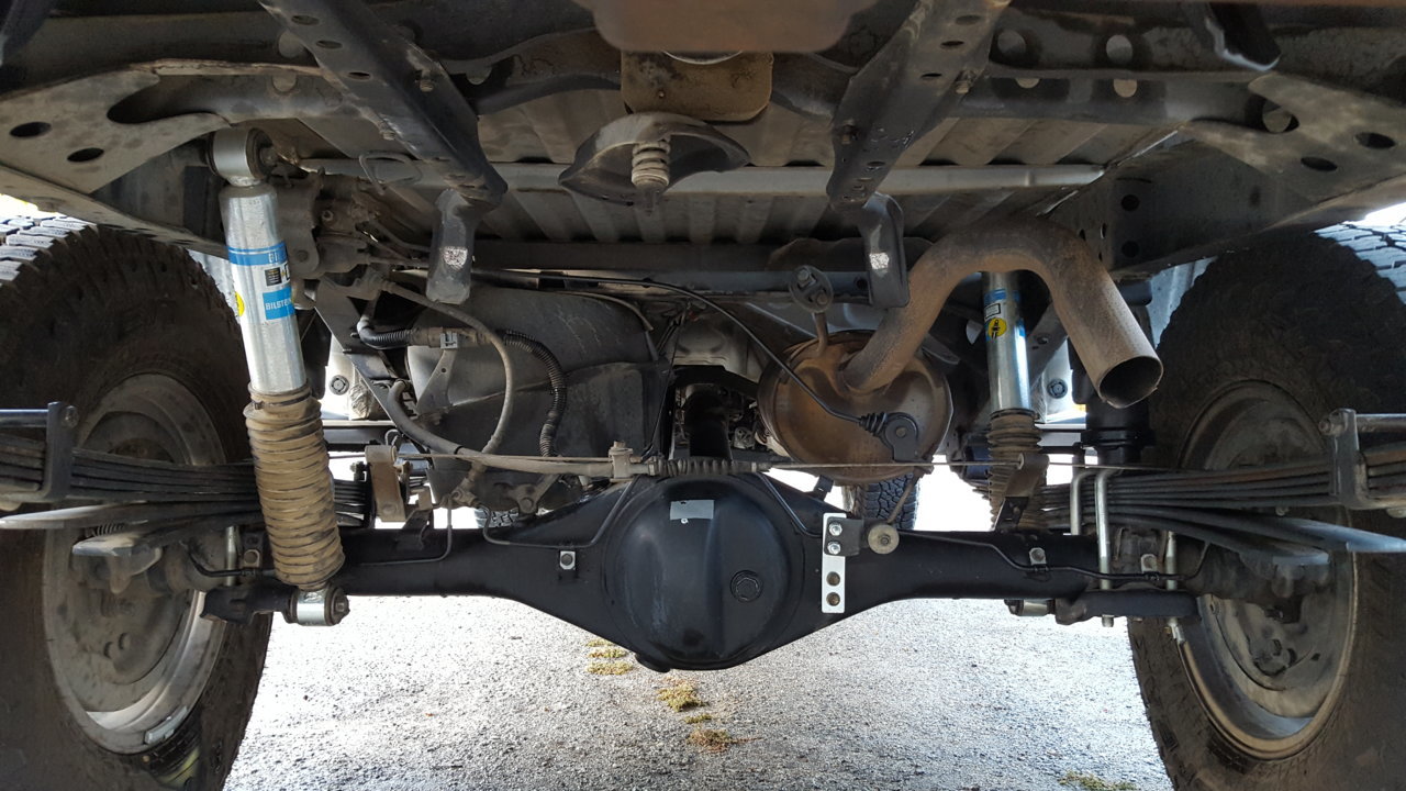

    Wait what? Really?
    I run ADS in front and 5100s in the rear on my 99, and they're actually too short (top out not bottom)
