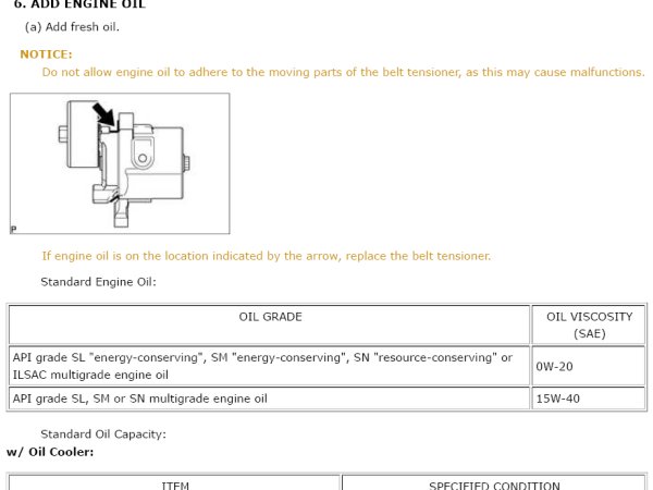

    Can you post a screenshot of the Mexico region owners manual?

    That and the FSM. Thx.

    I just attached the PDF extract from Toyota.mx at the bottom of this post. Toyota officially endorses 15W40 in ambient temps above 10F (which is still below freezing).
    Interestingly Toyota doesn't sell the 4-cyl Tacoma in Mexico. Buyers looking to save money would go for the Hilux.
