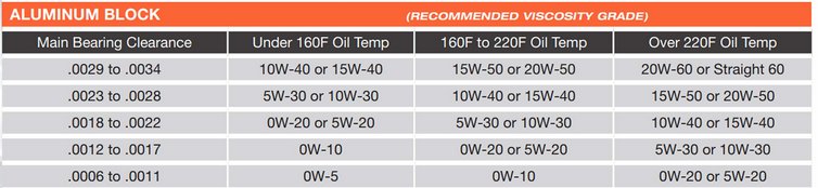

    Main Bearing Standard Oil Clearance 2GR-FKS:
    Chart developed by "Driven" oil brand, often cited:
    Do with this as you please...
    tacoma_ca likes this.

    Looks like 0w-40 will cover all ranges.
    Sounds good. I like that oil. If it is good for a turbo Audi, it is good enough for a Taco.
