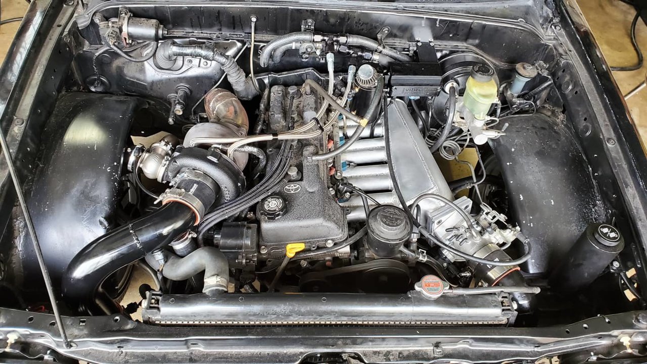

    PERFORMANCE Custom Turbo Setup FRONT SUSPENSION Drop Spindles by Aaron Carswell 01-04 Swaybar Endlinks Energy Suspension Endlink Bushings Cando Upper Control arms QA1 coilovers with 8" spring Custom 4 pot Brembo BBK Modified lower control arms with mjbfab qa1 mounting plates and Poly bushing sleeves REAR SUSPENSION Chasis Tech drop leafs QA1 adjustable shocks weld in drop notch Gas tank cross member bridge 3" angled blocks 2013 Double Cab Short Bed TRD Sport Eibach Pro Truck Shocks front and rear Lifted to the 3rd setting on the front shocks
    1995.5 xtra cab slammed and boosted Current Modificationsuserfield_edit_07fe54ebee8b007c278317657542c52de67684e3.gif PERFORMANCE
    Garret GT3576 Turbo
    Turbosmart 45mm wastegate
    Pink top injectors
    Walbro 190lph fuel pump
    Custom Intake and Exhaust Manifolds by the ShedKing out of Australia
    Custom Charge Piping made by myself
    Recirculated Turbosmart BOV
    Custom 3" Down Pipe and exhaust made by myself
    -4 AN Steel braided Oil Feed line
    -10 AN Steel Braided Oil Return Line
    -10 AN fitting welded to oil pan
    FRONT SUSPENSION
    Lower Ball Joint flip
    Custom Upper Control arms by KANE
    Custom Brembo 4 pot Big Brake Kit
    Custom modified lower balljoints to fix bumpsteer
    REAR SUSPENSION
    QA1 adjustable Shocks
    Weld in mini drop notch
    3" angled blocks
    WHEELS AND TIRES
    Enkei RPF1
    17x9 +35 front
    17x9 +45 rear
    Front- 235-45-17
    Rear-245-45-17
    Much more if you have any questions just PM me

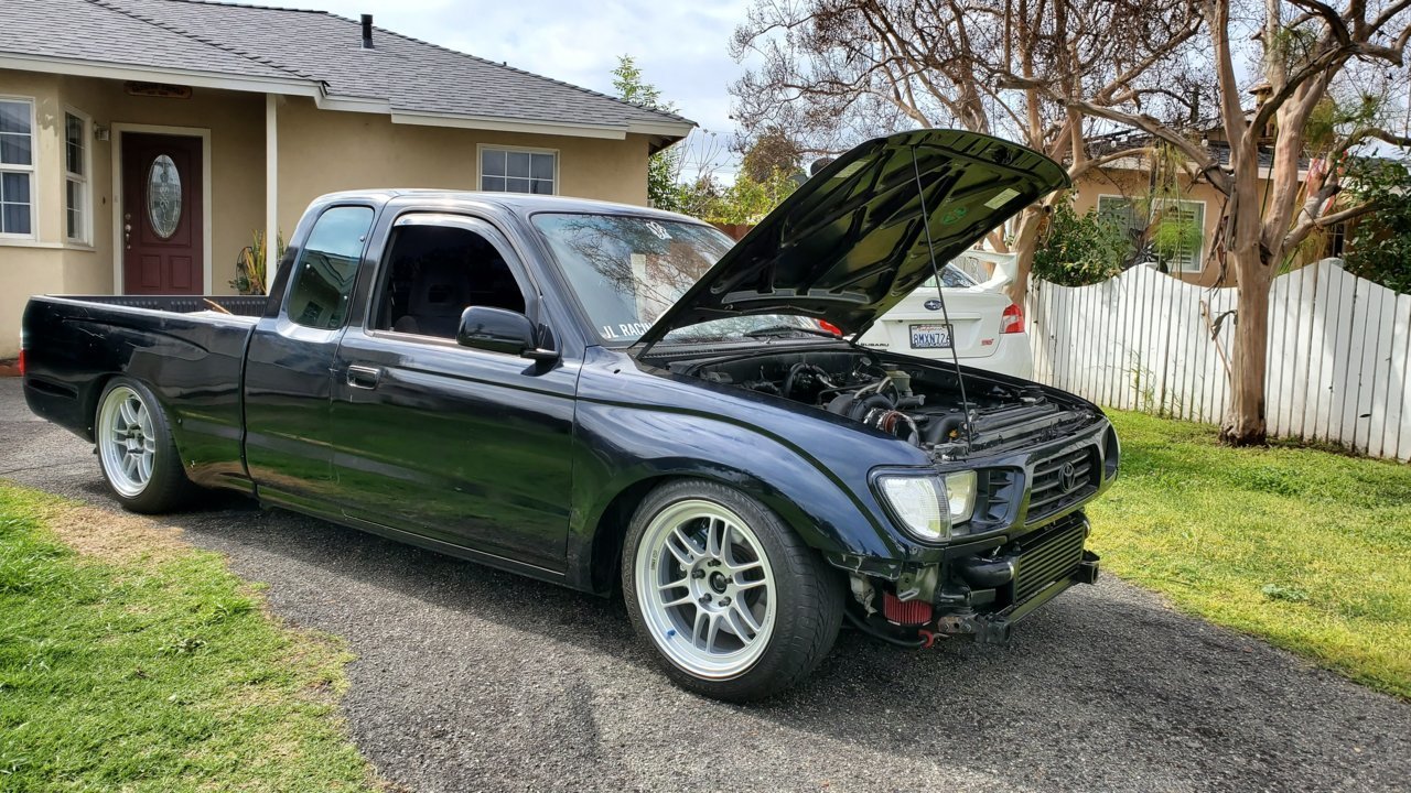

    JVC Deck, 10" sub mountd in rear seat cubby, 2 LED off road lights mounted in grille, amber raptor style grille lights, LED rock lights, square led bed light, custom made fuse block tray, 12 blade Blue Sea fuse block, 100a marine circuit breaker, black plasti dipped full grille, tinted tail lights + third, Uniden 520 with 4' firestik, Bilstein 5100s with 620lb Eibach coils, Diff drop, Chevy 63 leaf swap, TG creeper joints, 14" triangulated biletein 5125s, 8" extended steel braided brake line, TG Rock Sliders, CBI Moab 1.0 front bumper, custom fabbed bed rack, full TRD E-Locker axle swap and matching re-gear with custom stand alone wiring circuit, 29 spline pinion flange from an 06 wishbone runner, tubbed for 35x12.5" general grabbers on Ultra type 181 wheels, crush sleeve eliminator, Mini ARB compressor, front ARB locker, garage fab aluminum front skid plate, custom built high clearence rear bumper, removable mothafuckin doors
    so god damn dumped
    so god damn beautiful
