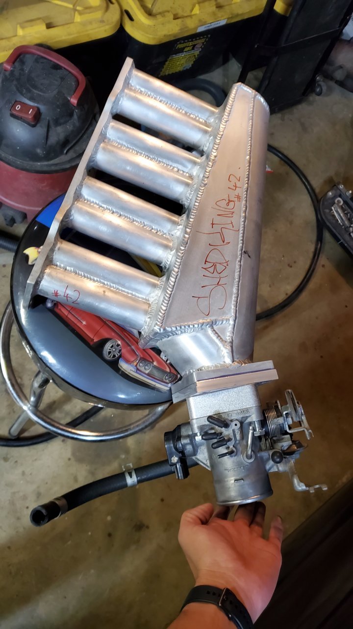

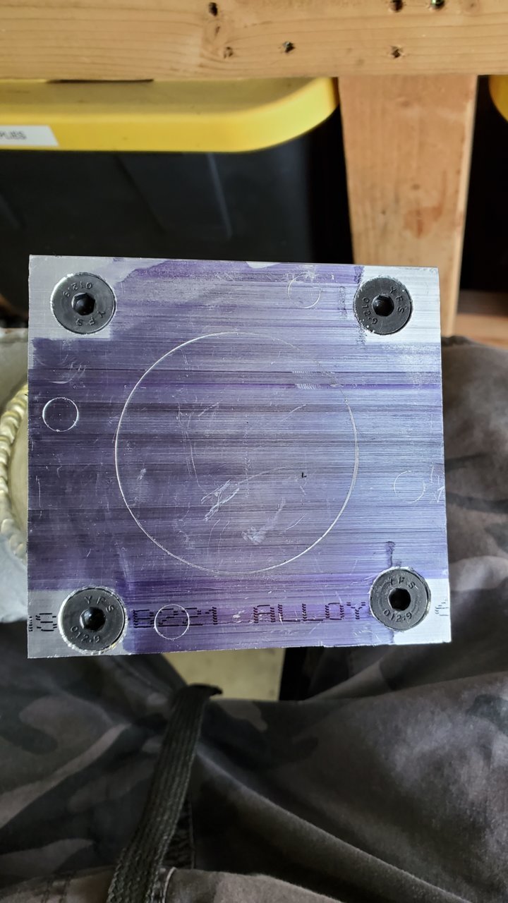

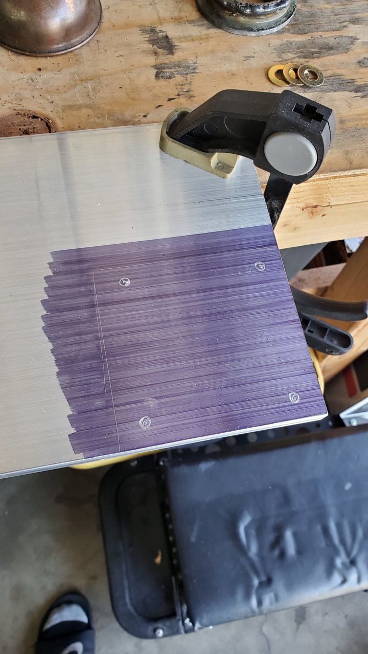

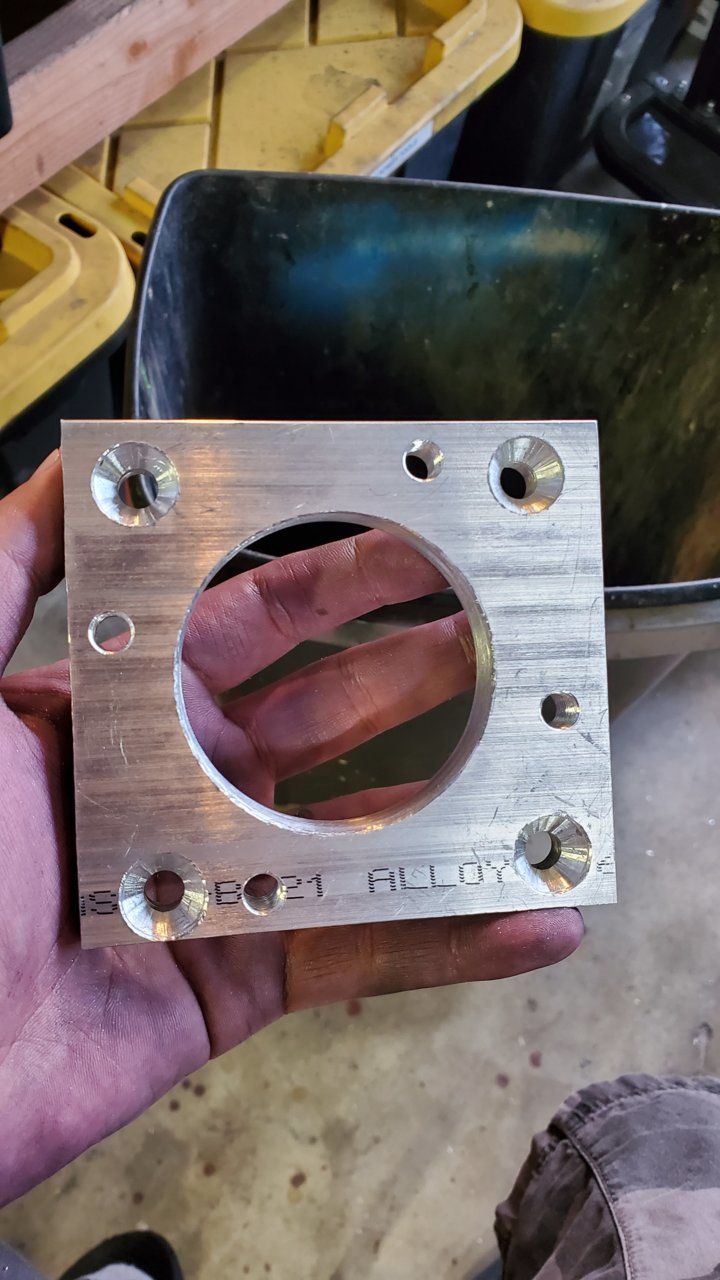

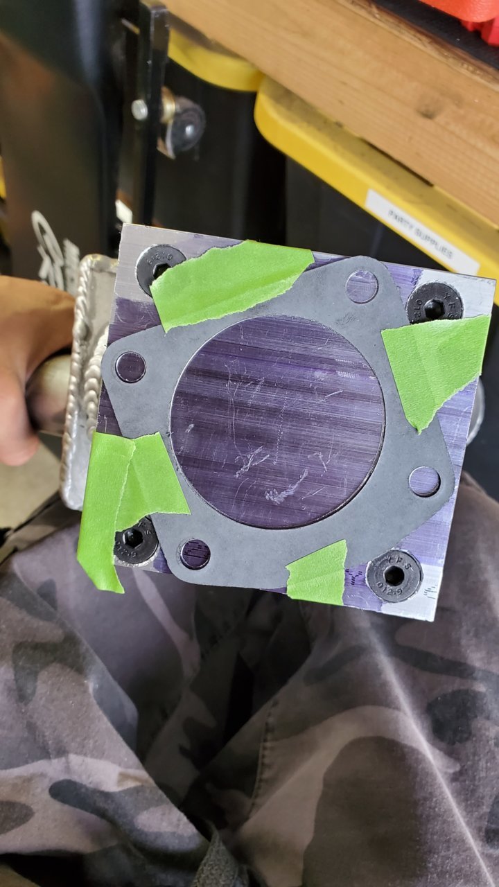

    Since my intake manifold uses an aftermarket throttle body, I had to make an adapter for the stock one. I dont want to lose the IACV or rewire my TPS till I get my standalone ecu so I made it work. I'm also gonna end up having to run a throttle body spacer since I had to put it in at an angle the throttle bracket hits the manifold.

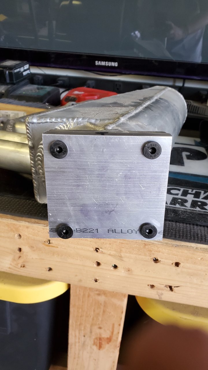

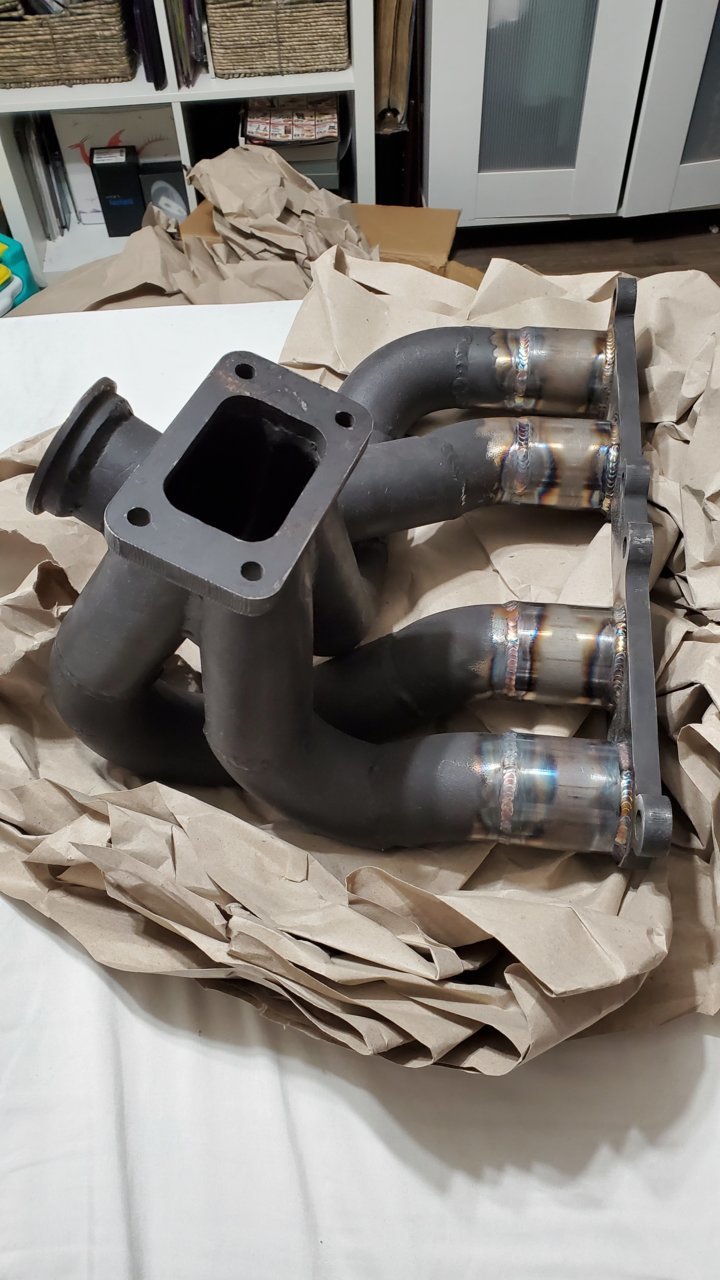

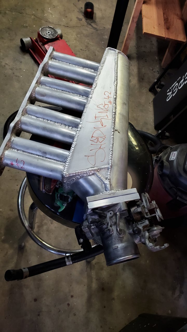

    Had to have the runners extended on my manifold. Test fit went well so now I can finish installing everything.

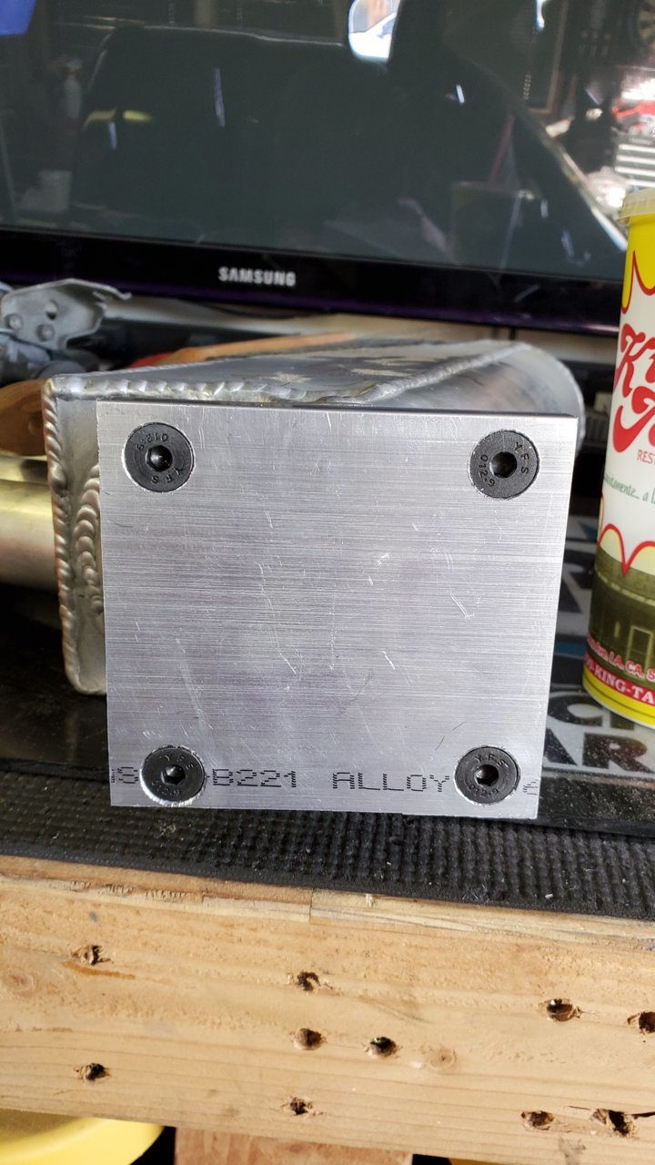

    TBS came in and the throttle now opens 100% without hitting. Doesnt look the prettiest but it works and will be replaced with a whole new throttle body when I go full standalone

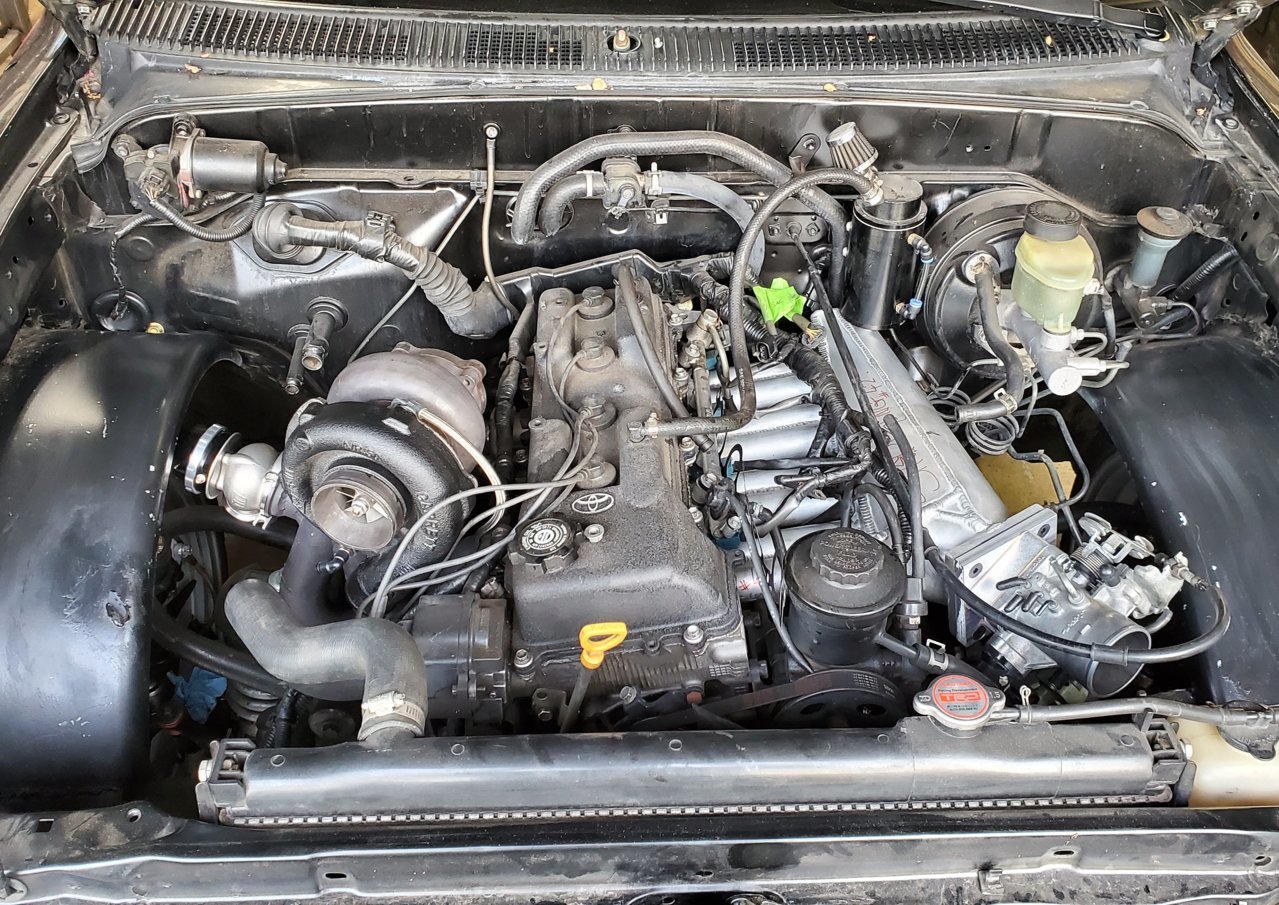

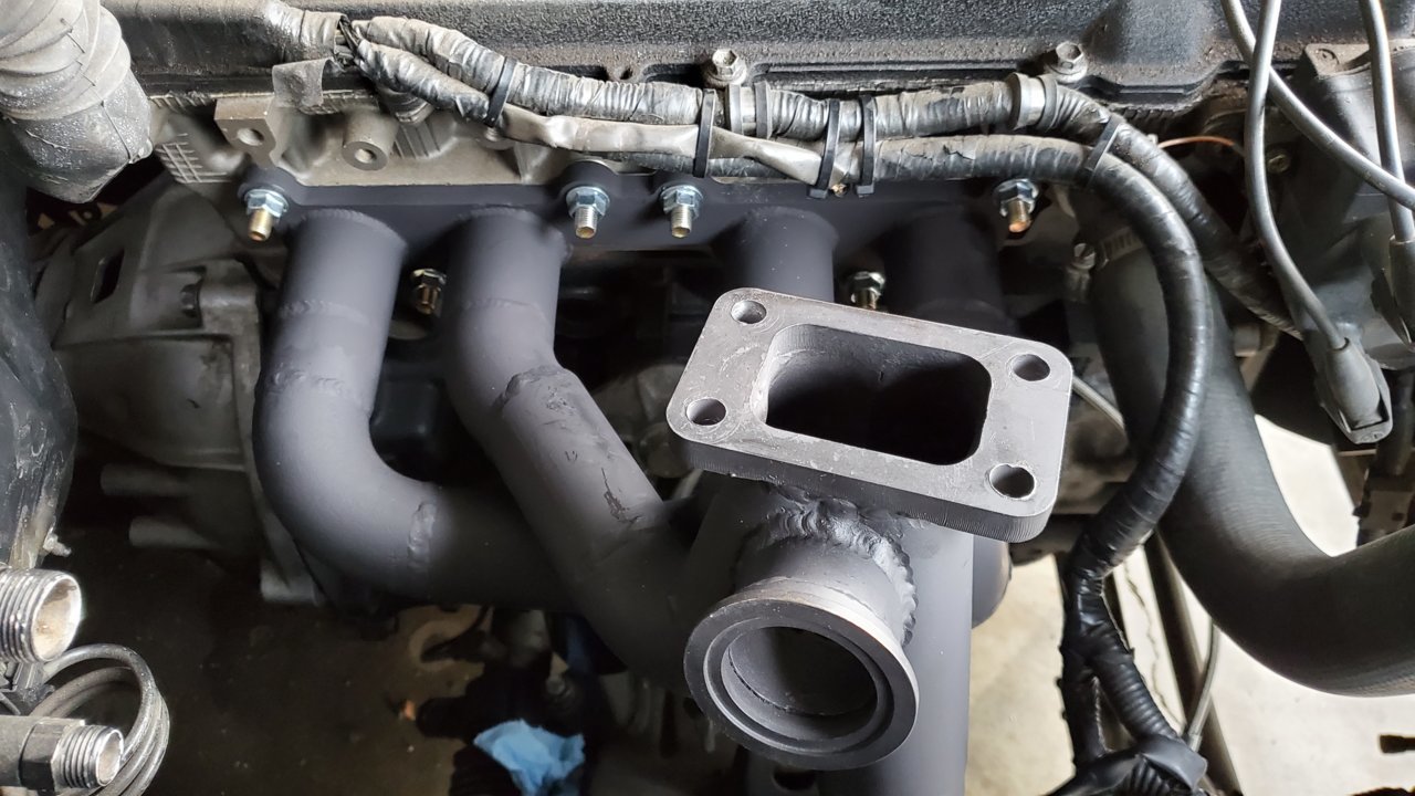

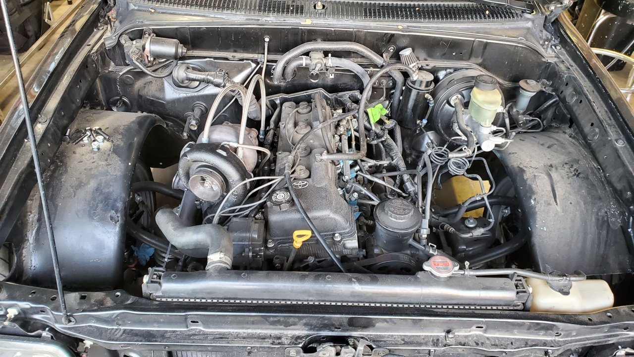

    Test fit is complete. Just need to get a turbo drain line made, then tap the intake manifold for some vacuum fittings. Once that's done I can start the final install then fab the intercooler piping and exhaust and get this thing running.

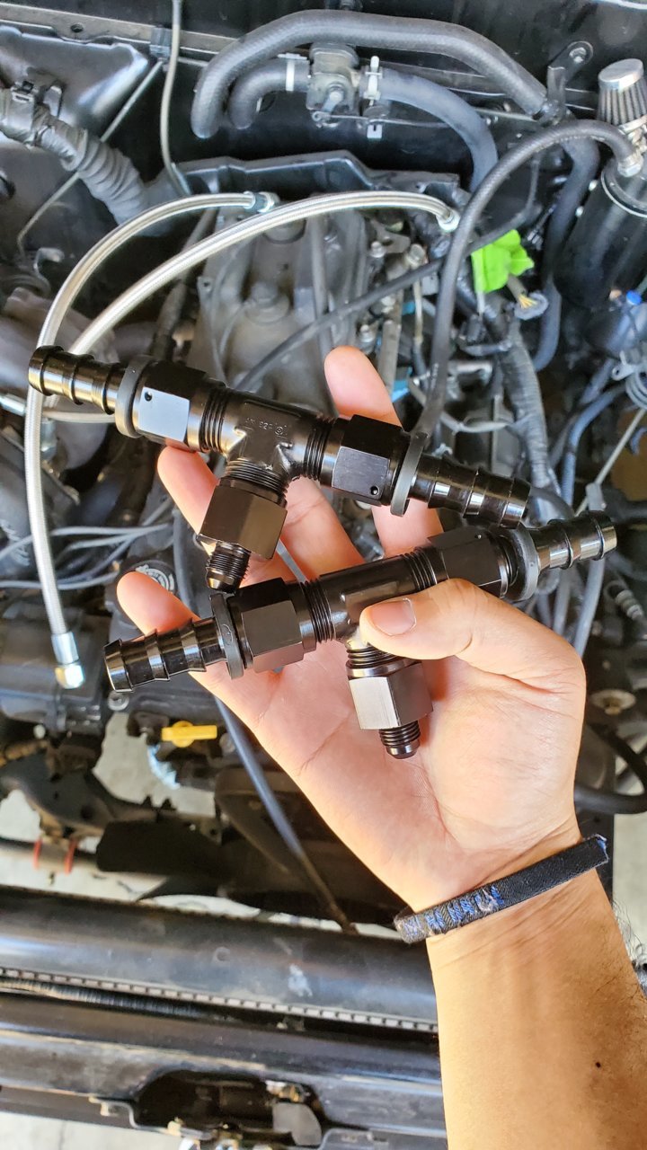

    All AN fittings to tap into the coolant lines on the firewall to feed the turbo.

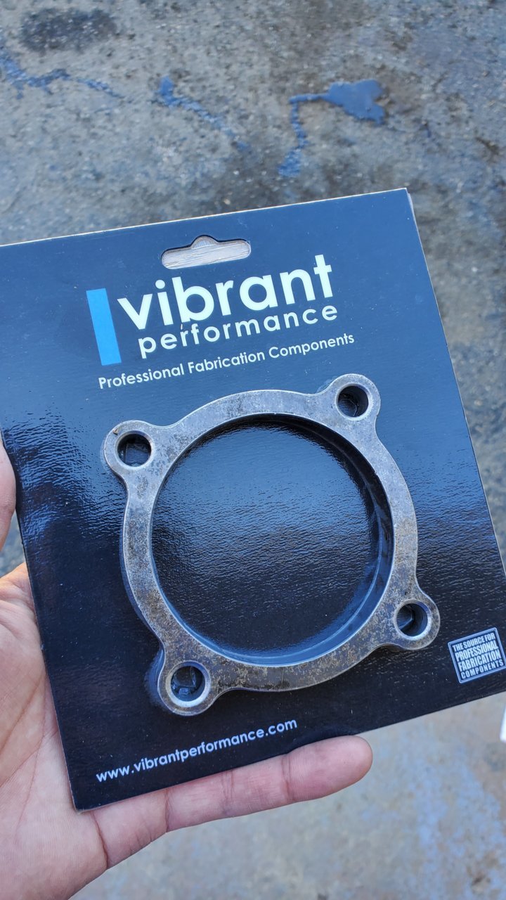

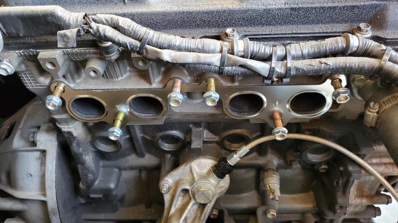

    Upgraded exhaust manifold studs.

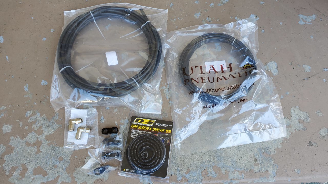

    More parts! Vacuum line, fire sleeve, vacuum fittings, and hose separators

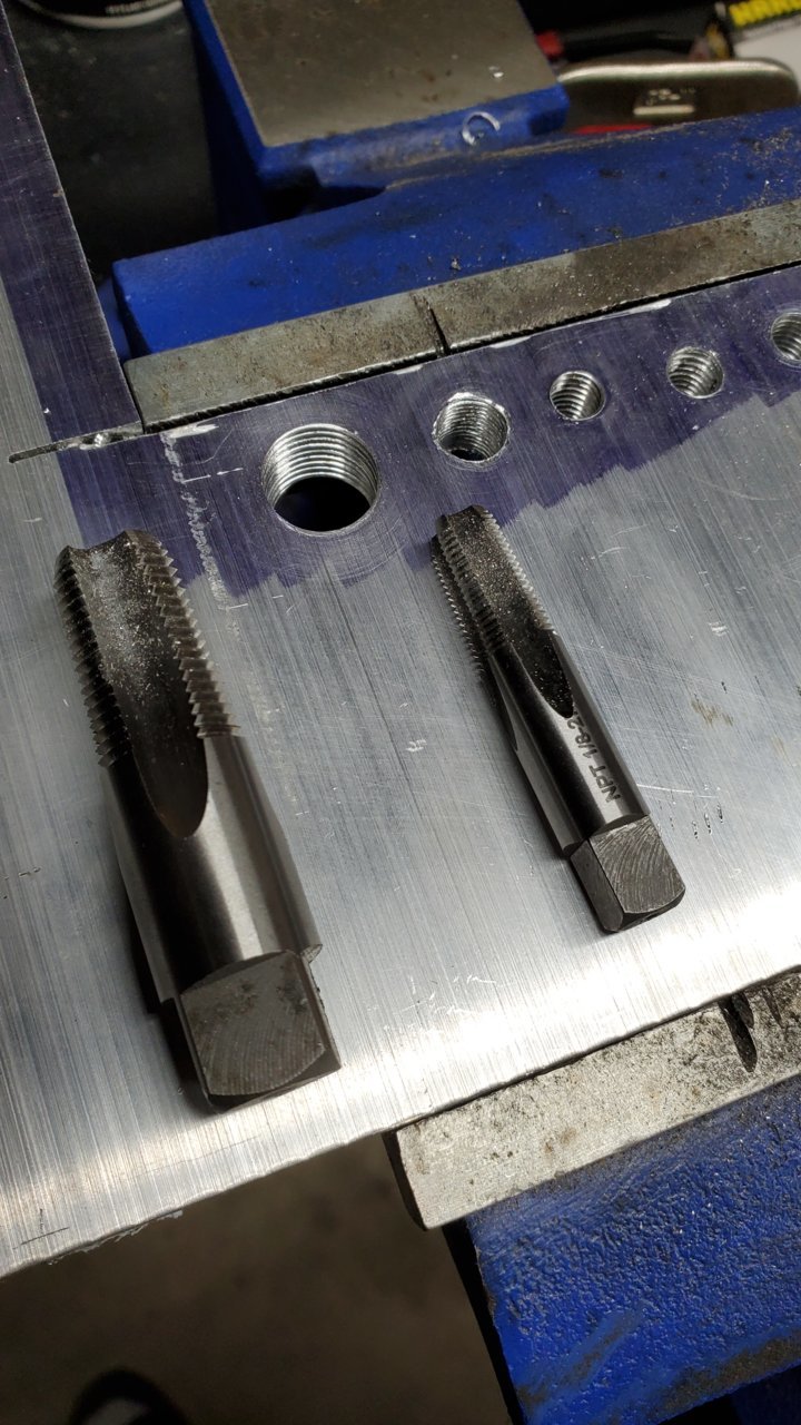

    Had to practice running NPT taps before I tapped the intake manifold for all the vacuum fittings. Went pretty smooth so I'll be tapping the intake manifold soon.

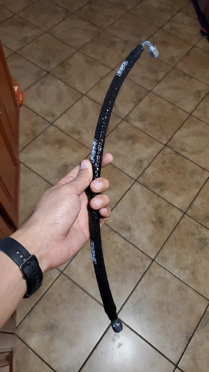

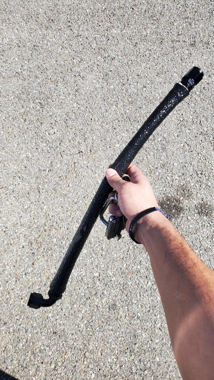

    Wrapped the oil feed line in the DEI fire sleeve.
