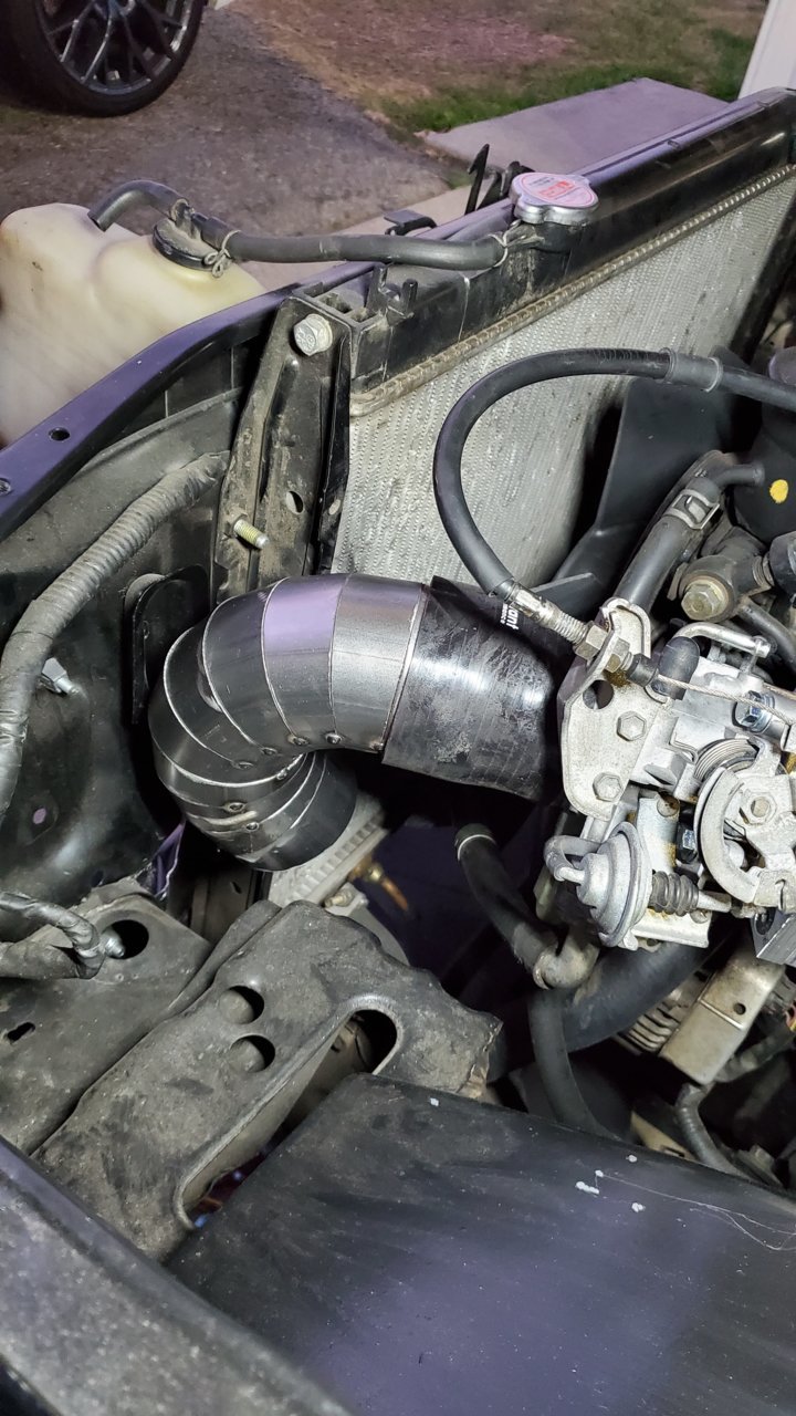

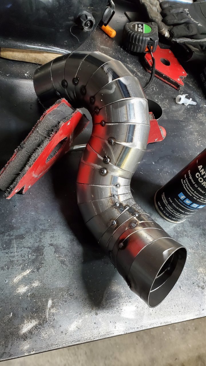

    Started on the cold side intercooler piping. Since I dont have a tig welder I'm making it out of steel. It's not ideal but it will work. Not looking forward to welding this up haha

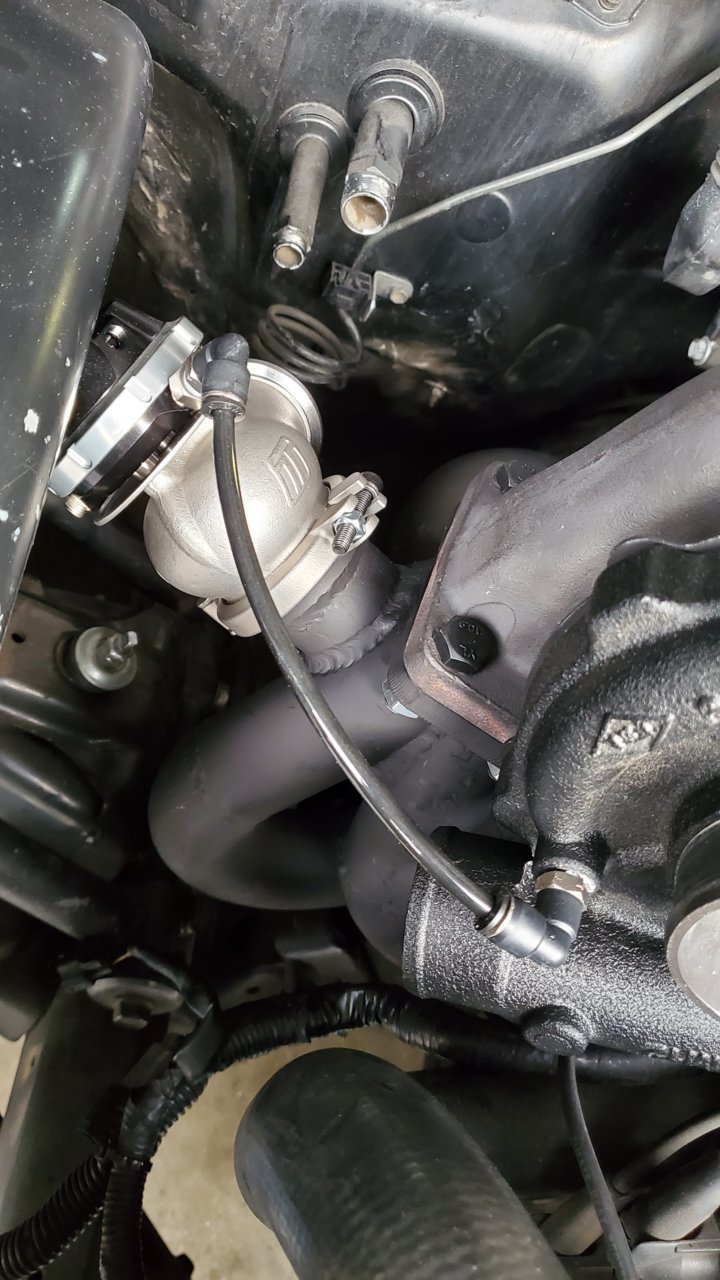

    Started working on my vacuum lines too. Hoping to use all push to connect fittings and lines.

    How come you decided not to use mandrel bends?

    I did try, the bends weren't tight enough. Trust me I would have much preferred Mandrel bends :(

    Damn that is a tight space! I totally see why now. That's going to be a lot of welding...lots of practice! It'll be cool to see the first bead vs the last on that section.

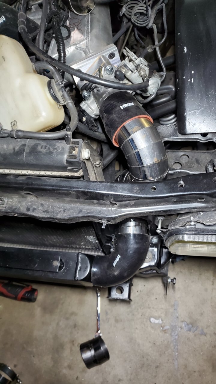

    Finished mocking up the cold side intercooler piping. Still need to weld it up, add a pipe for the iacv hose, and clearance the core support some more.

    That's a seriously tight fit! Nice work on making that shit fit

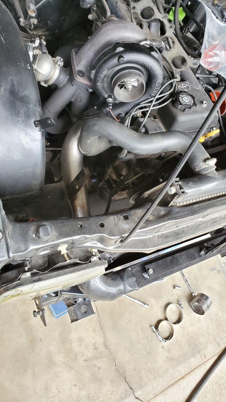

    After struggling so much with the cold side. The hot side was sooooo straight forward. So happy I got a win lol
