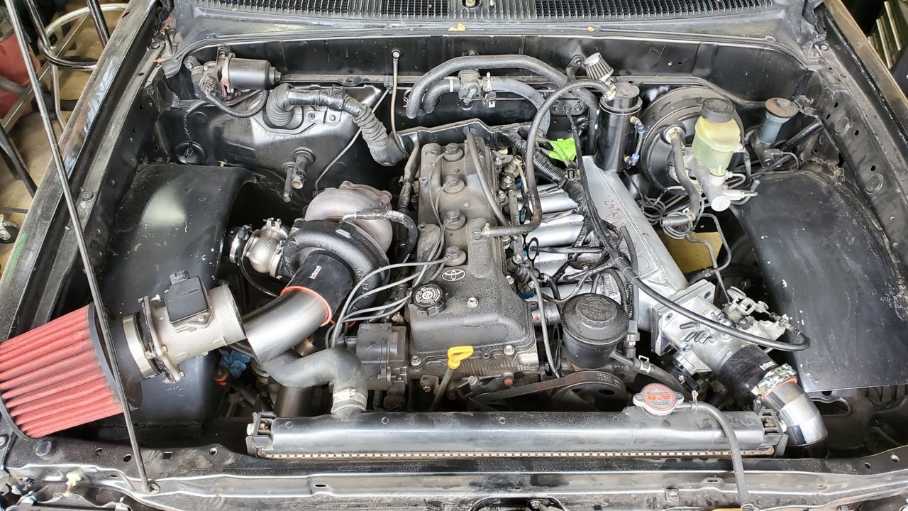

    Mock up is all done! Had to order a shorter filter.

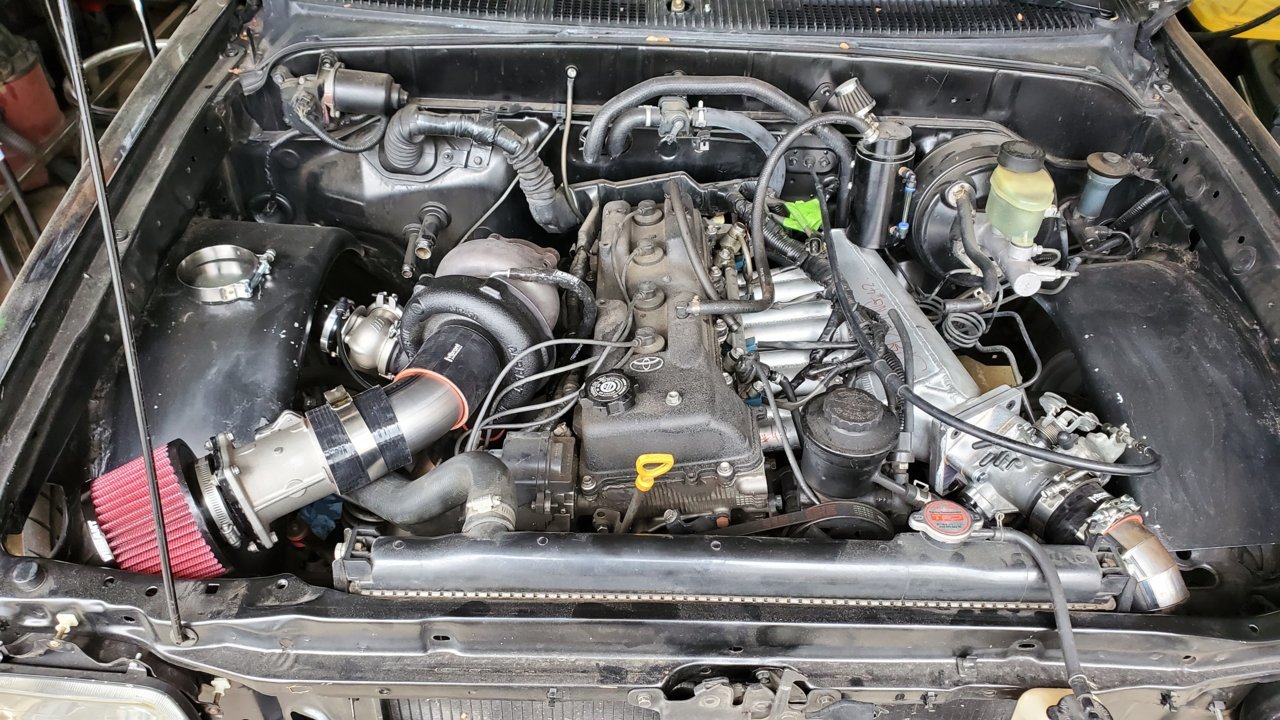

    New filter came in.

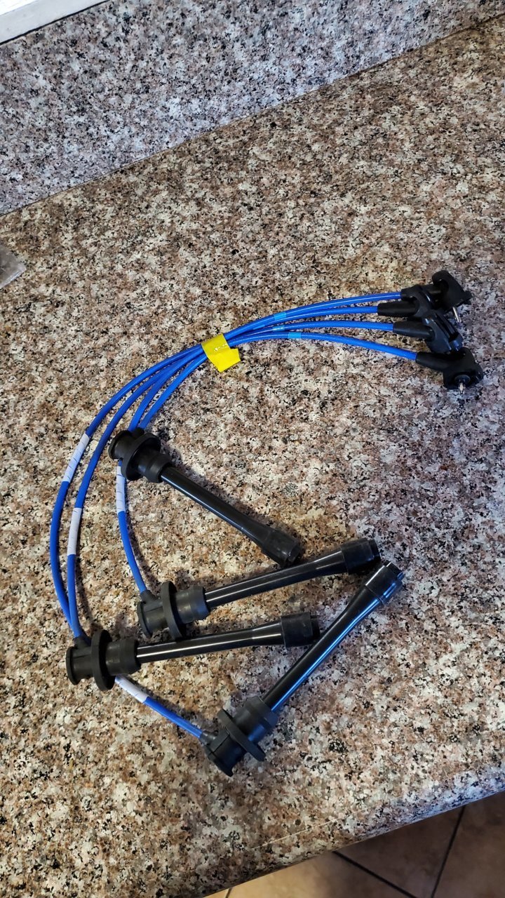

    Had to change these wires. The blue wouldnt look good at all.

    Who makes those? They look pretty sweet.

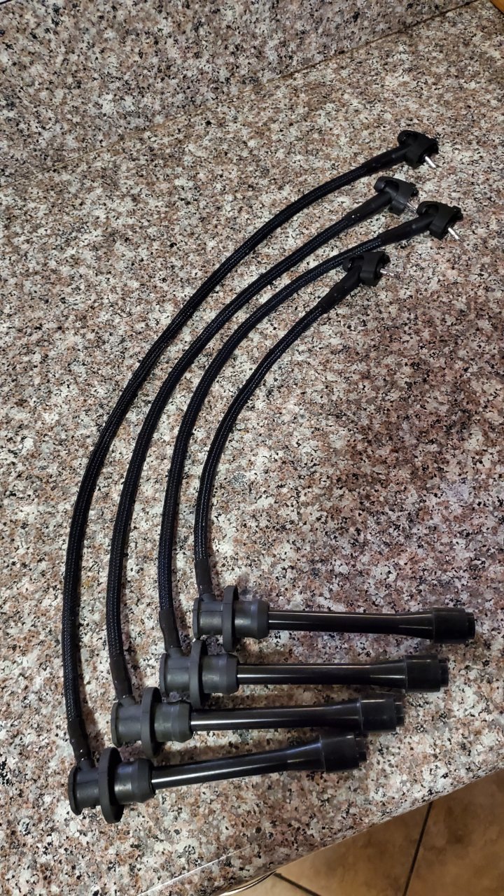

    They're NGK wires that I wrapped

    That's a great idea! That adds a nice touch, looks like high tech race truck parts :)

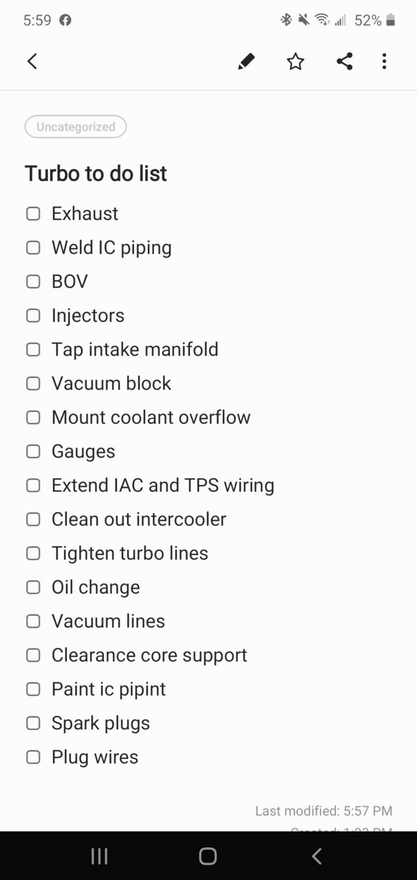

    Final assembly and start up starts this week! Screenshot_20200228-175919_Samsung Notes.jpg

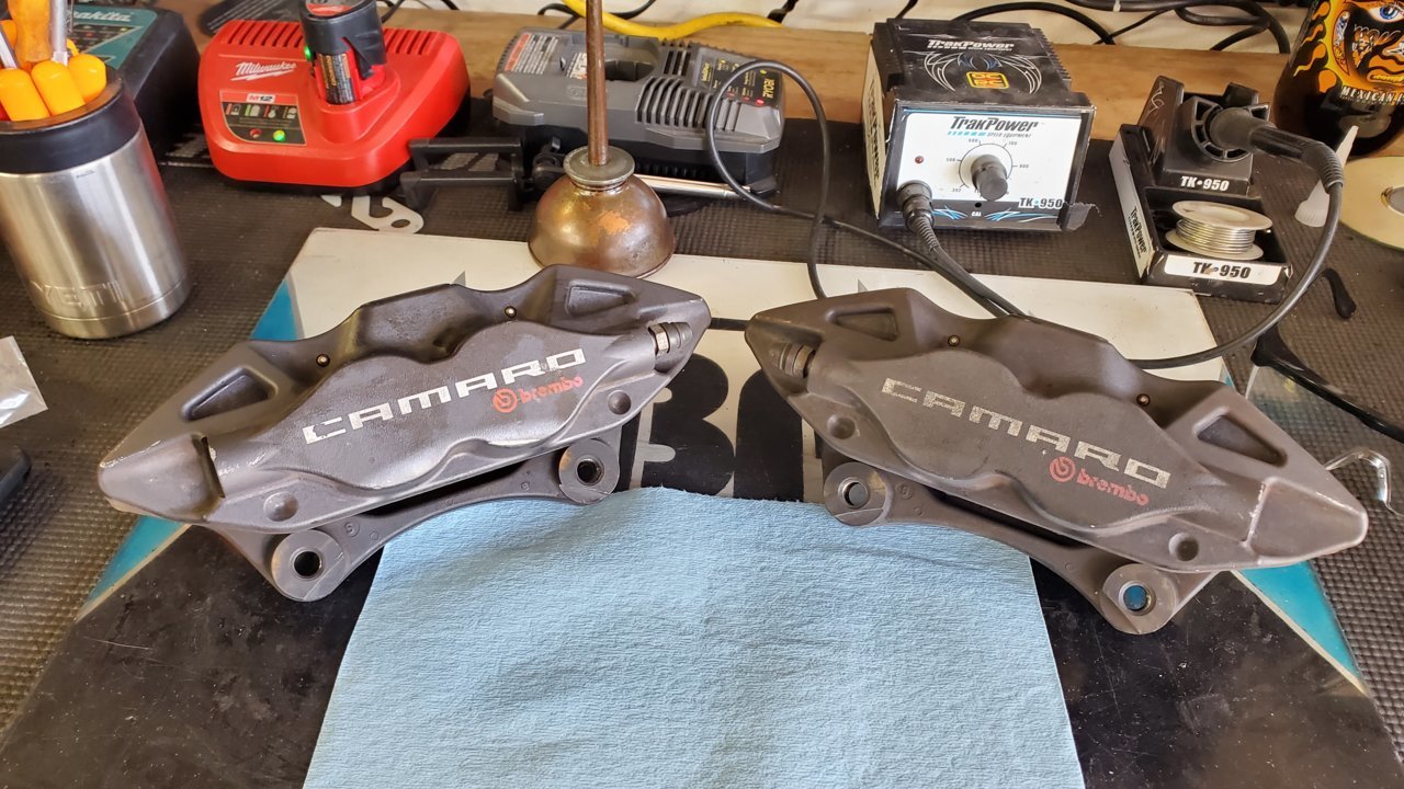

    Next project after the turbo is done!

    These are smaller calipers that will be going on in the rear.
    ireymon[QUOTED] likes this.

    sweet! I've been tossing around the idea of trying to find something smaller like that to see if I can keep the stock rotors up front since I'm not sure I want to go down the road of custom machined rotors. Plus, having to buy 17" wheels adds to the expense.

    What mc and booster are you running - I’ve heard so many things about squishy brake pedals with different caliper setups. I’m running stock in the front but going with old El Dorado calipers in the back.

    It's all stock. But the mc and booster are different on the 5 lugs than prerunner/4wd trucks.

    I'd look into wildwood calipers they have some small 4 pot calipers that might work. But youd still to do custom brackets.

    corrrect my 6 lug 4x4 is has a different one as well
