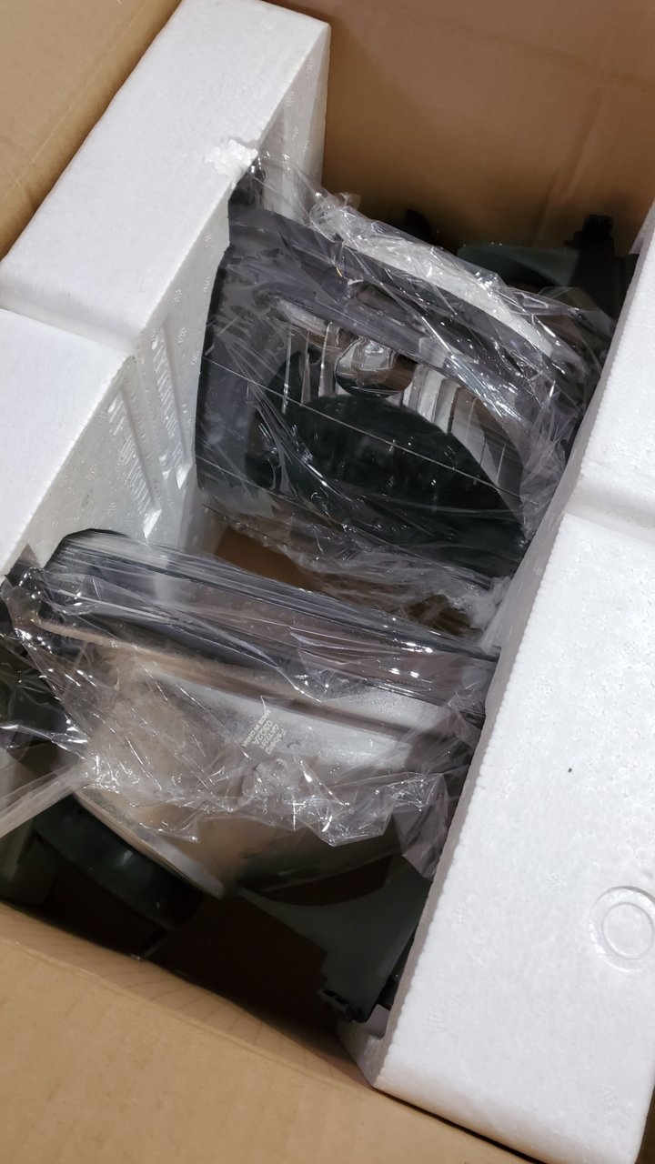

    Headlights are in

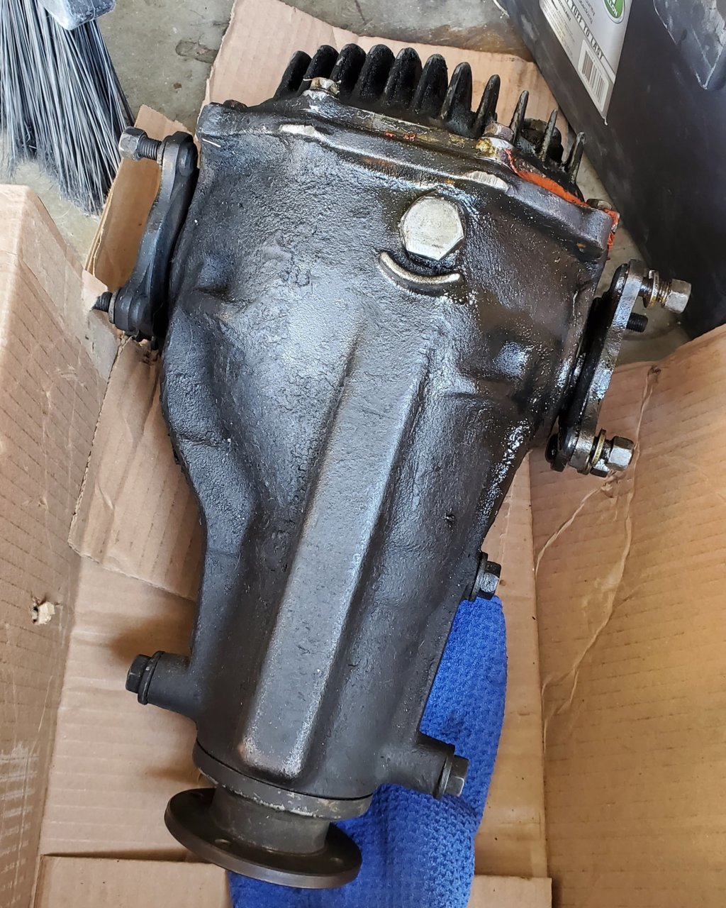

  3. Jan 9, 2021 at 12:19 PM
    #463
    mjbtaco
    mjbtaco [OP] low and slow
    Mar 21, 2008
    #5423
    4,809
    Michael
    Montclair , so cal
    Turbo'd 95.5 extra cab and 2013 Silver DCSB TRD Sport
    PERFORMANCE Custom Turbo Setup FRONT SUSPENSION Drop Spindles by Aaron Carswell 01-04 Swaybar Endlinks Energy Suspension Endlink Bushings Cando Upper Control arms QA1 coilovers with 8" spring Custom 4 pot Brembo BBK Modified lower control arms with mjbfab qa1 mounting plates and Poly bushing sleeves REAR SUSPENSION Chasis Tech drop leafs QA1 adjustable shocks weld in drop notch Gas tank cross member bridge 3" angled blocks 2013 Double Cab Short Bed TRD Sport Eibach Pro Truck Shocks front and rear Lifted to the 3rd setting on the front shocks
    Celica Supra LSD. Gonna rebuild it before throwing it in.

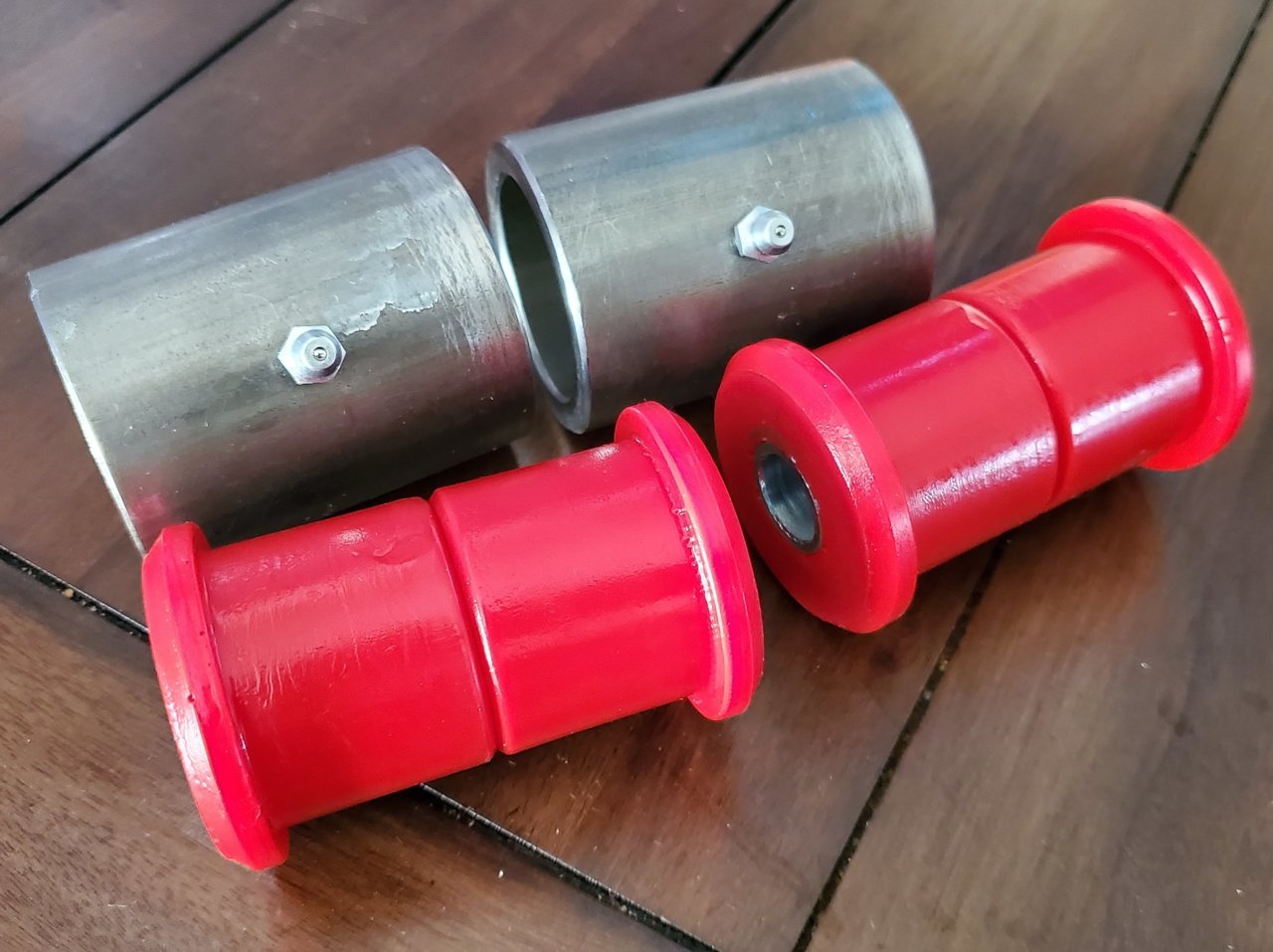

    LCA poly bushings mods coming soon......ish lol

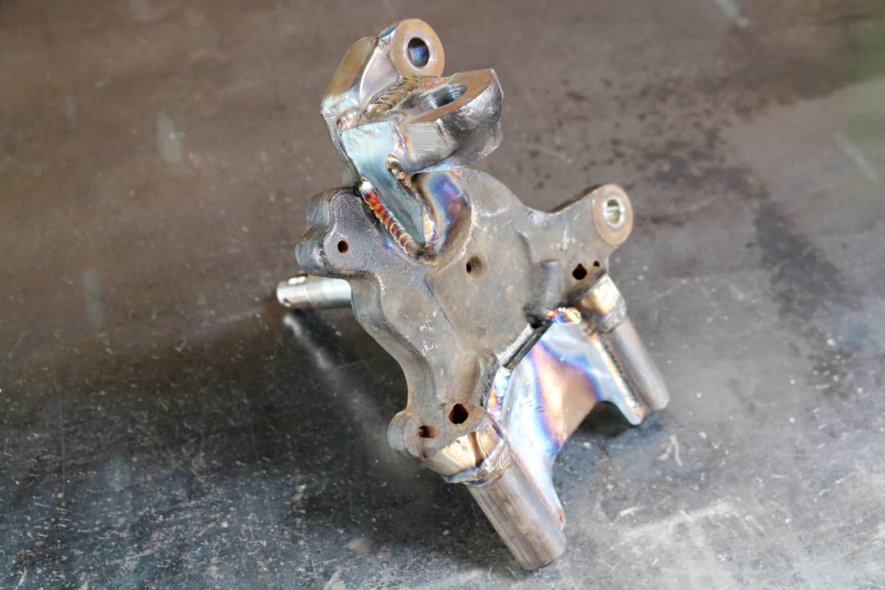

    Guess I just collect parts now lol. Custom drop spindles my friend makes now.

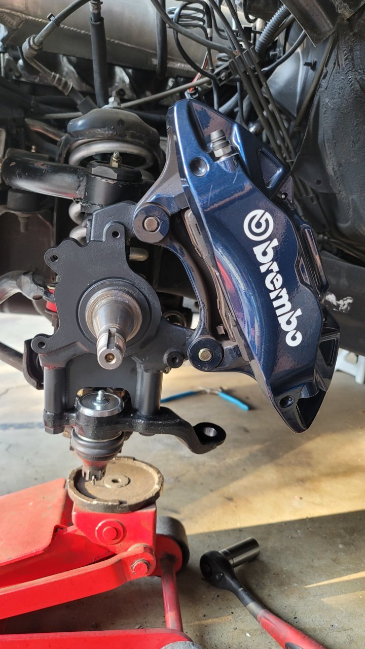

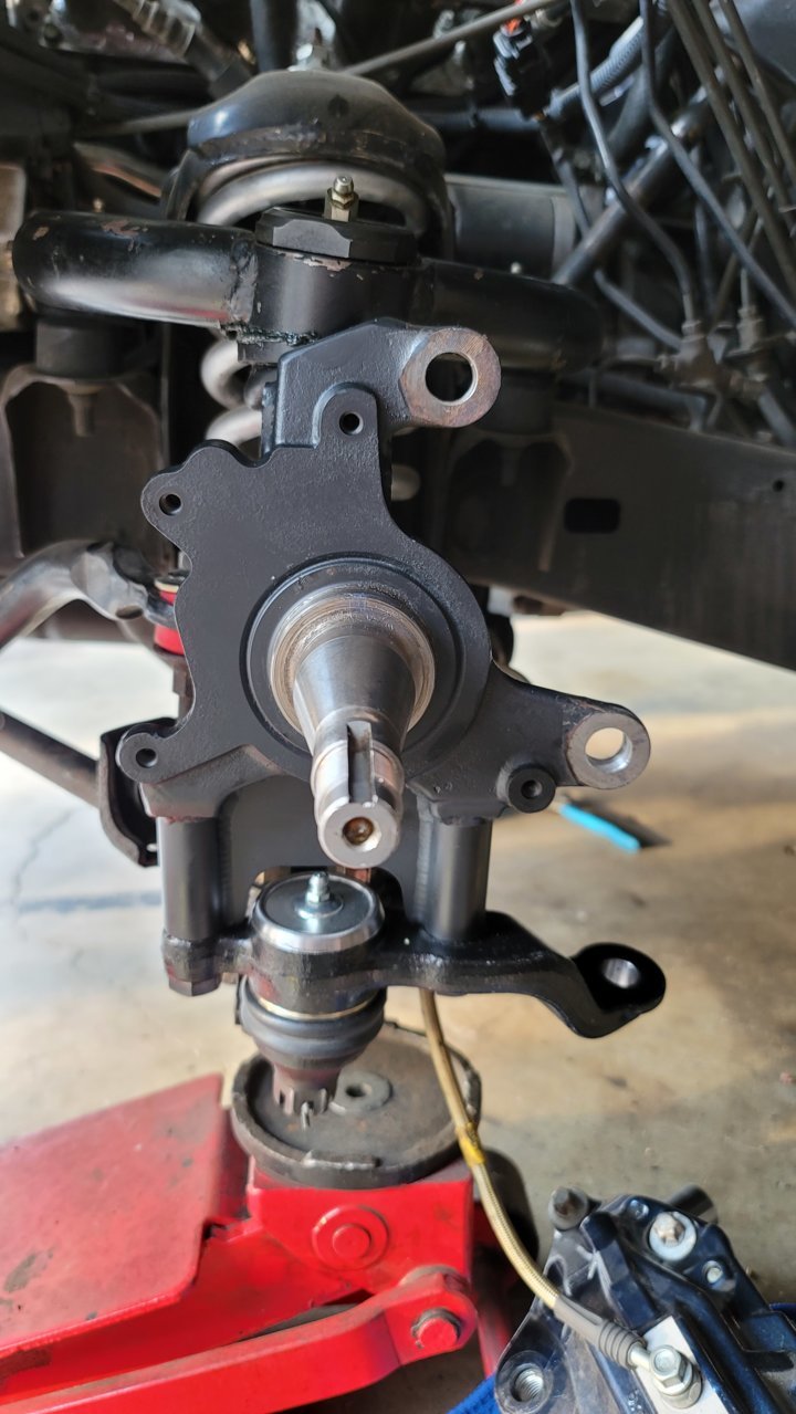

    Damn near 4 months later but I got the drop spindles installed and man what a difference! Rides so much better than with the balljoint flip. Don't ever flip your balljoints lol

    Looking good!!!! I got my spindles a couple months ago and I’m wondering if I should get the adjustable upper control arms to keep my alignment in spec. I see you have different upper arms but did you have any alignment issues?

    The spindles will actually keep your camber fairly within spec when lowering. I have longer upper arms and ended up having positive camber after installing the drop spindles so you should be good with the stock arms.

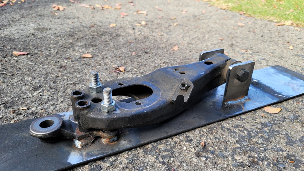

  15. Dec 16, 2021 at 7:35 PM
    #475
    mjbtaco
    Mar 21, 2008
    #5423
    4,809
    Michael
    Montclair , so cal

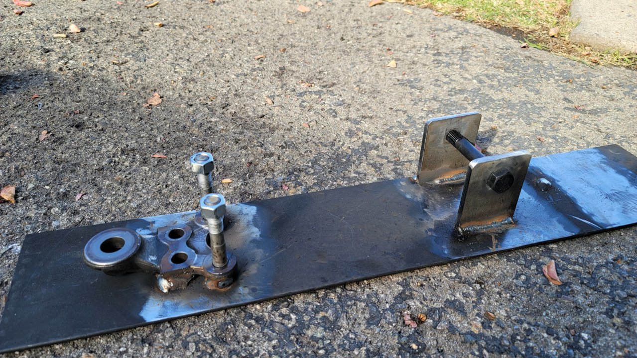

    Soonish is here! Lol

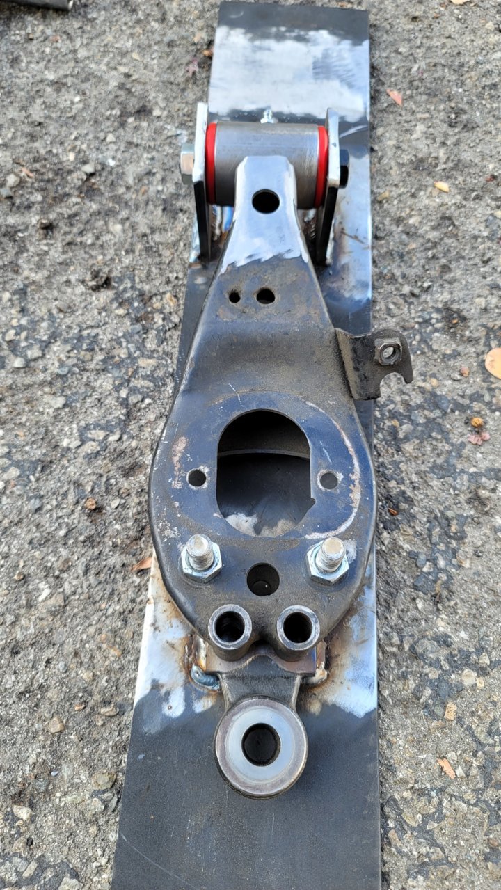

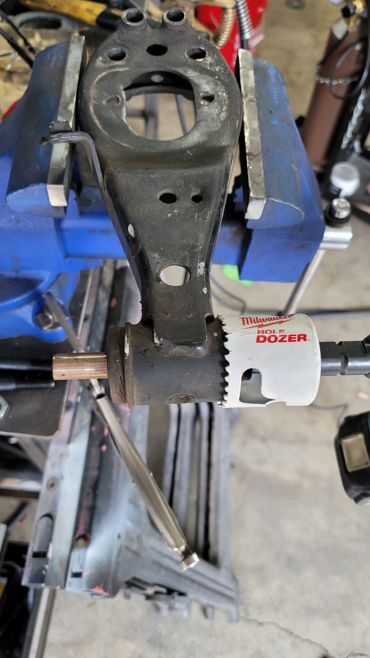

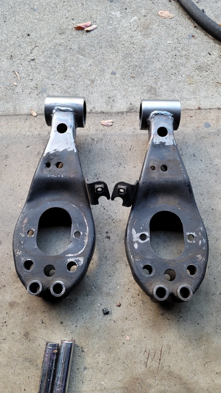

  16. Dec 16, 2021 at 8:06 PM
    #476
    boostedka
    boostedka Well-Known Member
    Sep 29, 2011
    #64367
    5,985
    James
    NM
    2013 DCSB 6MT, 2004 4runner

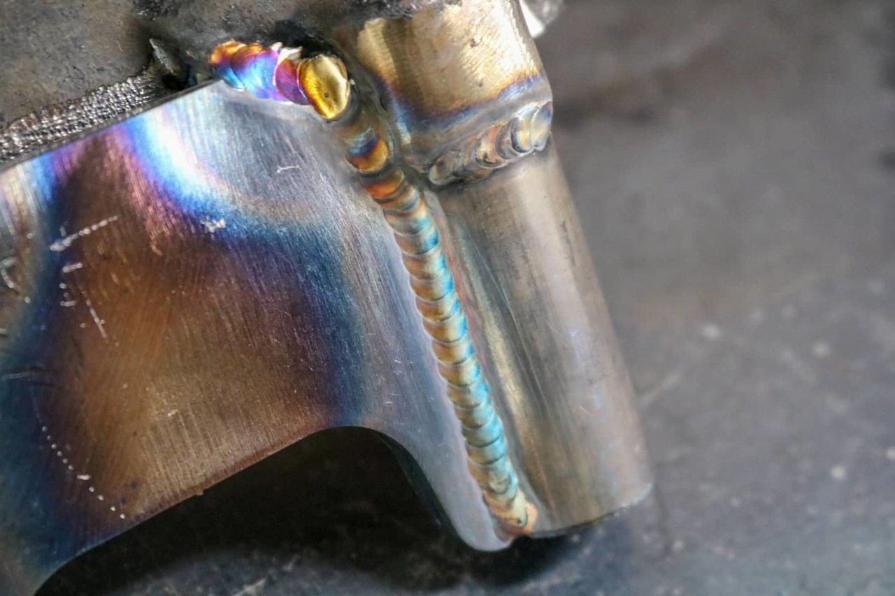

    Damn! That is some sic work on those lowers! That jig you made was a pretty creative idea. Your welds came out pretty nice too.
    mjbtaco[OP] likes this.
  17. Dec 16, 2021 at 8:41 PM
    #477
    mjbtaco
    Mar 21, 2008
    #5423
    4,809
    Michael
    Montclair , so cal
    Thanks man! Figured I'd make a jig to make sure I got the stock geometry right. Had some trouble filling some of the larger gaps with the tig but overall im pretty happy with the results.
