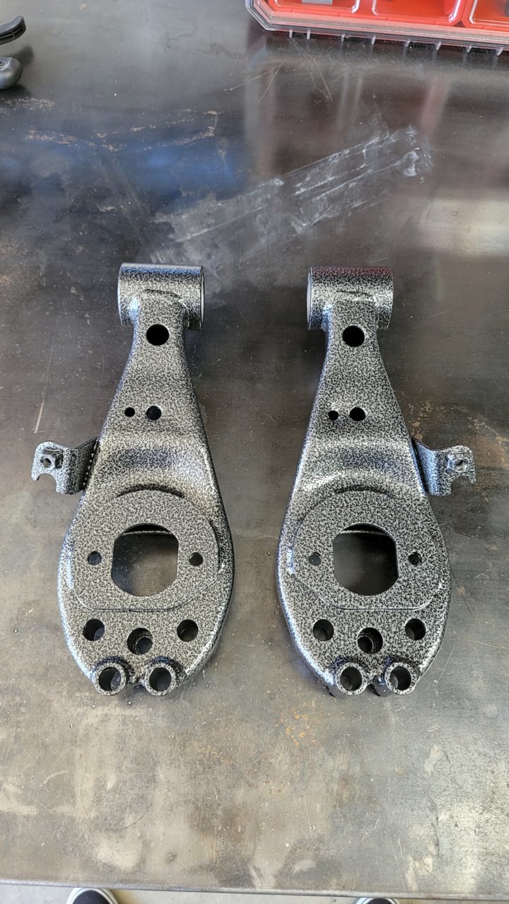

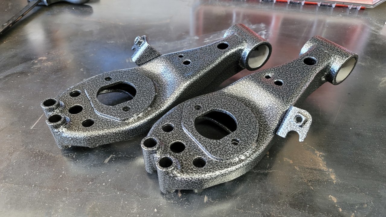

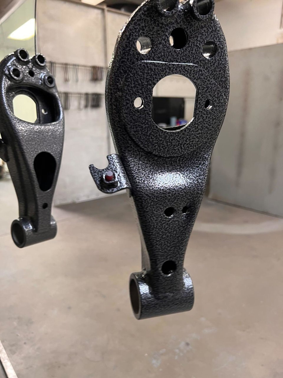

    Picture from my powdercoater! Super happy with the new look!!

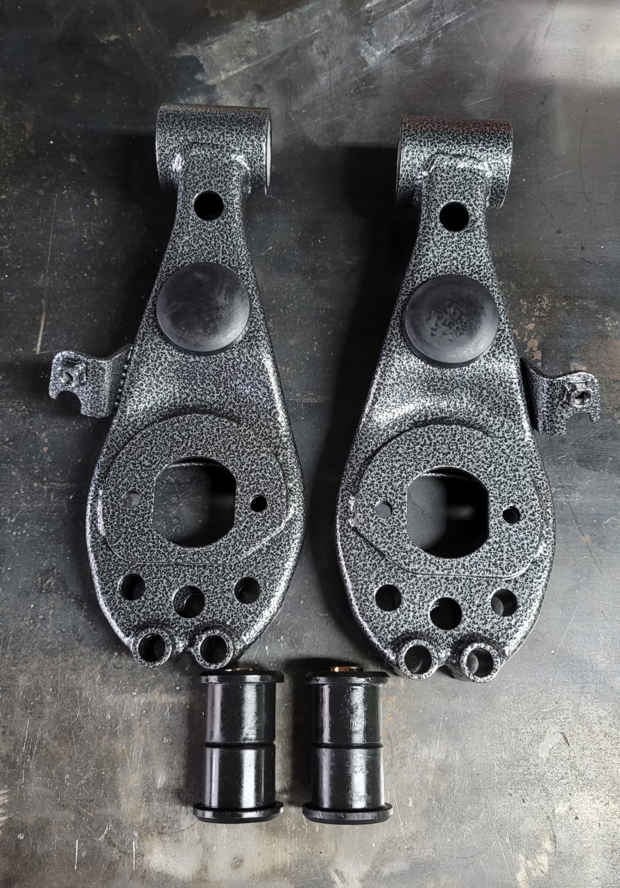

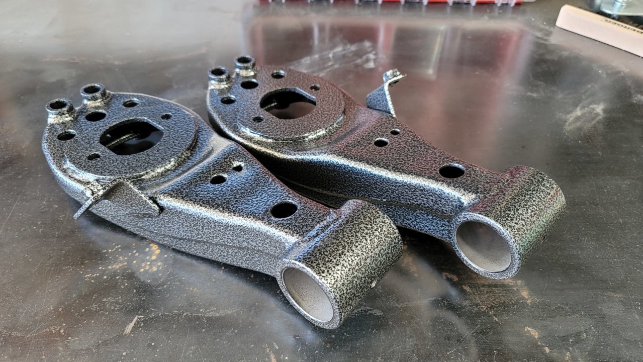

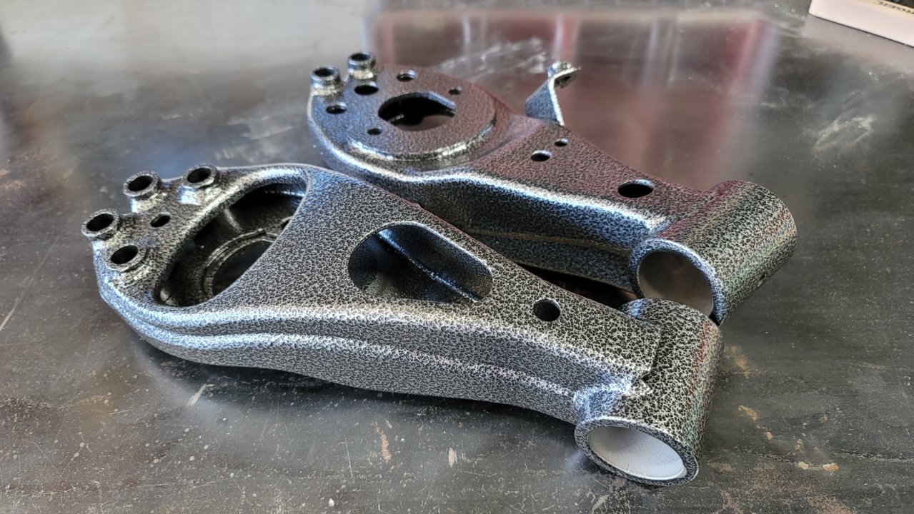

    Better pictures. I love the way they turned out!

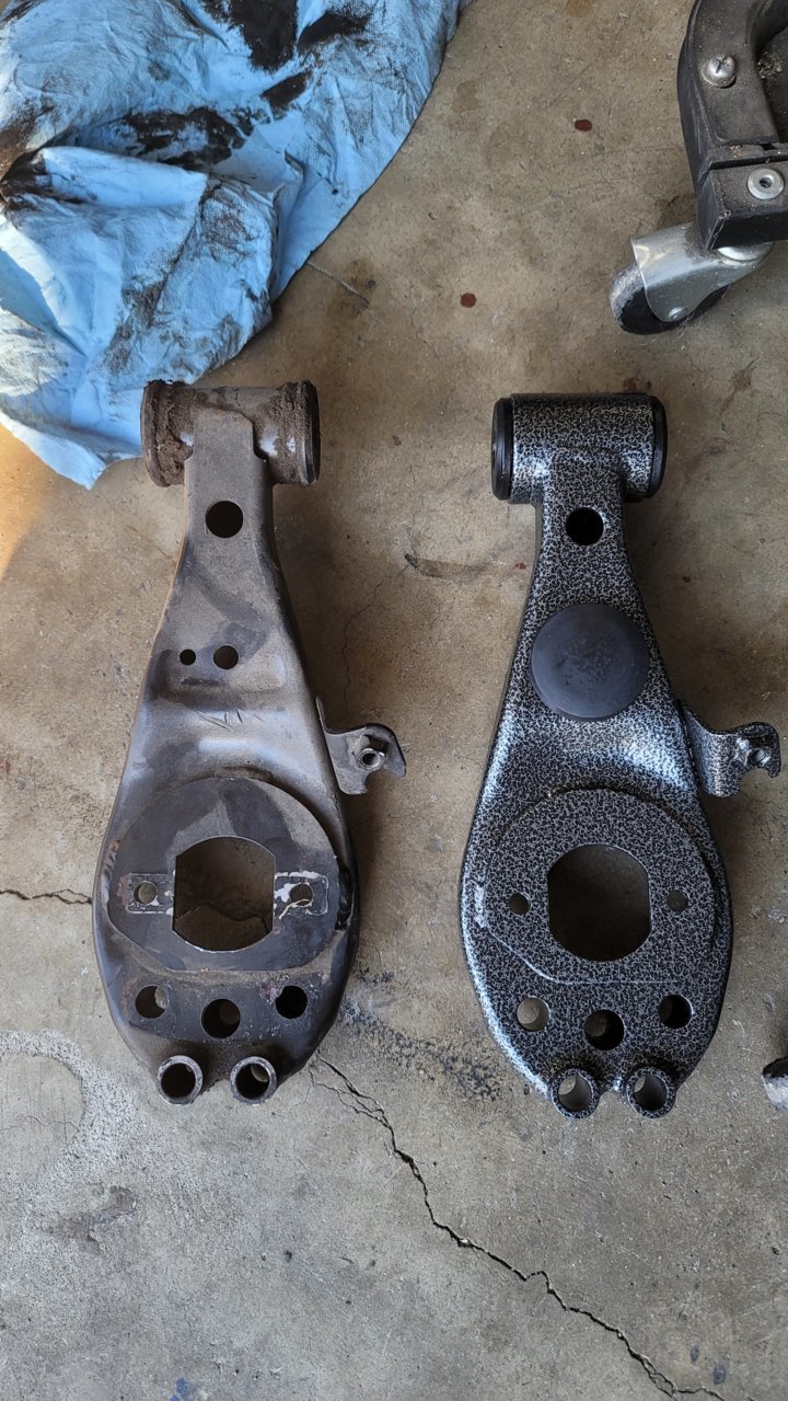

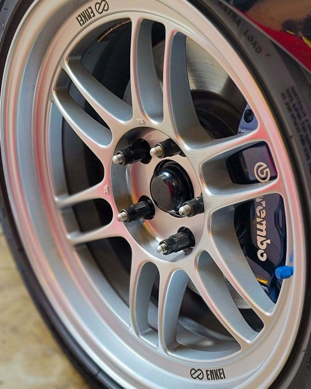

    All black bushings are in. Now I just gotta get the right grease and the arms are ready to install.

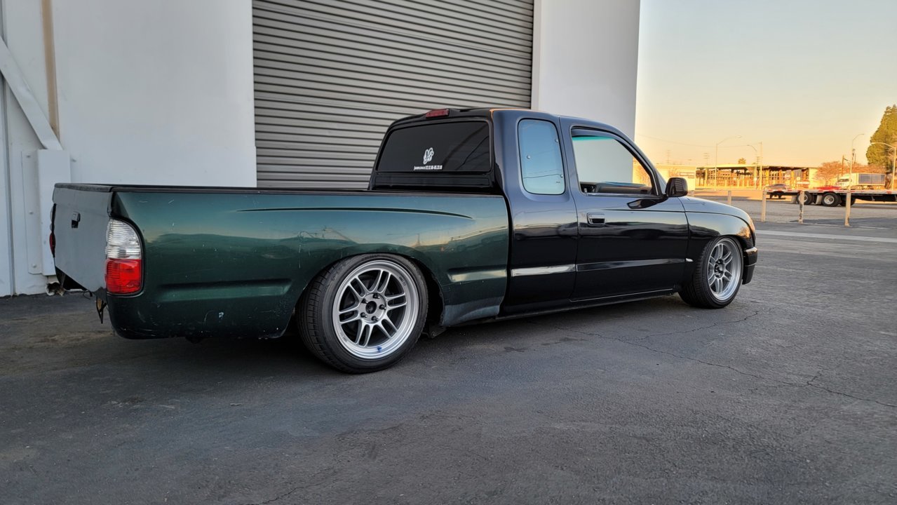

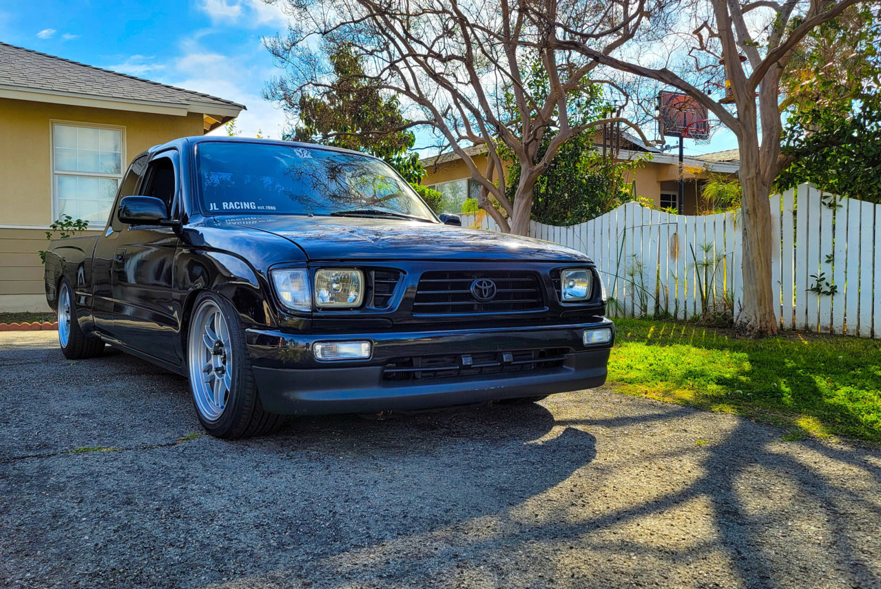

    Latest pic of the truck. Not much has changed.

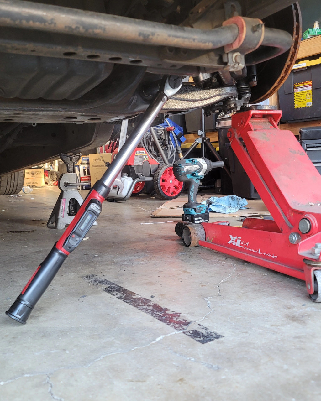

    New arms are in and I didn't die on the test drive so we're good for now lol

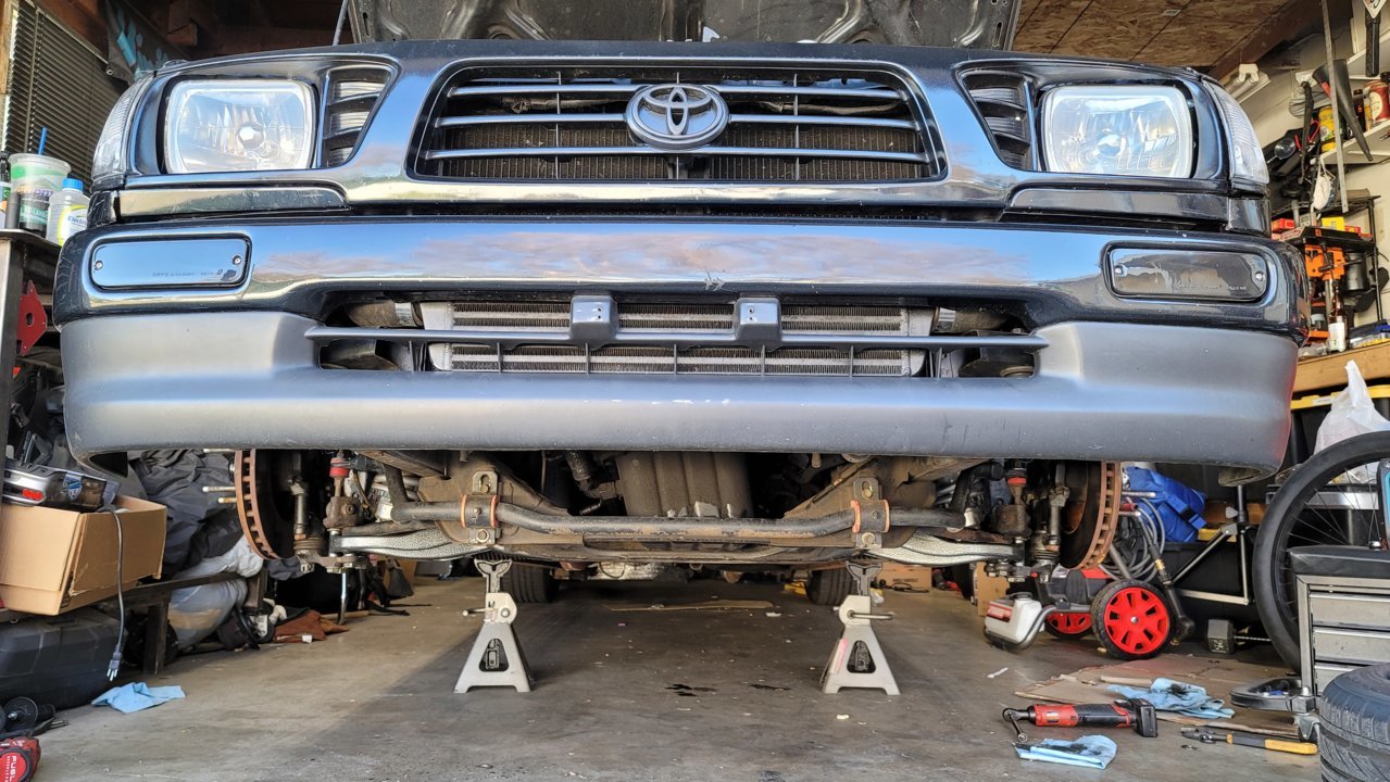

    Can you spot the small change?

    Clear bumper lights?

    Yup lol also swapped the corners but that's harder to tell.

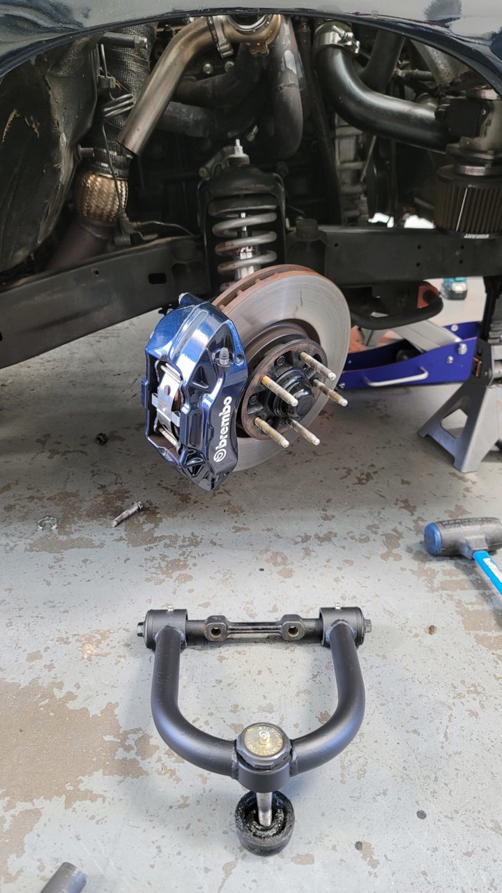

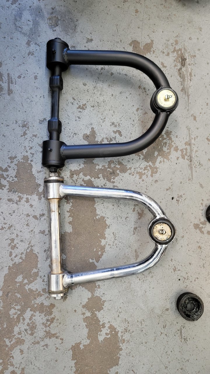

    So after I put the drop spindles in I ended up having quit a bit of positive camber because my upper arms were longer than stock. My friend had the opposite issue on his daily, he had too much negative camber. Since I had a bunch of shims just to get it at 0 camber and he didn't have any and had a bunch of negative camber we decided to swap arms. Now we're both pretty much where we need to be with no shims. Bonus for me was that his arms are a bit narrower so I have more clearance for my brakes now. I can reach full lock and they don't hit the arms anymore.

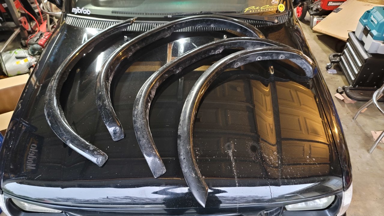

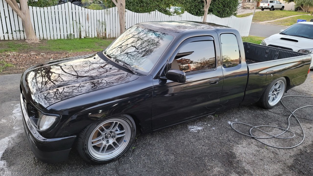

    Today's score. OEM Toyota flares. The smaller version which are found on some 6 lug trucks from i think 2000 and 01-04 s-runner models.

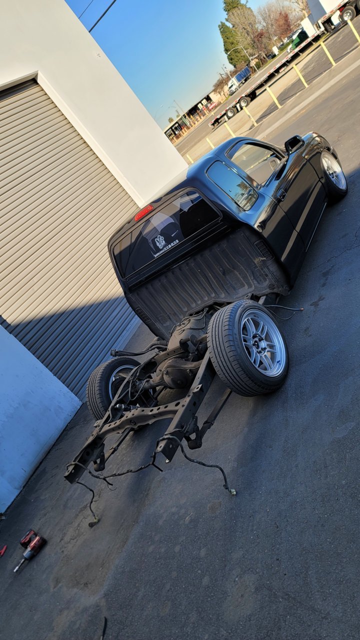

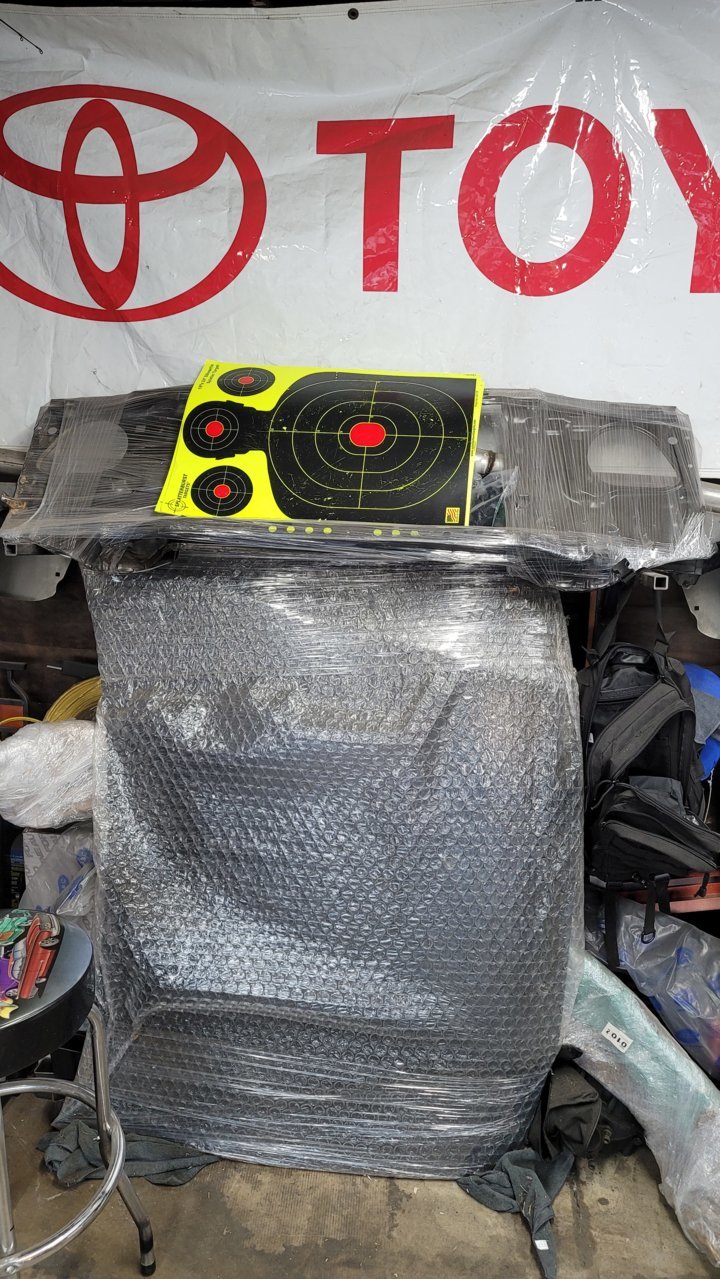

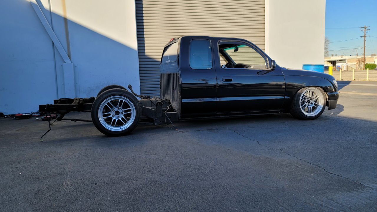

    Well it happened a little sooner than expected but the truck is in full build mode now lol
    Replaced my trashed bed
