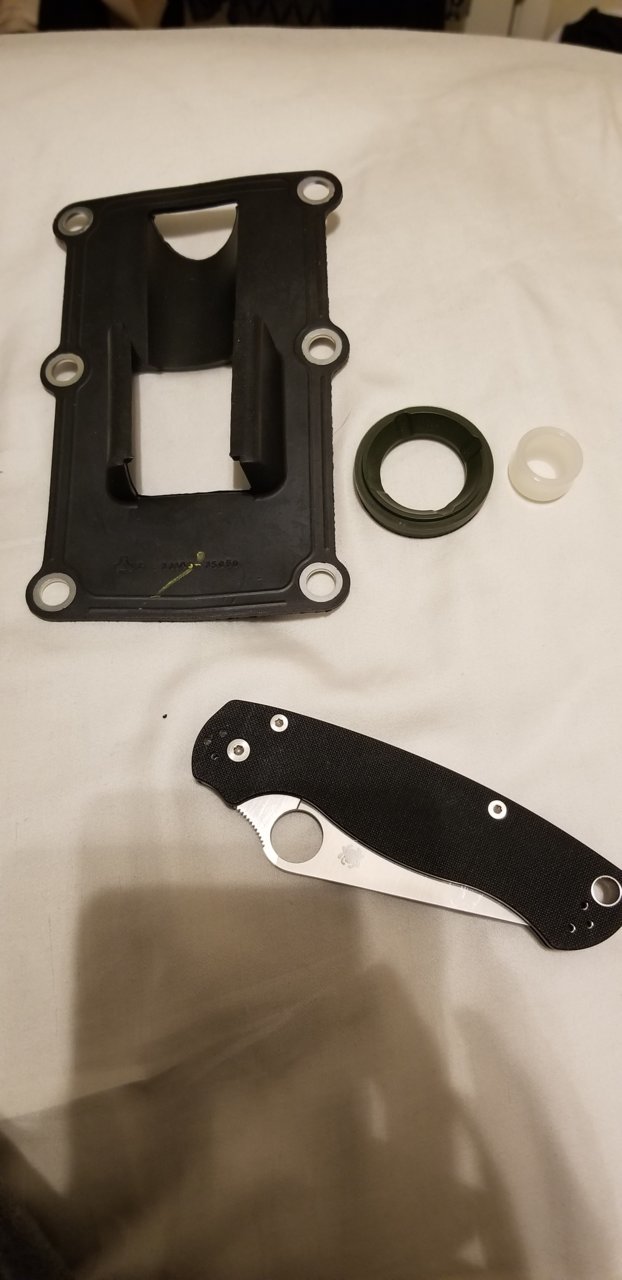

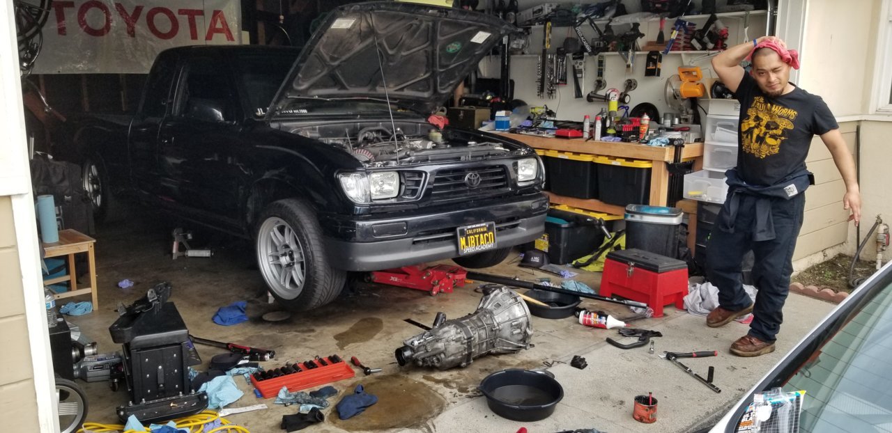

    So I've had a leak for a while now. Every time I park the truck I find a small puddle where the tranny and block meet up. I figured it was the rear main seal. So we dropped the tranny swapped out the rear main seal and while installing the tranny we noticed a leak coming from it. So I resealed the tranny and we'll get it back together once the silicone cures.

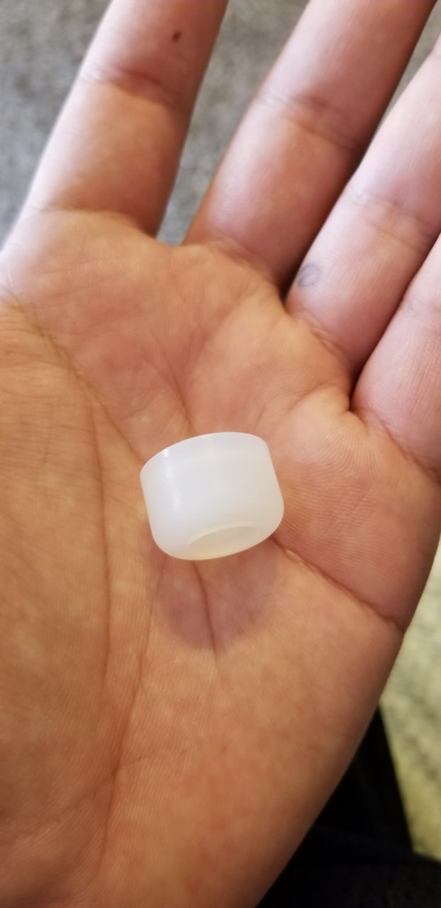

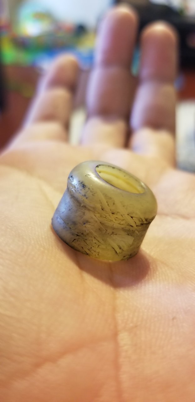

    Thought I'd show a before and after of the call cup bushing.
    Before
    After

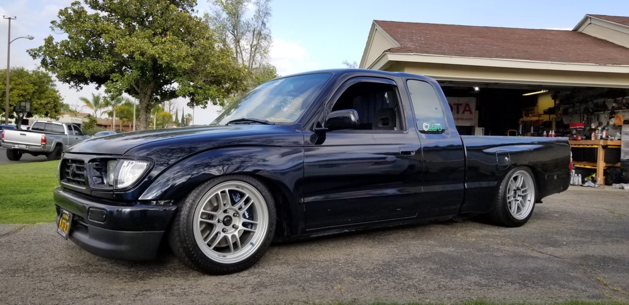

    What size is the center bore.? Did u have to modify or get hub centric rings to fit the Tacoma .??

    What's up bro responded to you on YouTube but I'll put the info here too.
    Center bore is 67.1mm and the size and offset rpf1's I have came with the correct center bore.

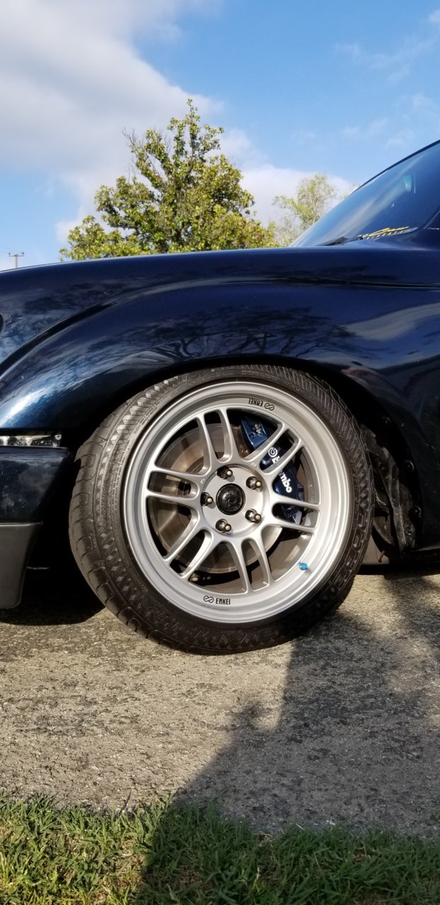

    Truck is finally back together.

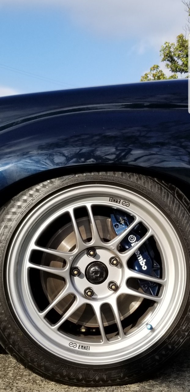

    A little close up of the calipers behind the wheels.

    Thanks for replying everywhere .! I’ve searched everywhere. The only ones I can find are 73 center bore. I may have to run a hub centric rings

    That's weird I just looked and found the same thing. I got mine a couple years ago not sure if they made a change or I just have my information wrong haha.
