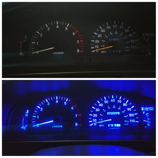

    Installed some led bulbs in my cluster today. Here is a before and after shot.

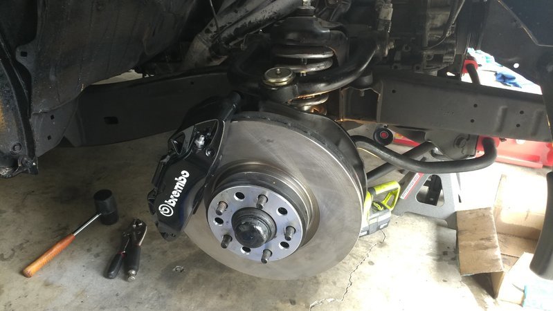

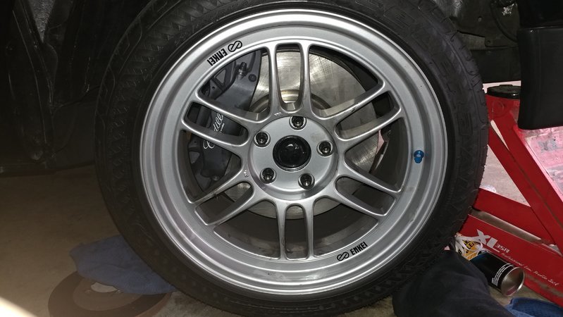

    The big brake kit is one step closer to completion.

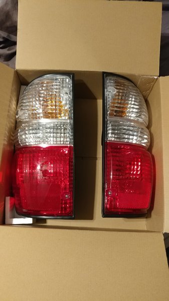

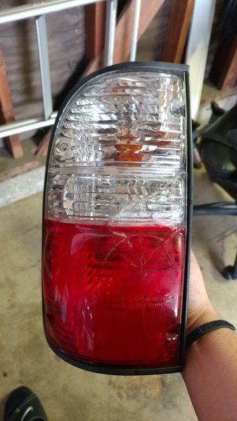

    Had a broken tail light for the longest time cuz some idiot decided to back into my truck in a parking lot and not take responsibility for it. Still need to fix the dents he/she made but thats much more expensive lol.
    The price of the red/clear tail lights sky rocketed for some reason and i couldnt find em under 120 anywhere. Finally found a set under 100 so i picked em up.
    Broken light that i glued back together lol
    Replacement lights

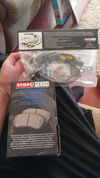

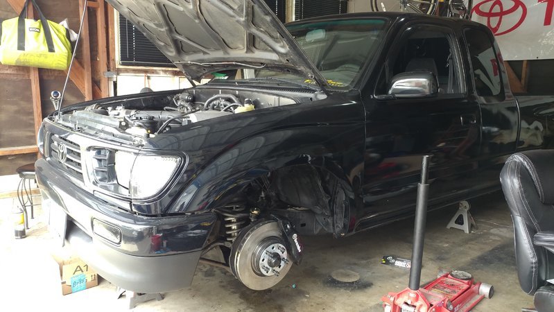

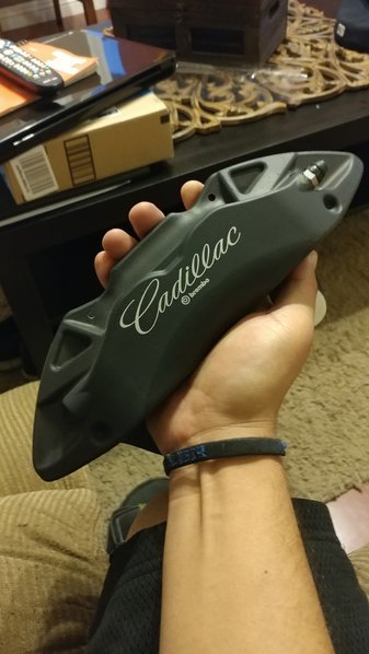

    For years people have made big brake kits for the 5 lug first gen tacomas but no one has ever offered much info or has used all custom parts that cost an arm and a leg. My goal with this was to find stuff that can easily be obtained at a decent price and share all the information i gathered openly. By pure chance i found these calipers that line up perfectly with the stock spindles. I have yet to finish the kit completely but ive mounted enough to share my findings so far. I still need to gather more information but this is about 95% complete. Hope this can help some people out. Also this will require a minimum 17" wheel. It will also depend on width and offset as well. My 17x9 +35 enkei rpf1s cleared with no issues.
    Here are all the parts i used. I have yet to confirm that the brake lines will work for this application. So if buying these parts please wait until i confirm that they work properly.
    Also please note that the Amazon links below are linked to my partner account so i will net a small commision if purchased from that link. It doesnt cost you anything and i have listed all part numbers if you choose to search elsewhere for lower prices. But this is the lowest price i was able to find myself.
    Disclaimer: the price of the calipers fluctuates regularly. The prices i have listed below are what i paid at the time i purchased them. You may have to wait for the price to drop to get the best deal.
    As stated in the title the calipers mount directly to the stock mounting location on the stock 95-04 tacoma spindle. BUT the holes will need tobe drilled out to accept the larger bolt that the caliper uses and slightly shimmed out to align it with the rotor. I will list the drill bit size and shim size later when i have access to it again.

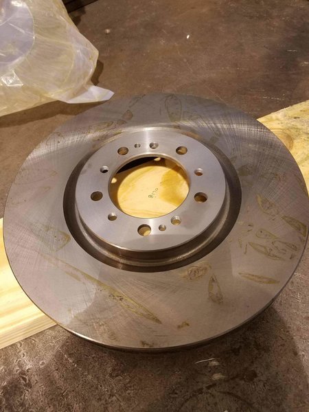

    For the rotors (Evo 9 Front 12.6") those will need to be machined to fit the tacoma hub assembly. The center bore needs to be bored out and the mounting holes drilled and tapped to accept the stock hardware used to mount the hubs. I have attached a picture showing the modifications made.
    According to the specs i found online the steel braided brake lines listed SHOULD work with the tacoma hard lines but like i said i have yet to confirm that so please wait on that. If anything the lines will be a little longer than needed but some creative routing solves that issue. Thanks to jose matos for confirming that.
    Summary of parts
    Cadillac ATS Brembo Calipers
    Cadillac CTS-V Brake Pads
    Mitsubishi Evolution 9 Front Rotors
    Subaru WRX STI Front Brake lines
    Brake Parts
    Driver Side Brembo Caliper
    PART #: 172-2586
    COST: $104.14
    http://amzn.to/2j08DwK
    Passenger Side Brembo Caliper
    PART# 172-2587
    COST: $113.71
    http://amzn.to/2j9BgCU
    Caliper Hardware Kit
    PART #: 18K1971X
    COST: $18.58
    http://amzn.to/2kn8Zy0
    StopTech Steel Braided Brake Lines
    PART#: 950.47006 $52.02
    http://amzn.to/2jsw7qO
    StopTech Street Performance Brake Pads
    PART #: 309.10010
    COST: $54.18
    http://amzn.to/2jsyWYM
    StopTech Blank Rotors (Evo 9 Front 12.6")
    PART #: st121.46064
    COST: $103.79
    http://www.czeromedia.com/index.php/product/evo-89-stoptech-rotors/
    Total: $446.42
    Cost of rotor machining depends on what your machinist charges you.

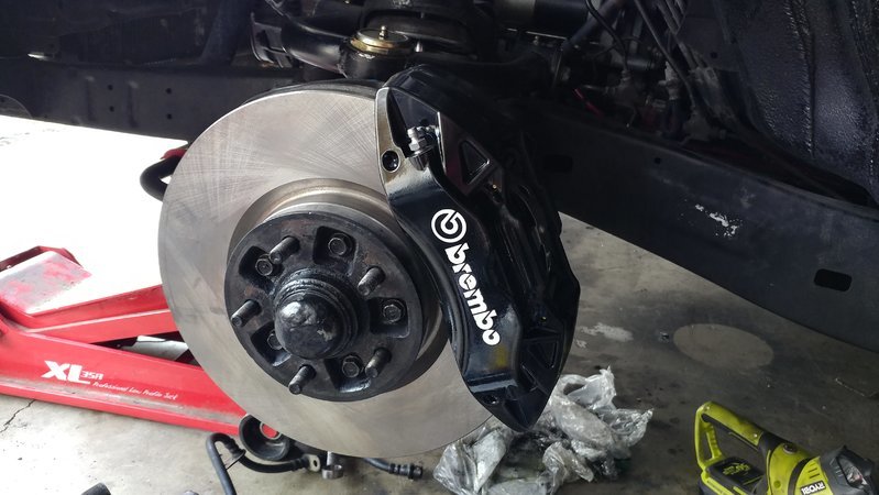

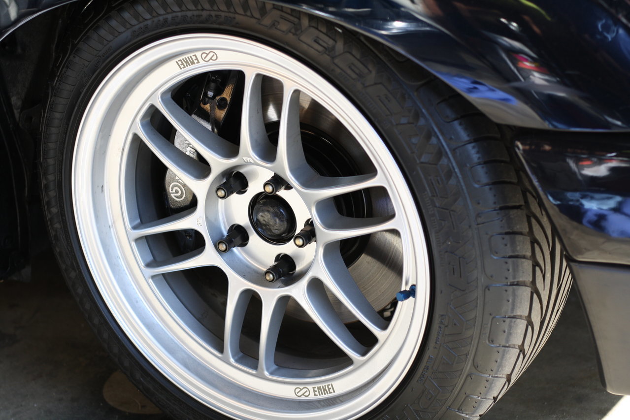

    Well i finished the install and all rhe parts listed worked. Here are some finished pictures.

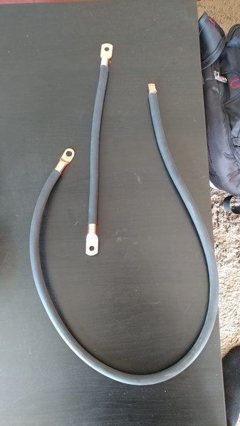

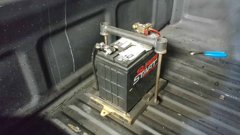

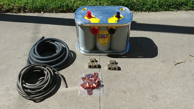

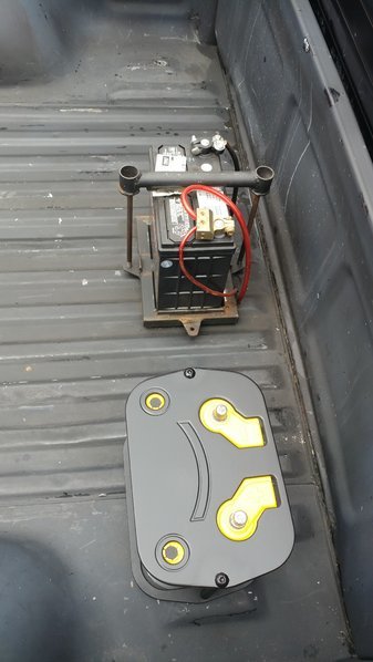

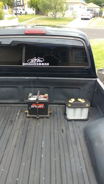

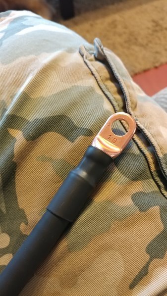

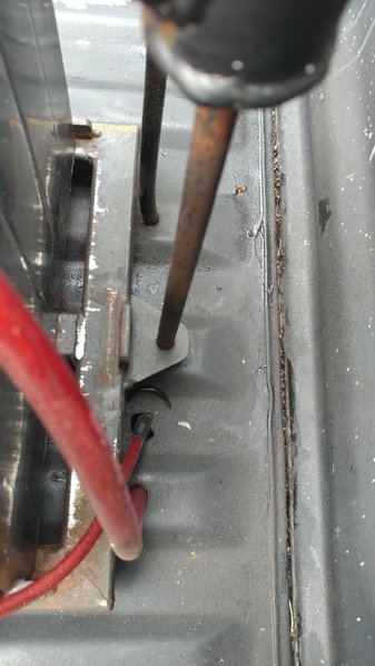

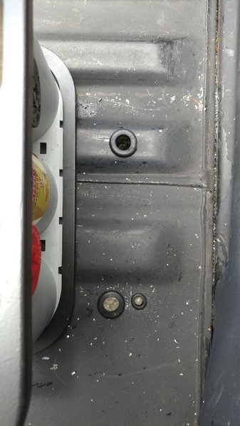

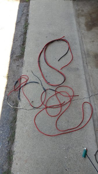

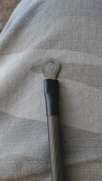

    So I decided to upgrade my battery and also slightly relocate it. This was my old setup I had made years ago to fit a smaller battery cuz thats what i had at the time. But the battery wasnt very good and the cca's were lacking. The install was also kinda janky lol i did it almost 10 years ago.
    Here's everything i used for the upgrade and relocation. The battery is an Optima D34/78 Yellow top. 1/0 welding cable for the battery, and block grounds, also the power wire to the starter. I also upgraded the wire from the alternator to the fuse box, and the wire from the fuse box to the battery with 8 guage wire. Ended up using the same 8g wire to upgrade the ground wire from the head to the cab. Also just a generic optima specific billet battery tray i found on ebay for under 50 bucks.
    Here are the ground wires i made
    And heres a comparison of the wires i used on the old battery and the new 1/0 cable.

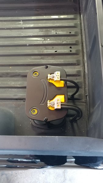

    Here you can see how i moved the location of the battery over to the right corner instead of in the middle. I didnt think it through when installed it so long ago and lost use of the center of the bed with longer stuff. So i put it out of the way and also offset some weight which should help with the dreaded "taco lean"
    Here you can see how shitty a job i did on the previous install lol.
    The old garbage wire. Haha
    The new install is a lot cleaner and i actually used grommets through the bed this time. Yes i know stupid mistakes lol.
    All in all the upgrade was well worth it. The truck actually cranks up like normal now. And i wont be worried about adding any accessories in the future.

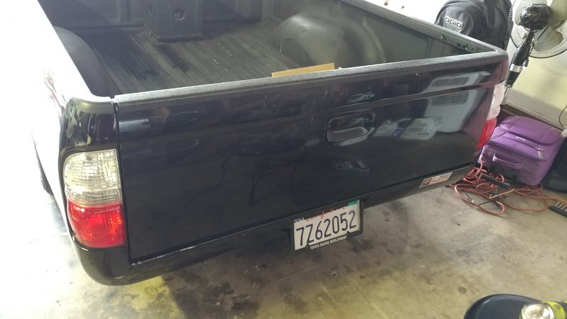

    I have to ask, what kind of rear bumper is that? I really like that flush with the body bumper and I can't find info on it anywhere. I'm restoring a 5-lug and I'd love to do something like this.
  19. Mar 8, 2018 at 4:01 AM
    #79
    mjbtaco
    mjbtaco [OP] low and slow
    Mar 21, 2008
    #5423
    4,684
    Michael
    Montclair , so cal
    Turbo'd 95.5 extra cab and 2013 Silver DCSB TRD Sport
    PERFORMANCE Custom Turbo Setup FRONT SUSPENSION Drop Spindles by Aaron Carswell 01-04 Swaybar Endlinks Energy Suspension Endlink Bushings Cando Upper Control arms QA1 coilovers with 8" spring Custom 4 pot Brembo BBK Modified lower control arms with mjbfab qa1 mounting plates and Poly bushing sleeves REAR SUSPENSION Chasis Tech drop leafs QA1 adjustable shocks weld in drop notch Gas tank cross member bridge 3" angled blocks 2013 Double Cab Short Bed TRD Sport Eibach Pro Truck Shocks front and rear Lifted to the 3rd setting on the front shocks
    They're called roll pans. Not sure what brand mine is but if you just search for Tacoma roll pans you'll come up with something
  20. Mar 8, 2018 at 4:04 AM
    #80
    BartMaster1234
    BartMaster1234 American Auto Horns
    Aug 21, 2016
    #195197
    45,641
    Tyler
    San Francisco, California
    Flux Capacitor
    Thanks! How does it mount to the truck?
    Can you still access the spare tire?
