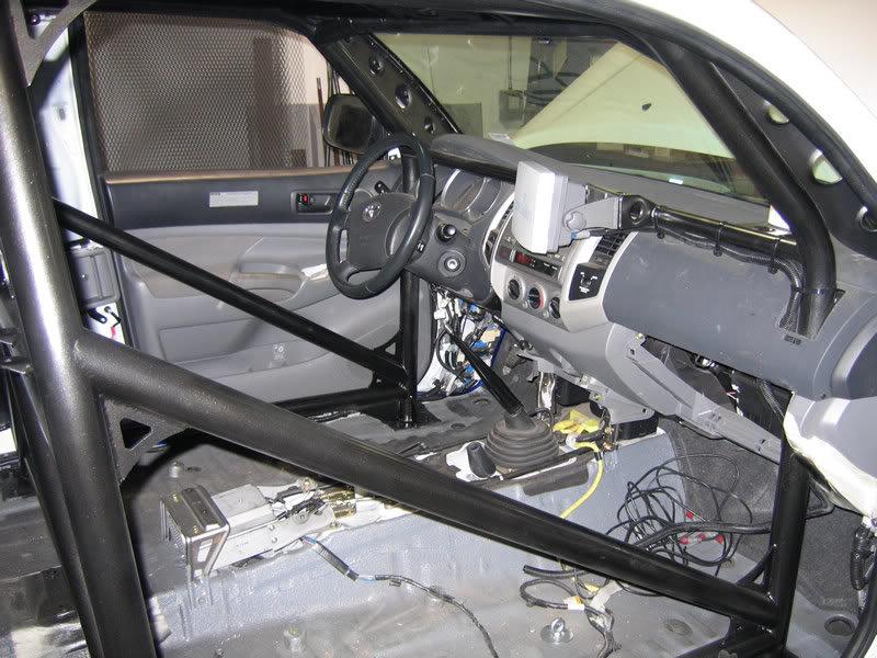

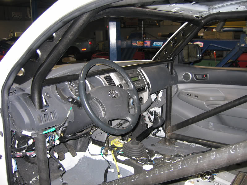

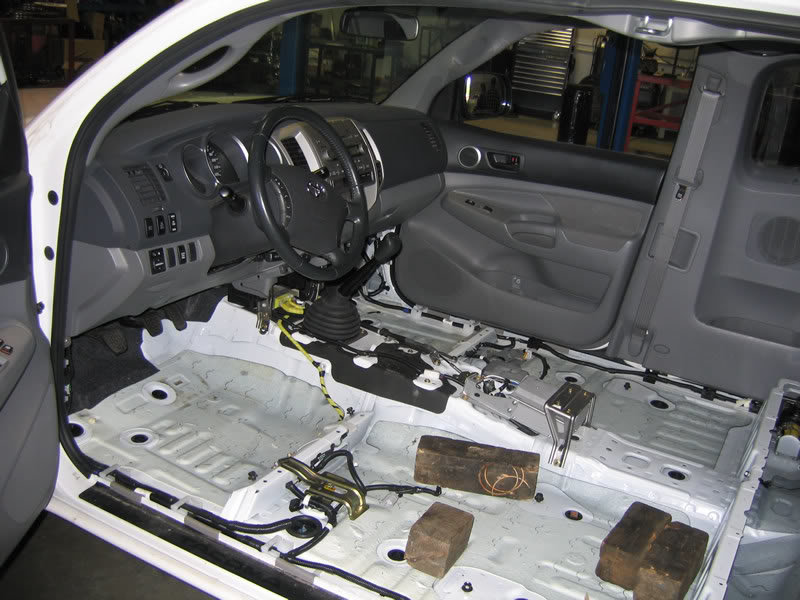

    Then the interior went away.

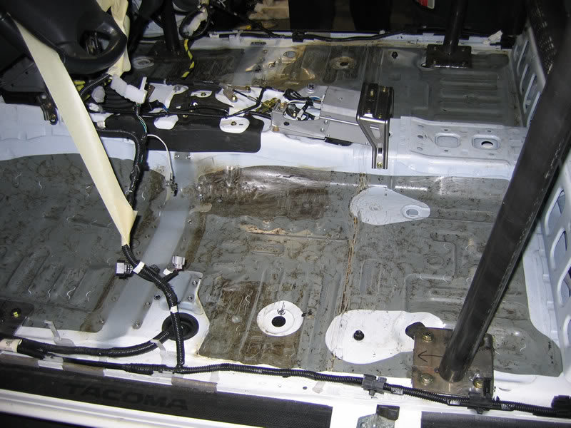

    And the padding on the floor to prep for bedliner.

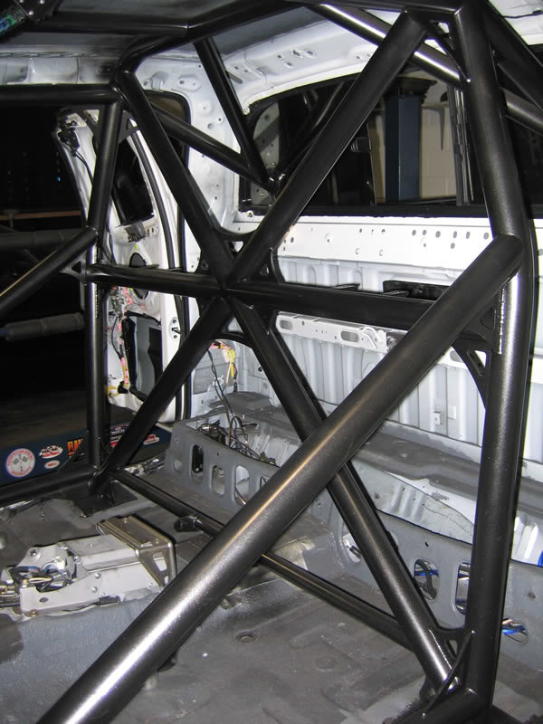

    The rollcage is made from 2" .120-wall chromoly.
    The cage is tied into the frame under the floor of the cab.

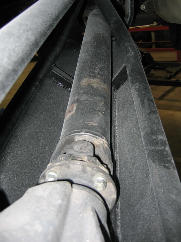

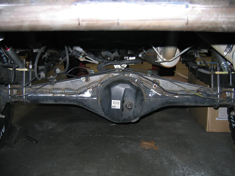

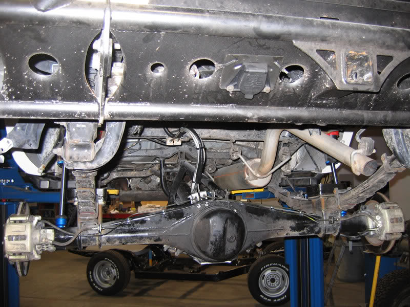

    The rear axle is gusseted.

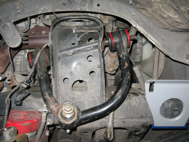

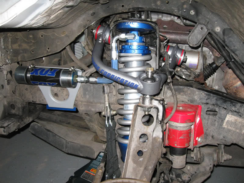

    Front suspension, mark 1.

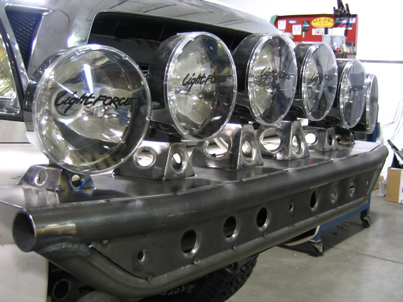

    Lots of lights up front. After testing at Barstow I can see why people put far more than this on their rides!

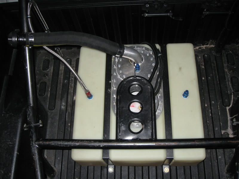

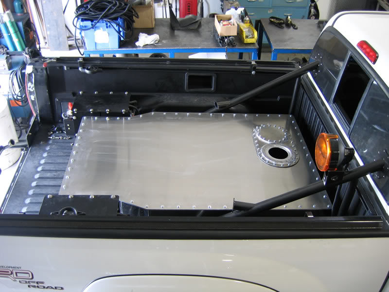

    The can for the custom 60 gallon fuel cell.

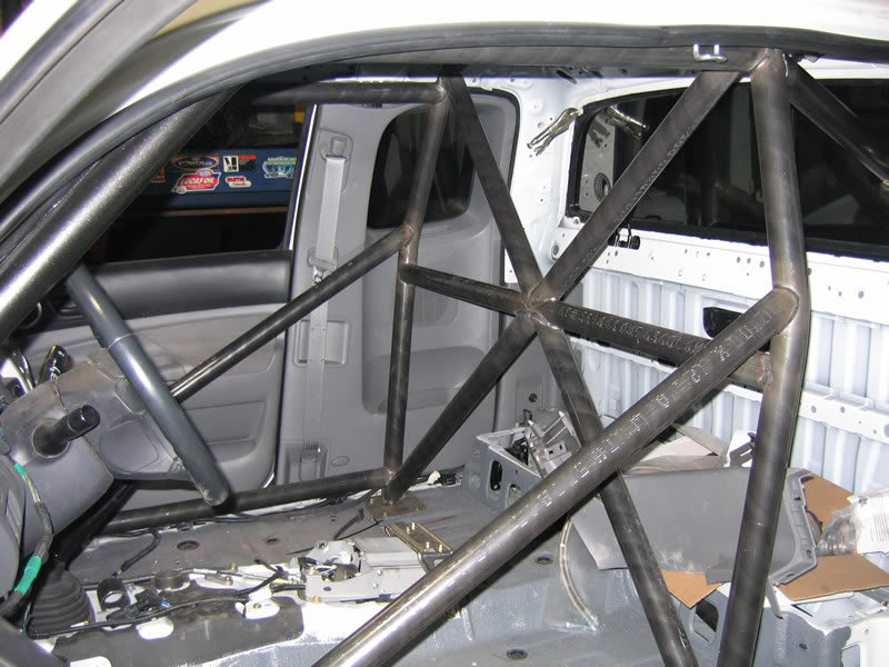

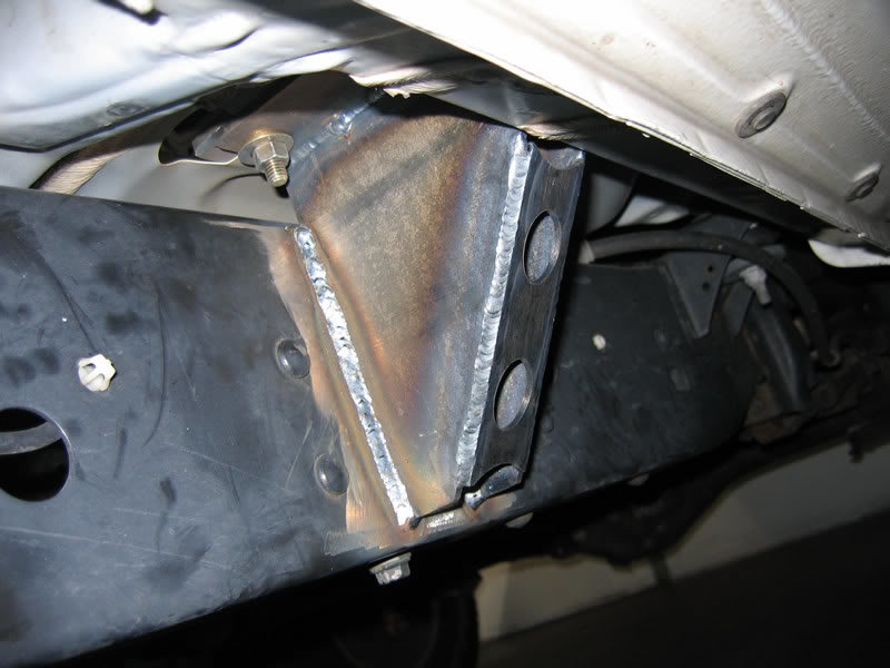

    The rollcage is gusseted per SCORE rules.

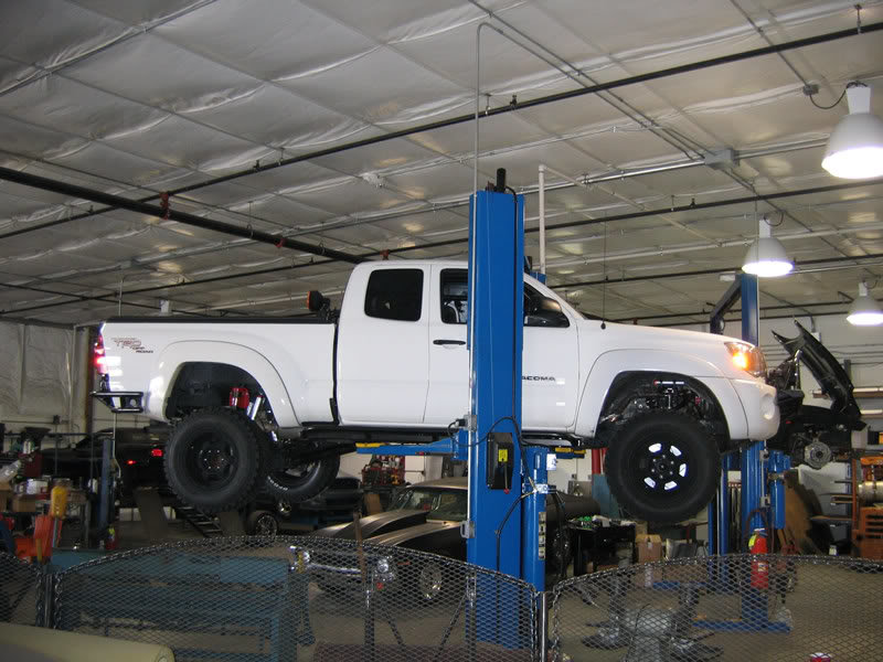

    Up on the lift it was easy to see the amount of suspension downtravel.

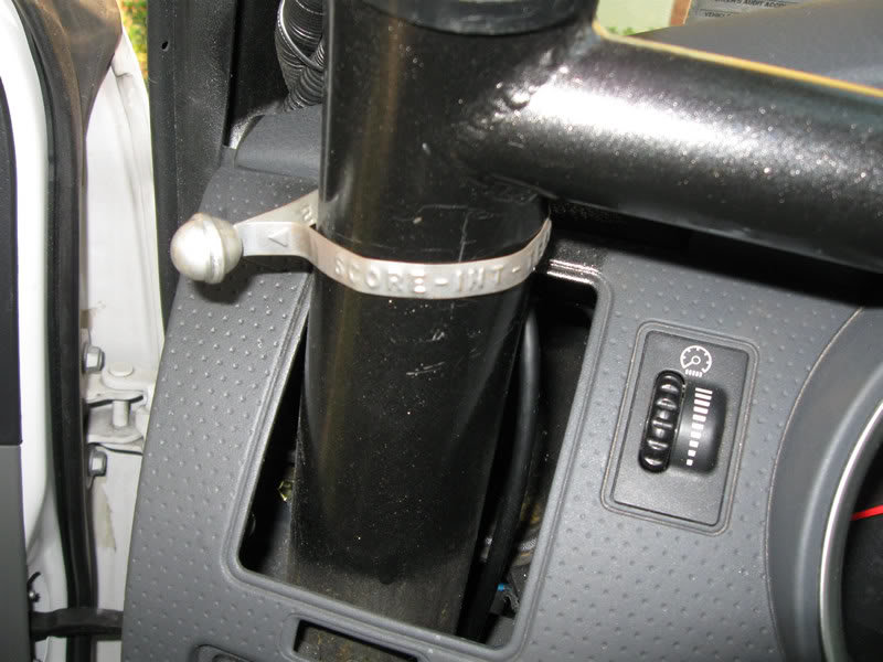

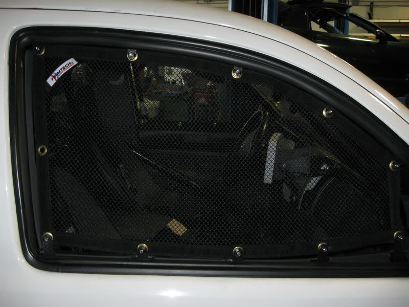

    The custom window nets leave the windows functional.

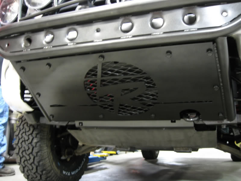

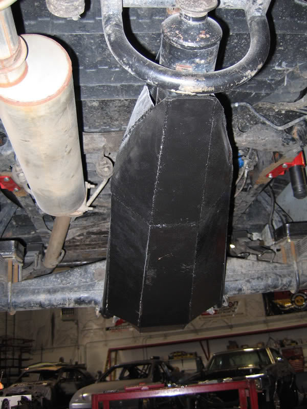

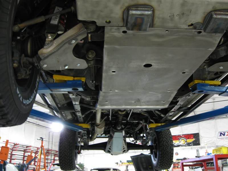

    Budbuilt skidplates, custom driveshaft armor, Total Chaos lower control arm skids.
    The Liberated Racing logo is waterjet cut into the front bumper skid.

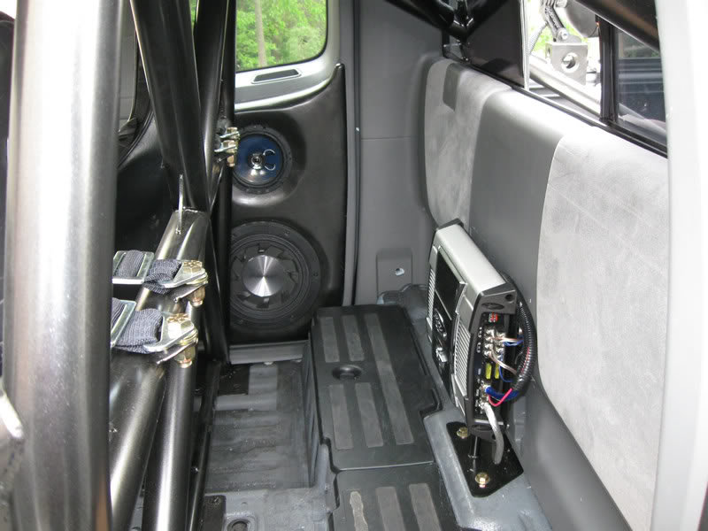

    I've got tunes for when I'm just cruising around.

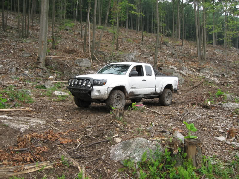

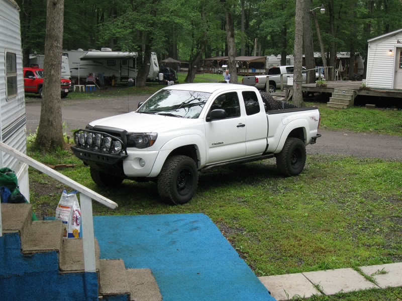

    Here's the truck before the first round of testing at Rausch Creek in PA. Rock crawling brought some interesting shortcomings to light.
    That's it for now. I'll post test results and the resulting modifications another day. :)

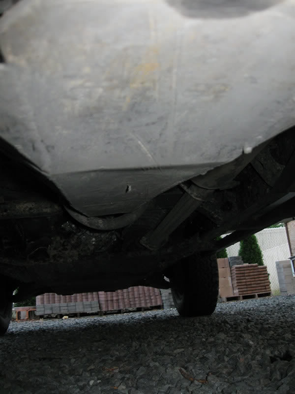

    I left off on my way to Rausch Creek for testing....
    Since my aluminum fuel cell was (is) still at FuelSafe having the custom bladder made, this Jaz fuel cell was bought, modified, and installed so I could use my truck.
    Crawling was a great way to work the suspension in a controlled manner without really thrashing anything. Still, lots of stuff took a beating.

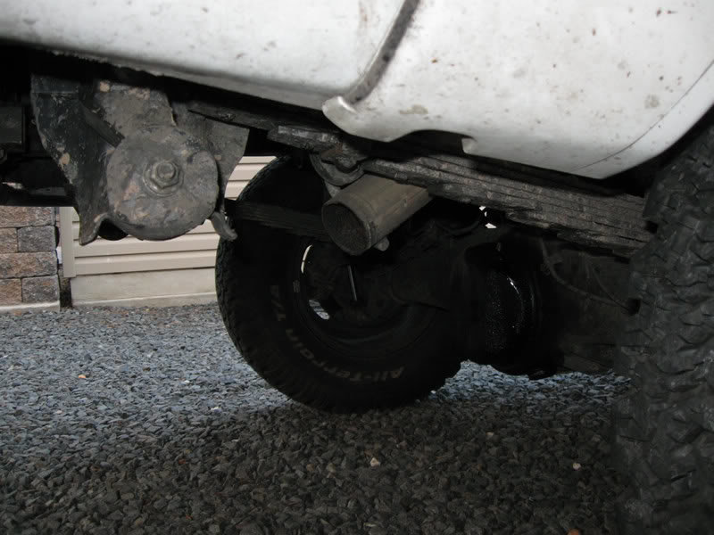

    I had preemptively cut my exhaust before the trip so it wouldn't get smashed up on the rocks. It was a good call.
    The driveshaft armor took a hell of a beating and actually dented to the point that it would rub the driveshaft.
    The thin sheetmetal was removed and replaced with 1/4" sheetmetal and reinforced with some square-tube stock to keep that from happening again.

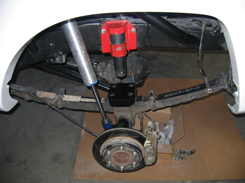

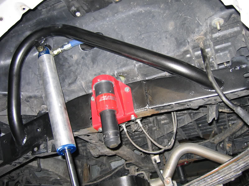

    I also had an issue with the rear disc brake conversion kit. The calipers rubbed the shocks bad on the driver's side, so the rear shock mounts were redone and some 2.5" reservoir shocks were swapped in.
  17. Dec 2, 2008 at 5:30 PM

    While updating the rear shock setup, the brake lines and wires were re-routed to the center of the axle, bundled with a length of cable, and run to the rear axle as a single unit with plenty of slack. This would make it less likely for debris to kick up between the axle and bed and take out something critical. In the event something did get up there, the cable would take the strain and hold things in place.

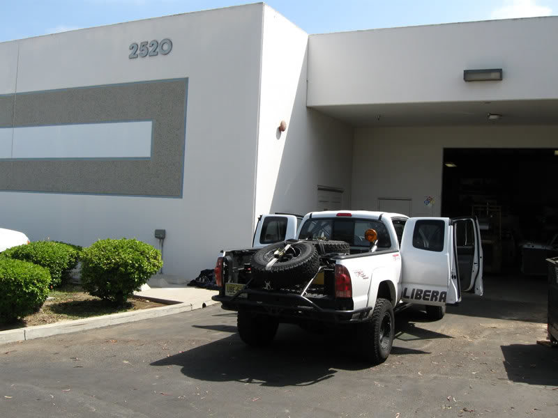

    After fixing stuff it was off to California for SCORE tech inspection.
    I passed. :D
    While out there I met up with some guys from TTORA and tested at Barstow, during which time I snapped an UCA, broke my front limiting straps, and wore out the front shocks. Once back home I started on more repairs/upgrades.

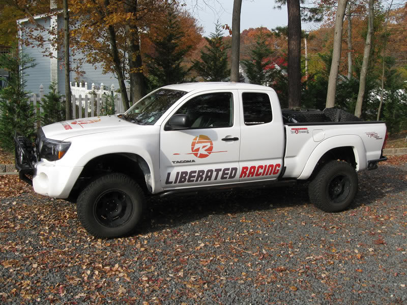

    Cosmetic stuff first, just because. I stickered up the truck before driving to CA for the sake of advertising. Once back, I installed some fiberglass fenders to avoid tire damage should I bang into something and mangle a fender during a race. I also installed the all-important TacomaWorld sticker. :thumbsup:

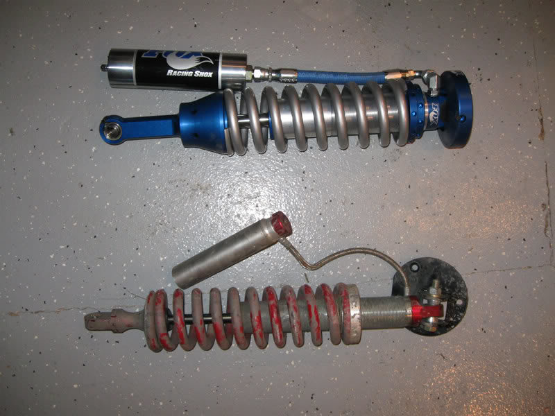

    Went from the 2.0" Walker Evans shocks to 2.5" Fox coilovers that I picked up at All-Pro while I was in CA.
    With new UCAs my front suspension looked something like this.
    On the passenger side where I had snapped the UCA I saw that the upper coil bucket had taken a hit. It would need to be straightened and reinforced.
    This is where my goal for the 2008 race ended. I had no time to make major changes to the suspension and test, so my sights are now on the 2009 season.
    I'm still making updates and will post updates as they happen. It's mostly going to be suspension and tuning this year. :)
