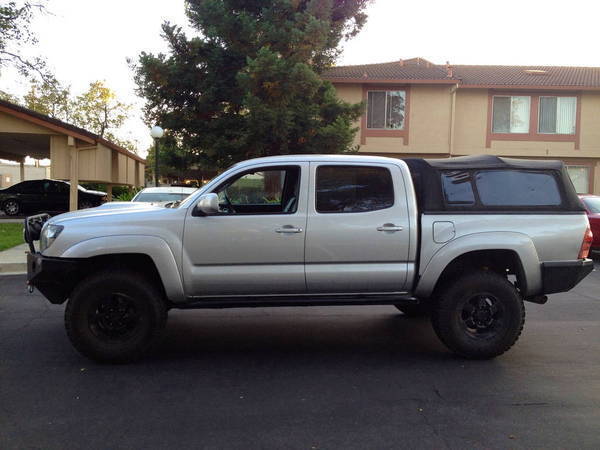

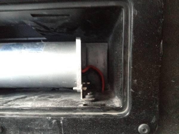

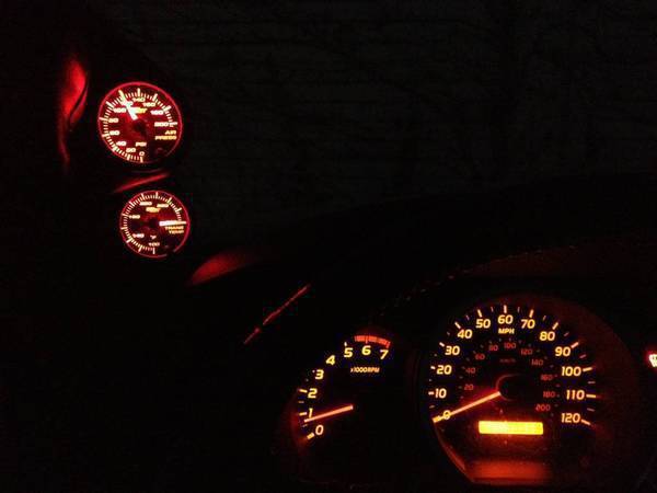

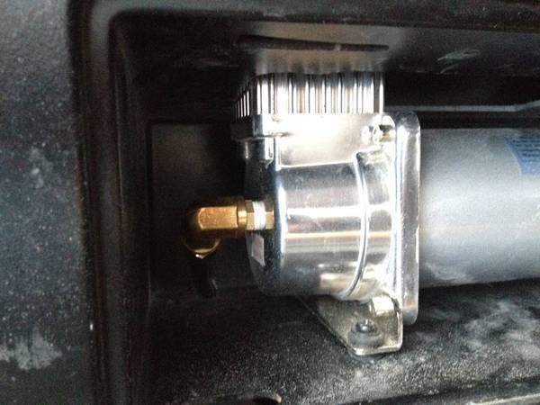

    finally got some pics of my OBA set up from the weekend
    Viair 450 compressor
    Viair 2.5 gallon tank (under bed where spare used to be)
    Viair pressure switch (on at 90, off at 120)
    Glow Shift air pressure gauge
    Lo-Tek a-pilar gauge pod
    Custom air coupler mounts on front and rear bumper
    I routed the power/ground and inlet air line underneath the cubby
    I also moved the rear air coupler from under the tailgate to behind the license plate
    (the front I just kept where it was)

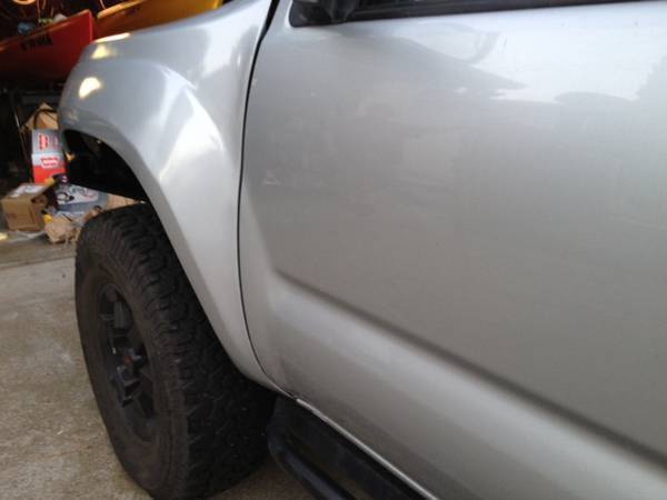

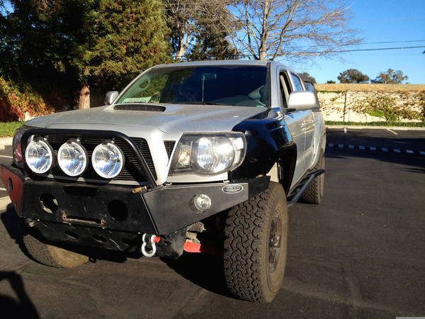

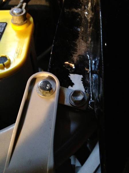

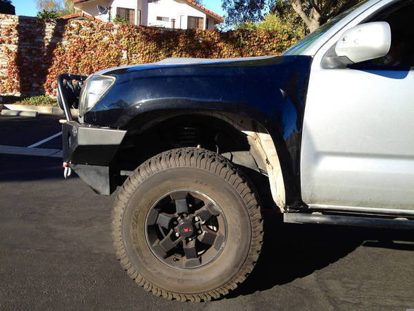

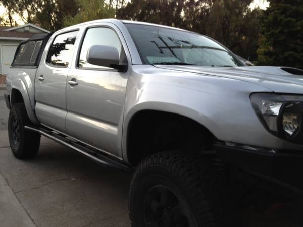

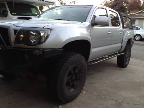

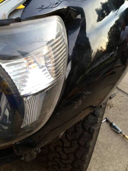

    I got a hold of some AP/Trailer Products fenders from CL (I think the guy is a member here too). He painted them OEM black, but didn't test fit them or drilled any holes to mount it. I wasn't sure how the fitment was going to be, so I didn't paint them prior (just in case I had to shave some off). They actually fit pretty good, I only had to trim near where my sliders were on the driver side. I also had to improvise with some of the mounting points.
    Before
    After
    Before
    After
    Some of the improvising I had to do
    I'm going to eventually paint them silver to color match the rest of the truck. Just a matter of when since it's kind of a PITA to take the fenders off. I have to take off the bumper/headlights/grille so I'm going to wait until I have another full day to tackle all that.

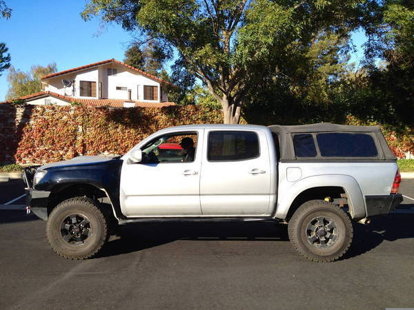

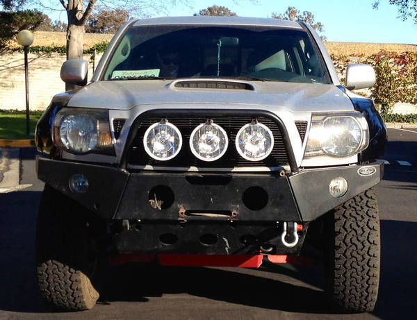

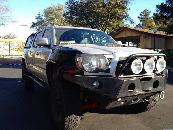

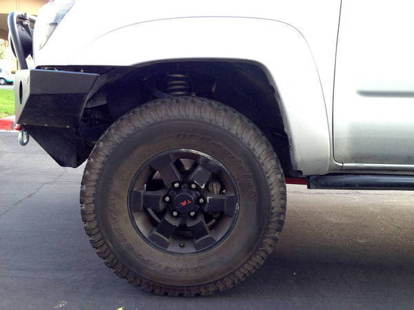

    Finally painted my fenders. I got the paint from automotivetouchup.com (thanks Ryan - 06RadiantRed). In all, I paid ~$80 shipped. 2 cans of primer, 2 cans of basecoat, and 2 cans of clear coat. This was the first time I've ever wetsanded anything, and I'm pretty impressed on how it turned out. The paint quality was awesome.
    I also painted the inner fenders flat black. It looks a lot cleaner that way.
    And I mount my new Warn M8000 winch :D
