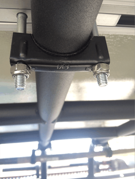

    Not really a mod, but thought I'd share how I mounted the RTT. I used 1-3/4" exhaust clamps, but I also put some velcro in between (the felt side), just so that it's not metal on metal. I painted it black, but that didn't really do that well near where the bolts are.
    When I have time, one of the clamps will have 2 eye bolts instead of regular bolts/nuts. That way I can slide a padlock through and secure the RTT. Saw another member on here do it and thought it was brilliant!

    Till I show up with a sawzall and cut the bolts off faster than it would take to unbolt them.
    You're just keeping honest people honest.
