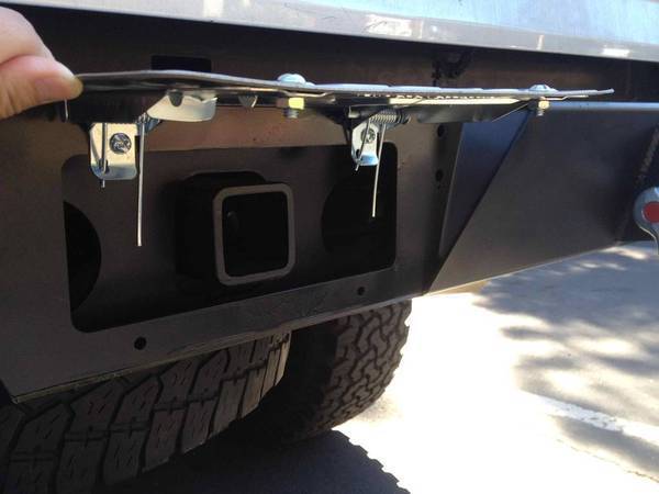

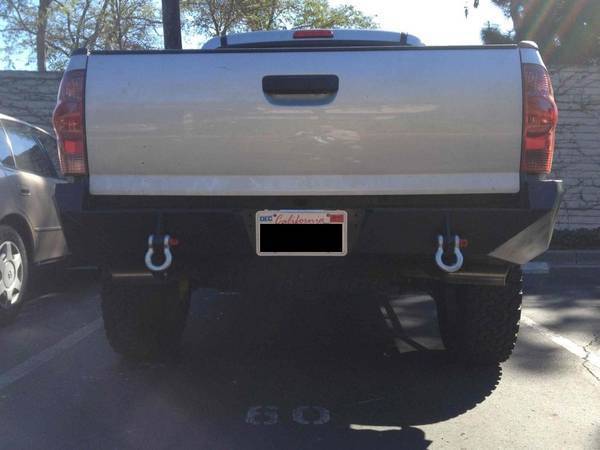

    Got some rear shackles and the flip up license plate holder
    a shot of the hitch
    and the clearance with the tailgate down
    I'm still waiting on the license plate lights from AP. And I'm thinking of different ways to hook up the OBA coupler. I also have to weld on a bracket underneath for the 7-pin connector since the one that's on there won't clear the 7 pin with the 33" spare

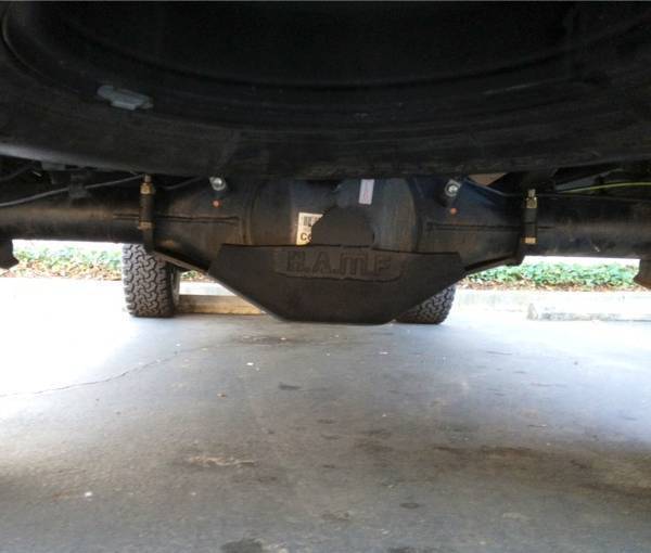

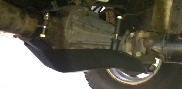

    B.A.M.F read diff skid

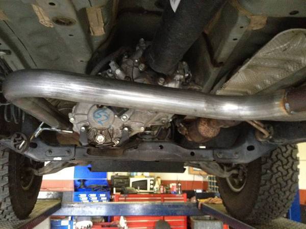

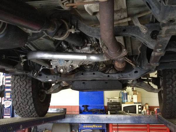

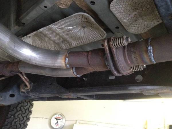

    Got some exhaust work done.
    After getting the new rear bumper and getting the 33" spare, I needed to reroute the driver side tail pipe
    Then rerouted the exhaust pipe near the transfer case
    After mocking up different ideas, decided to move the OEM y-pipe back some, so that everything after the y-pipe still has some independent play in case of movement
    Next up: T-case skid

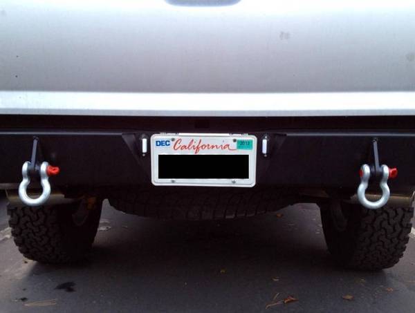

    Got a little more work done last night
    Finally mounted the rear air coupler. I positioned it so that it clears the bumper and still be easily accessible.
    tailgate down
    Got the license plate lights from AP. They came in chrome so I painted them black :D
    The 7-pin connector wouldn't fit on AP's bracket because of my 33" spare, so I had Jerry from B.A.M.F tack on a little tab on the outside, and used one of the holes from AP and drilled into the new tab.

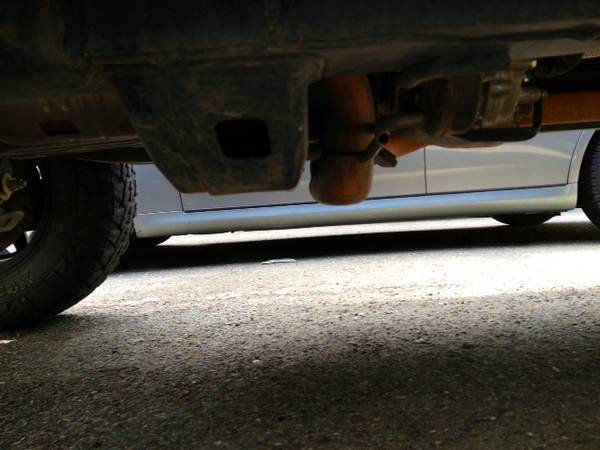

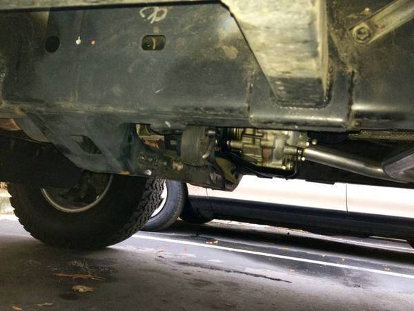

    Another shot of the exhaust relocation by the transfer case. You can see how much more clearance there is now
    Comparison pic (stole pic from sytfu510's truck)

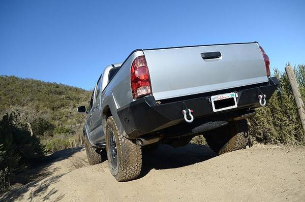

    Some pics of the other weekend at Hollister Hills SVRA
