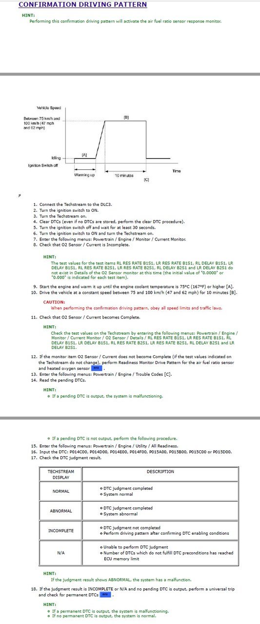

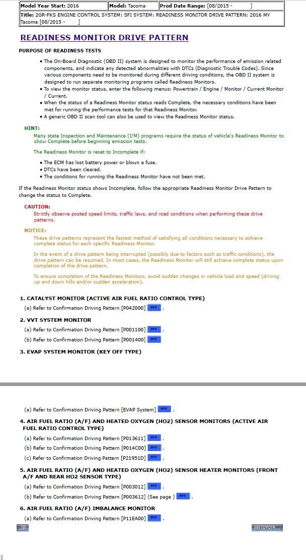

    Yes you can expect some minor power gains. Its just past the point of being noticeable but it definitely flows better. And as far as failing emissions goes I am not sure of Missouri's exact emissions laws but in Virginia where I am from we just have visual inspections only, where they raise the truck up on a lift and verify that the exhaust is connected and doesnt have holes in it and stuff. As far as they can tell, my sensors are in the right place, plugged in, and there are no simulators or anything like that plugged in, and there are no CELs so it passes emissions. FWIW it sounds great too, if you want I can post videos of my spec U full exhaust system.

    You will need the plug and play 02 simulator from URD when you run their y-pipe. It will keep the monitors “ready”. Because with out the cats and no 02 sim, you’ll set a check engine light and the catalyst monitor/02 monitor will stay “not ready”.
    02 sim will plug into the rear 02 sensors. The front 02s are A/F sensors and do not require simulation even if you are running long tube headers

    I do have a video somewhere but am on my phone right now and it's on my laptop, I will check later tonight. I can confirm it only deletes the secondary cats, and it does not effect emmissions control/monitoring system in any way. O2 sensors still in, no spacer or simulator needed!
