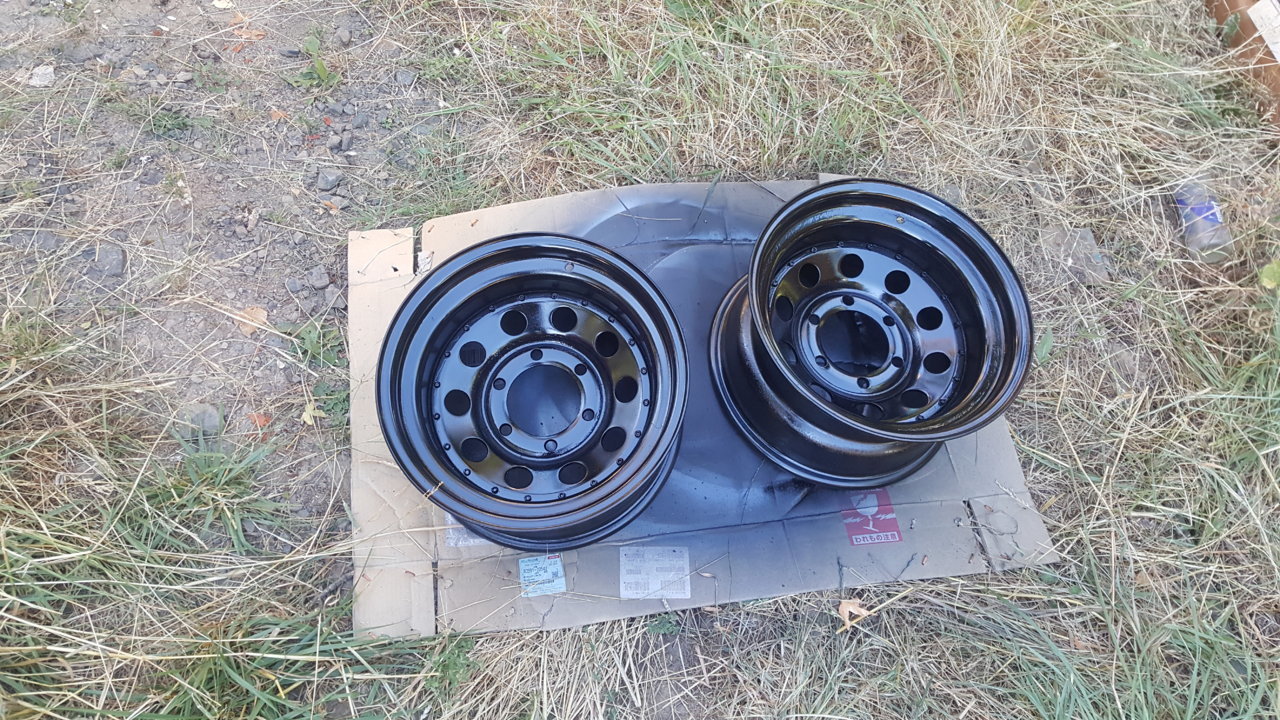

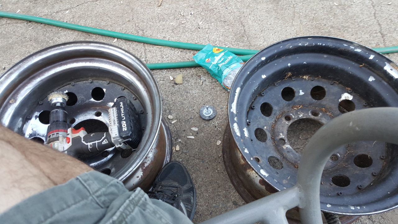

    Cleaning and painting the new wheels, I have ordered tires should all be together in a couple of weeks

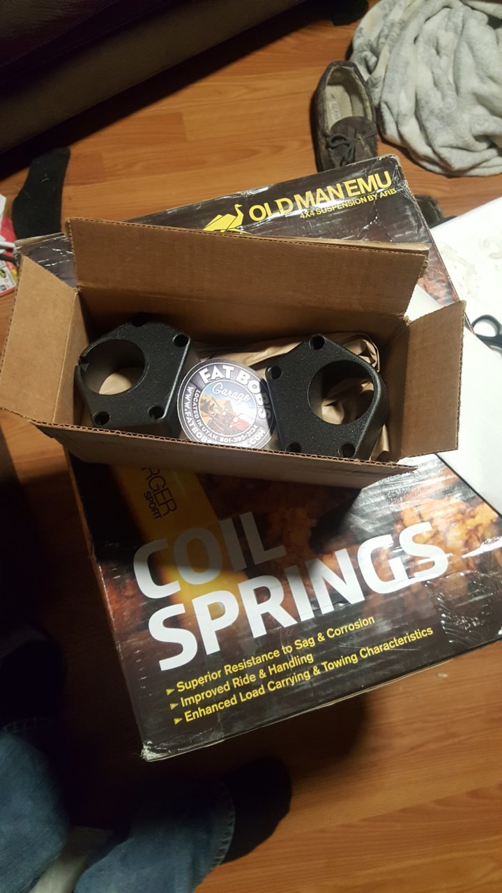

    Lift kit just came in the mail and tires might be here by friday

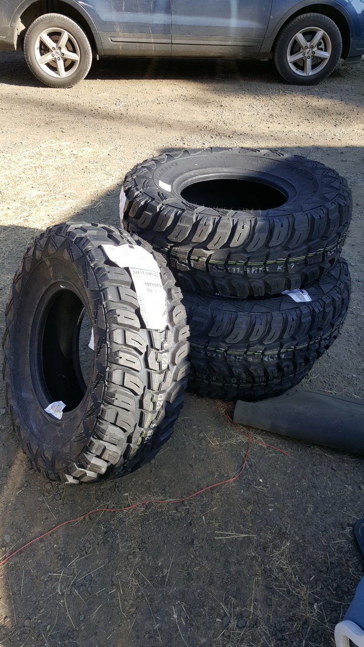

    Tires just showed up

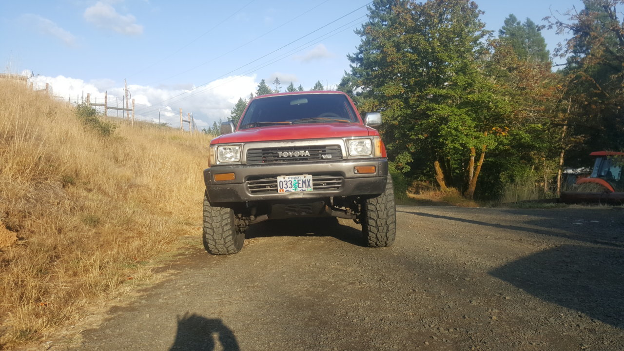

    So been busy

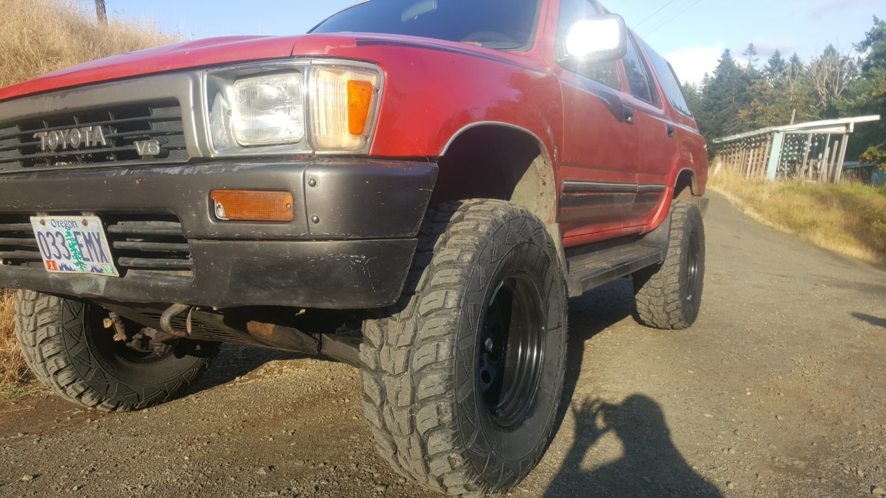

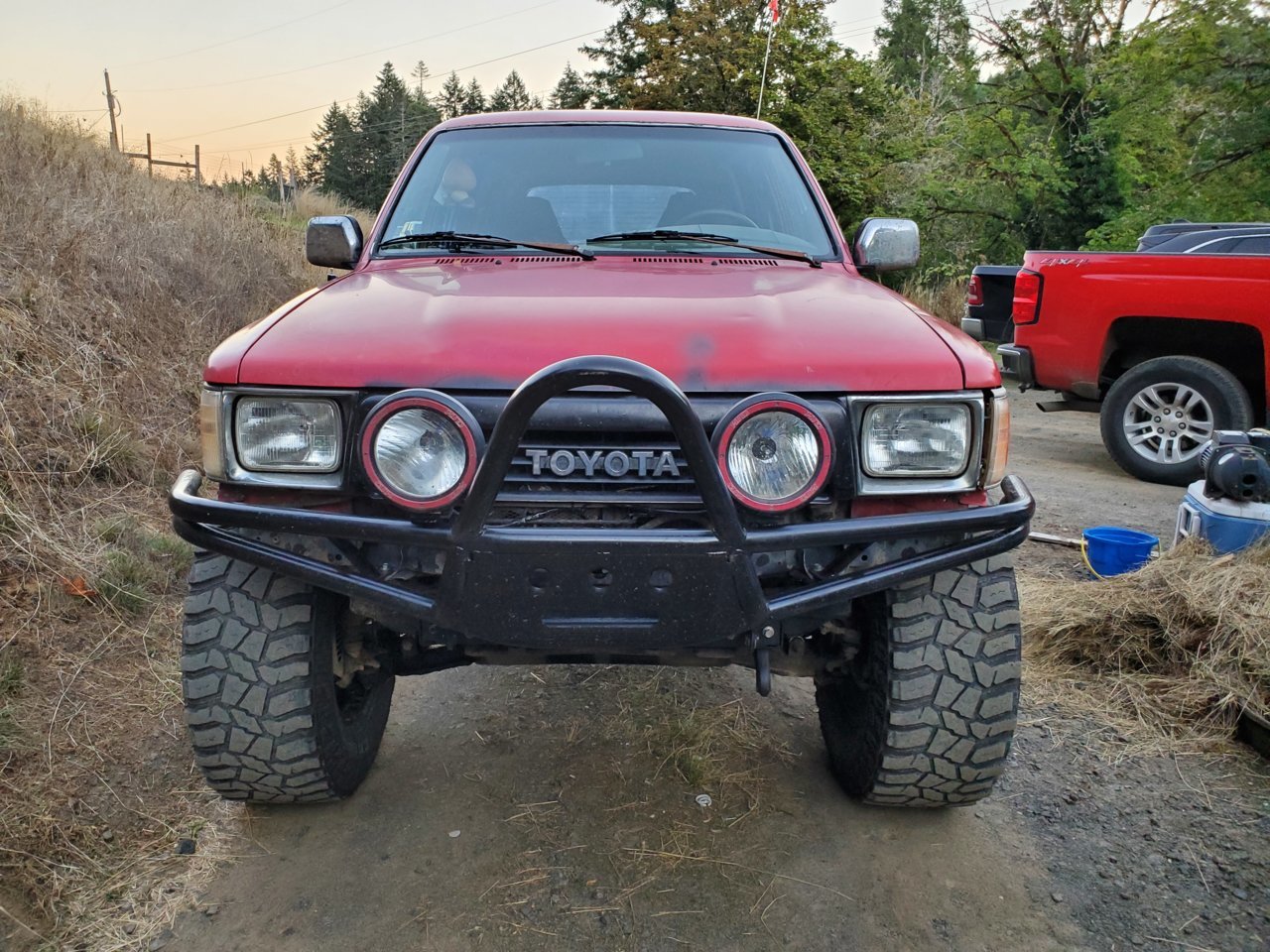

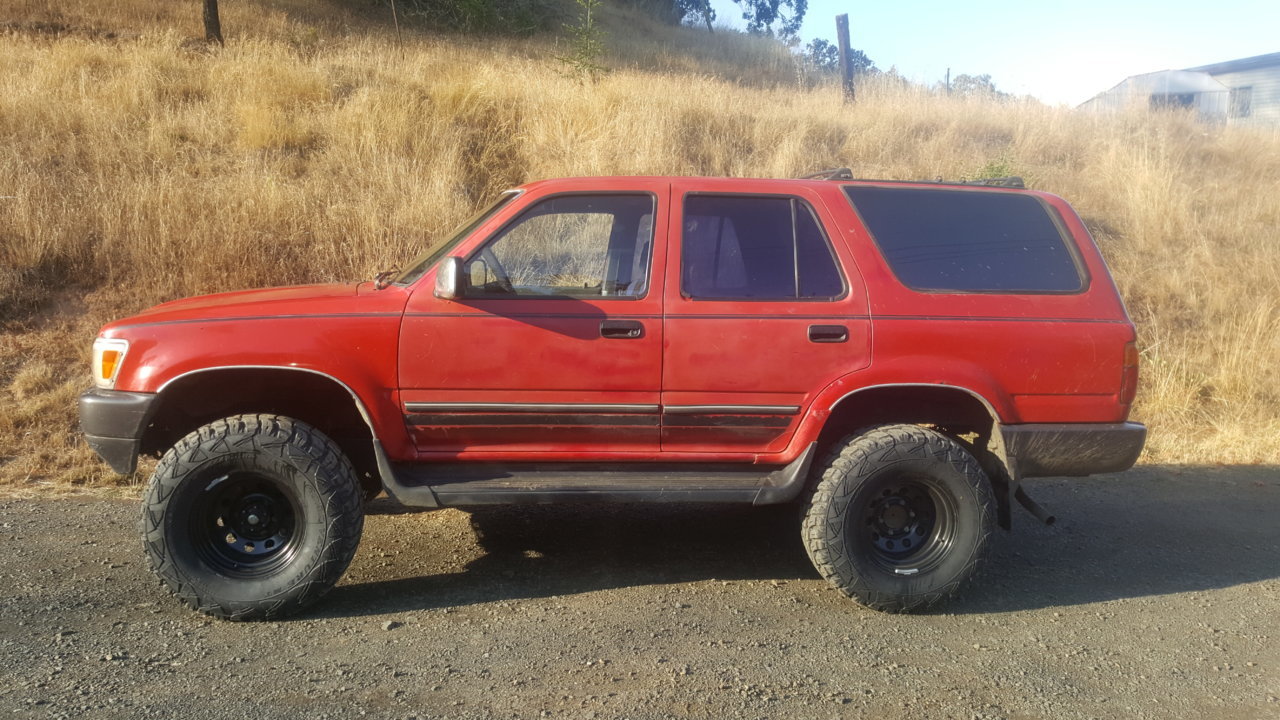

    Lift kit installed
    Wheels and tires installed
    Fixed a major trans line leak
    Flushed brake fluid
    Alignment
    Advanced timing to 15 degrees now it feels just like my 5vz

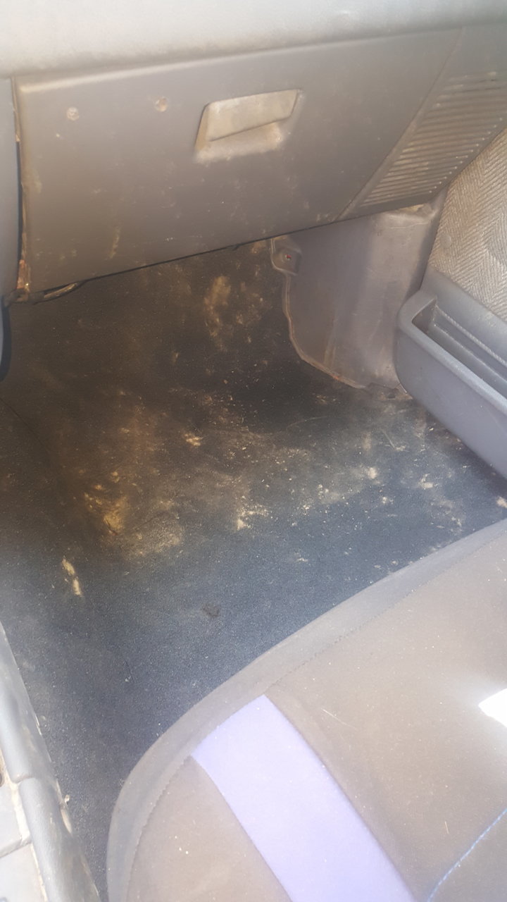

    I just put in the new floor and immediately got it dirty i dont have much pictures but I will upload more soon.

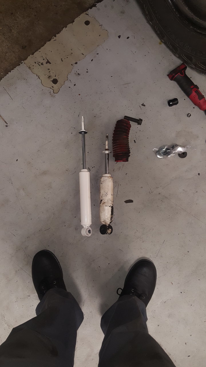

    Installed the new longer procomp shocks and while i was doing that i noticed that the exhaust crossover pipe was missing a nut and the other two were loose,:confused:. So one unexpected exhaust repair and 4 shocks installed

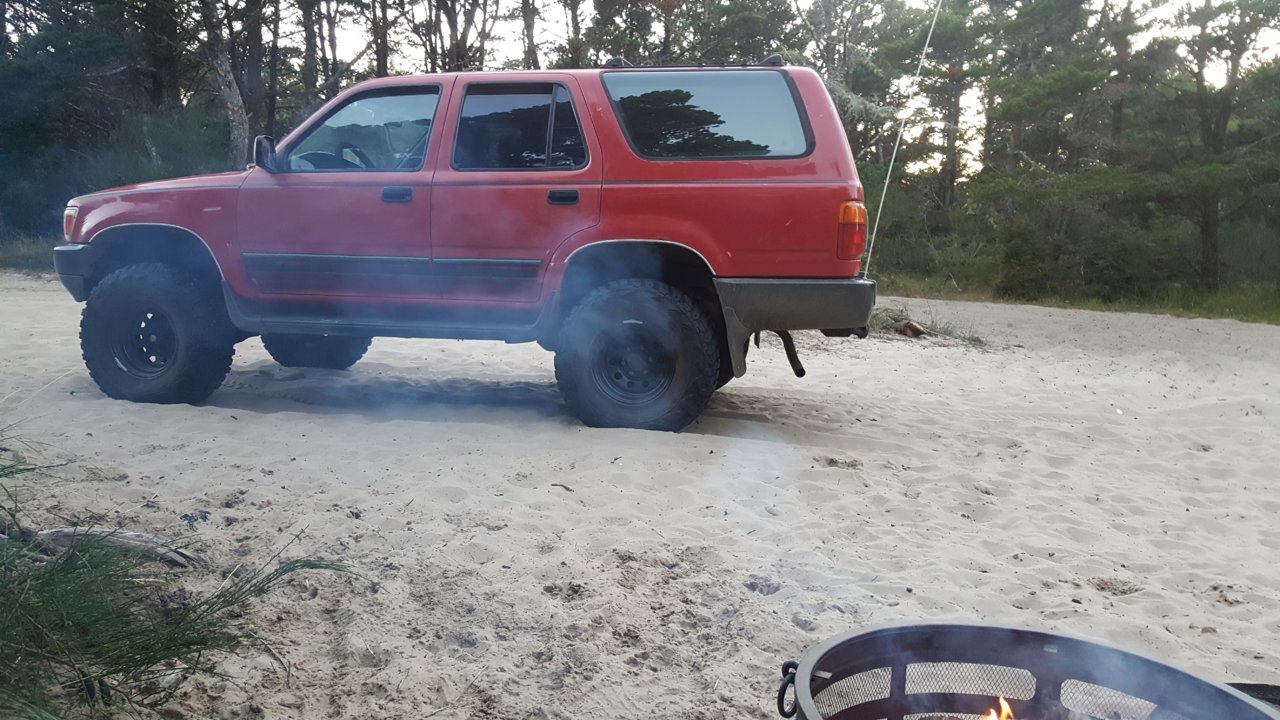

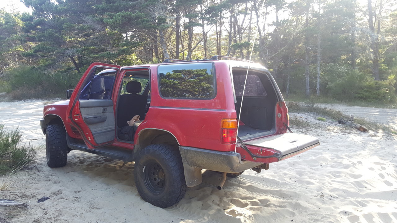

    Wife and I decided to do an unexpected camping trip to the dunes again with the 4runner, kind of like an experiment to see if it is trip worthy. We made it to the dunes its no problem about a 3 hour trip from home. Trekking around in the sand right after driving for 3 hours and first problem arouse AT oil temp light came on so we quickly found a spot to camp and let it cool down, now it hot dinner time and the dogs can run around.

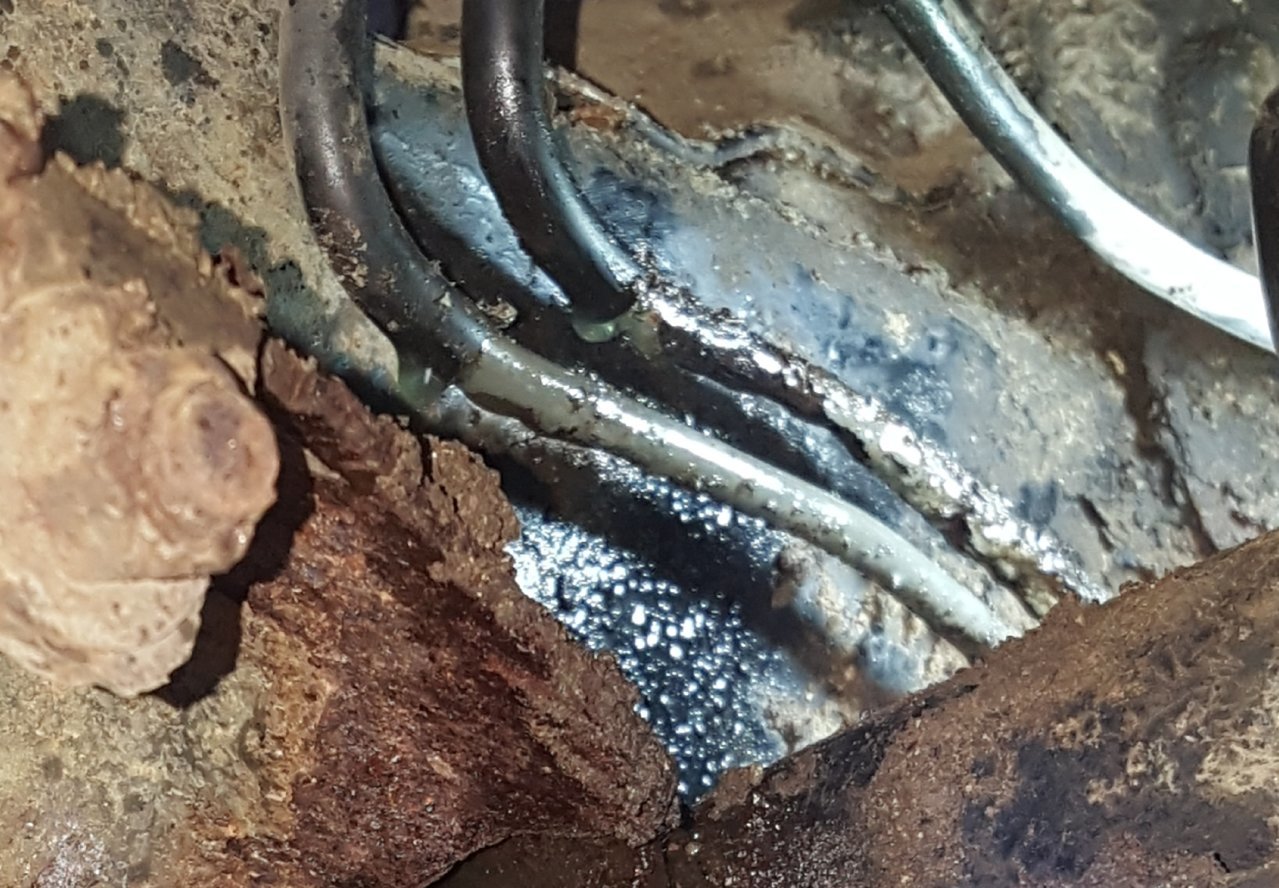

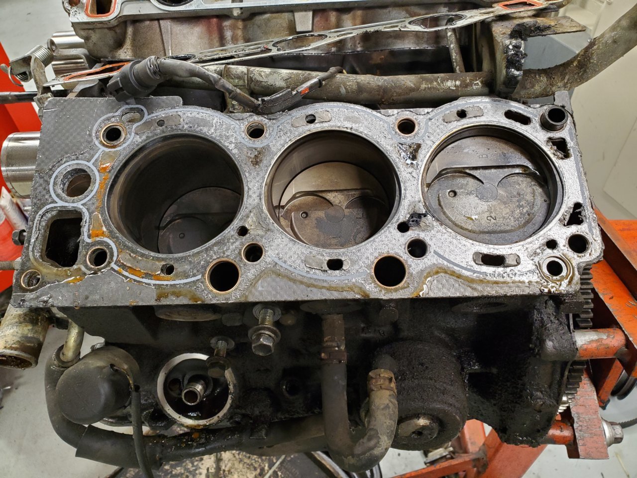

    So some interesting developments, coming on the way back from the dunes back in August the harmonic balancer came off 30 miles from home, so had had to get towed. Had to get a new pulley due to it being wallowed out and a crank shaft key also put on a new timing belt. So after is all said and done I go for a test drive I make it about 200 feet and the brake pedal goes to the floor ai have to use the ebrake to stop and not go through the intersection. I look underneath and found the steel brake line leaking behind the fuel tank. After dicking with a brake line that a made and making the flares and bending the line 20 times to make it fit the brakes work again. Again test drive made it 7 miles and bam blows a head gasket. Since this thing is such a leaking pile of shit im going to pull the motor and to a complete reseal... maybe someday it will be reliable.

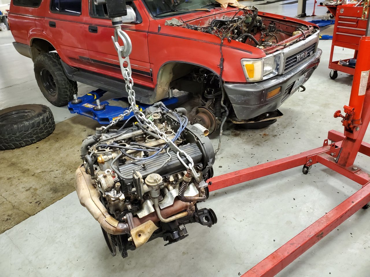

    It's out
    And now for some reason the front passenger door doesn't want to open, I guess I'll just have to add that to the list.
  17. Dec 8, 2019 at 6:07 PM
    #17
    mlcc
    mlcc [OP] Well-Known Member
    May 2, 2015
    #154429
    1,797
    Oregon
    2002 DC TRD/ 1990 4runner
    Lights, 3in lift, tires/ wheels, being awesome
    Engines out.

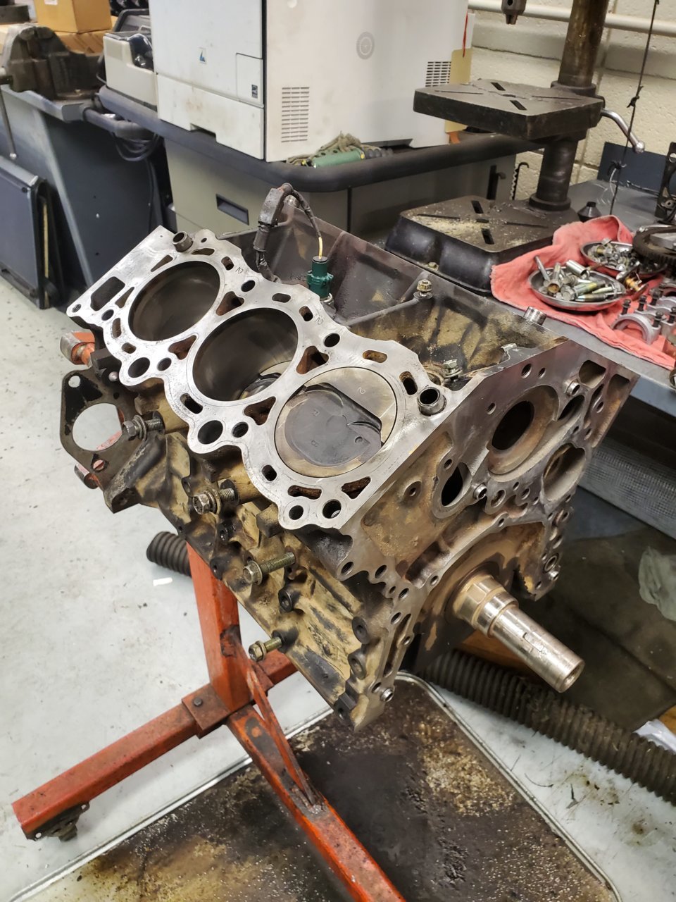

    You can see where it blew on cylinder 6.

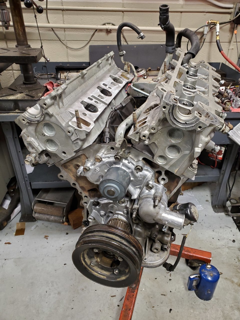

    Heads pan rear main housing and water pump on.
    Side note there was block sealer in the engine and it totally clogged the oil cooler so it took some time to clear it out but its totaly clean now and ready to go. I also had to clear out alot the the block sealer out of the block as well, but now its clean.
