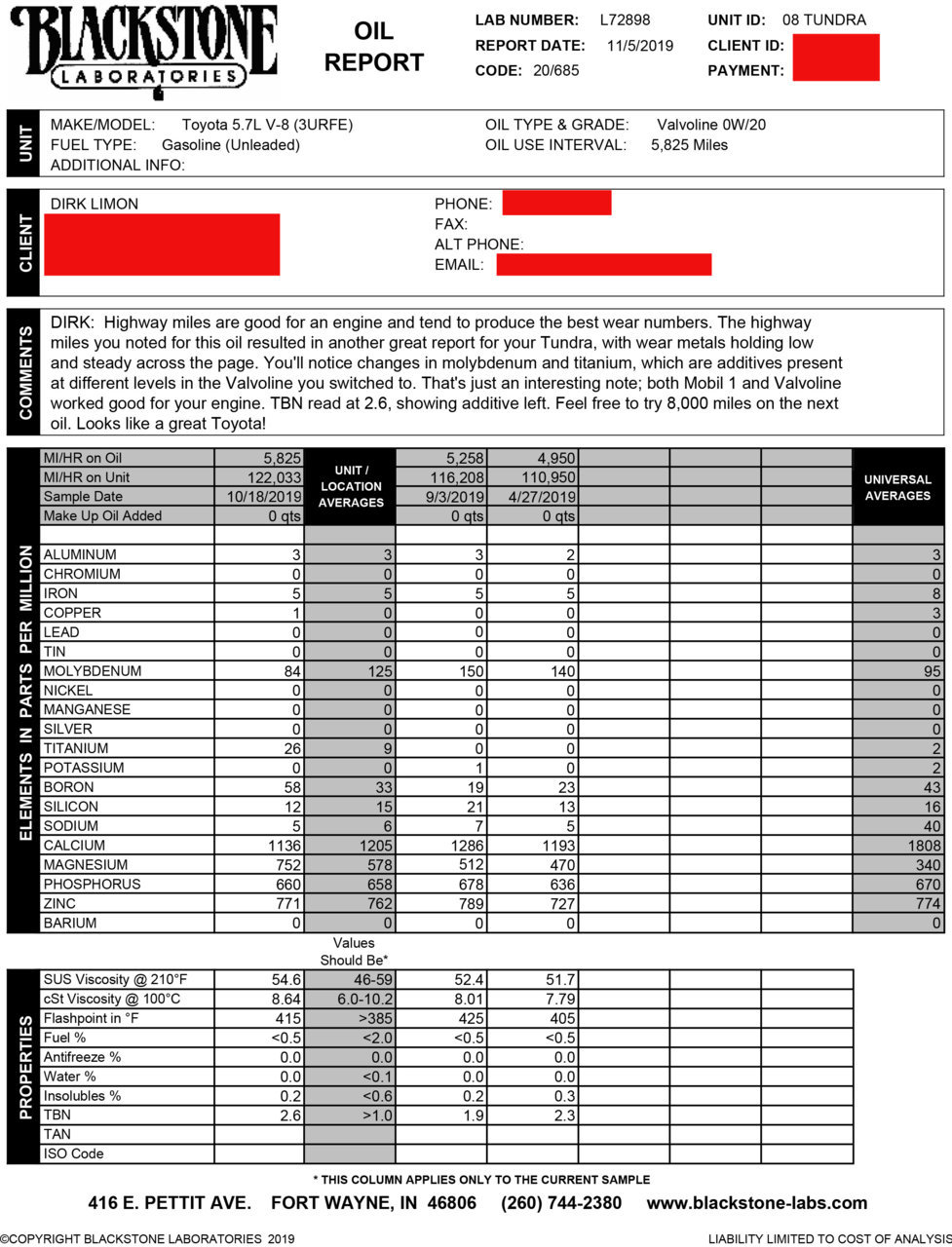

    Switching between brands is fine, don't worry about it too much OP.
