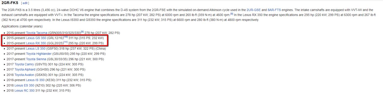

    Actually...the 2GR engine currently used in the Taco started out life in 2004 in the '05 Avalon. It eventually trickled it's way across much of the front wheel drive Toyota line up, replacing the 1MZ/3MZ engines and trickling upward into Lexus applications that shared Toyota platforms. The 1GR and 3GR engines already had longitudinal applications. So it was only a matter of time before Toyota pointed a 2GR north/south.
    It's gained some tech over the years with upgraded management systems and direct injection etc. But the basic bones are still there.
    So more accurately....your Lexus has a "Toyota" engine
