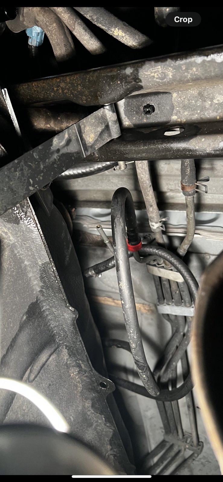

    Water got into gas because circle k got water in their gas pumps . Mobile mechanic emptied my gas tank , had to drop the tank to do so but I don’t believe he put everything back correct . Anyways I was leaking gas a Little , tried to fix it but now I don’t know what to do . Where do these fuel lines go ? Do these look correct ?

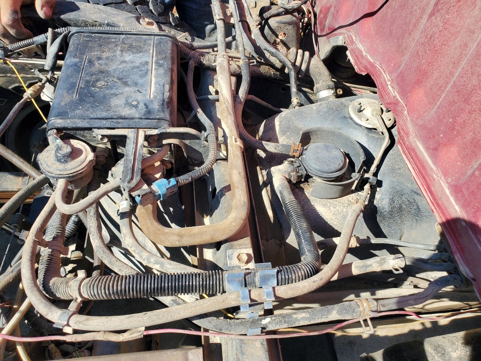

    Damn, I can *try* to pull up some pictures if I have them from when I helped my buddy disconnect everything and drop his tank.
    Give me a bit.

    That’s not a factory hose and not the correct clamp.
    Looks like the clamp let loose and the hose blew off.

    Damn, I deleted them all and this is all I've got left so hopefully it helps.
    Pulling the bed off is easy, just helps having one person on each side to lift it up and out.

    I would love to know what line That might not be Fuel Injection hose for sure not a FI hose clamp.
    If you paid to have this done I would be on the phone to have it made correct.

    It’s not a huge deal if it’s a return line.
    But it came off for a reason, hoses don’t normally just blow off.

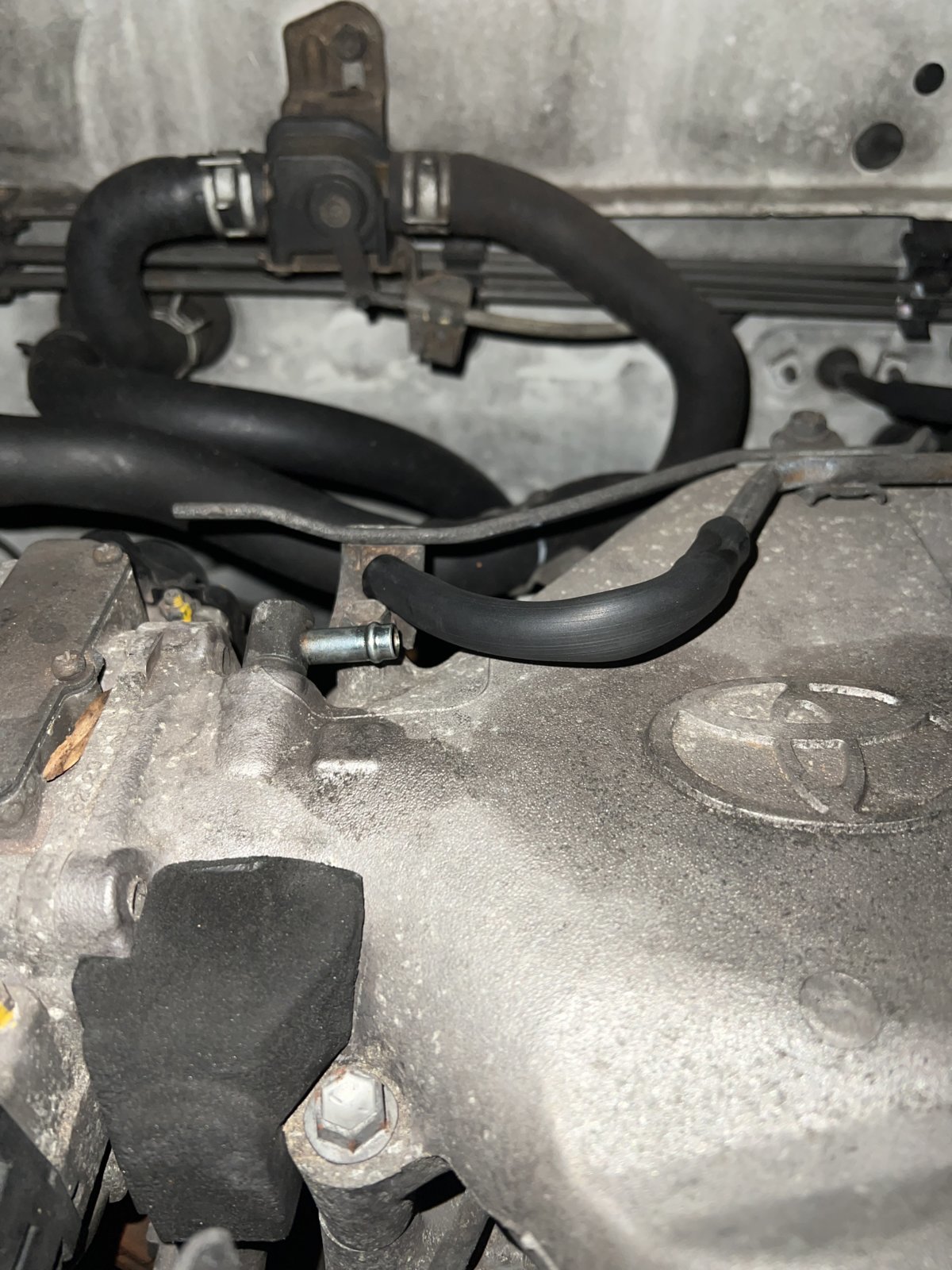

    This line keeps sucking in a vacuum and then popping off

    @Johnar92 this is T4R but pretty much identical to the 03-04 3.4 (minus the 90999-92002 hoses)
    the hose in your pic that keeps popping off is 17360B and does go to the VSV
