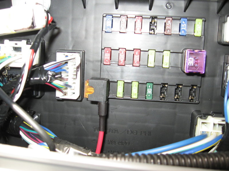

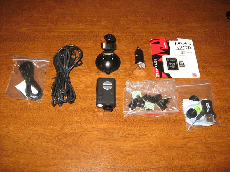

    After another driving t-boned my Lexus and resulted in insurance totaling my car, I decided with all the crazy things I see while driving, I'm going to install a dash cam in the Taco. Did some research and found the Mobius action camera fit what I needed. This came with a dash cam kit and the camera settings was programmed to run as a dash cam.

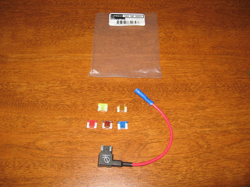

    I wanted the camera hardwired into the truck so I got a fuse tap connector.
    This is the cigarette power adapter. You need this to drop the 12 volts coming from your truck power to 5 volts, which is what the camera uses.
    In order to make the wire connection stealthy, I took the power adapter apart and soldered it directly between the usb cord and fuse tap connector
    I used the washer fluid fuse to power my camera.
    BOOM! All done and ready to roll!
