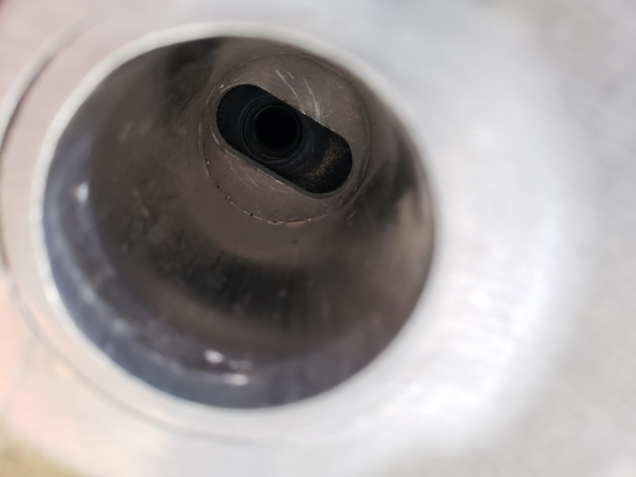

    I just finished (almost finished) installing a Mobtown Off-road aluminum IFS skid plate. I've read posts of people installing skid plates and many say "quick job, 4 bolts, 30 minutes). Not sure what brands they had, but this Mobtown piece has 6 attachment points. I was a little surprised at how much stuff comes off the truck to bolt the skid back on. The net weight increase really isn't that much... with the aluminum anyway.

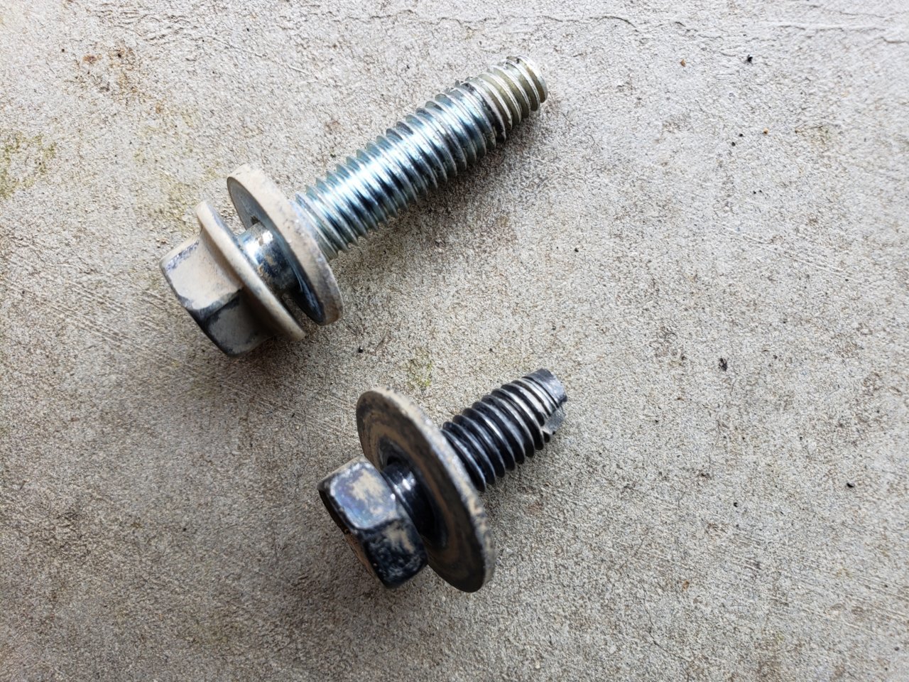

    All the holes lined up perfectly, everything was straight and the front and back bolts went in smoothly. The holes in the center are in deep sockets in which the craftsmanship is spot on. Not sure if it's just my case, but I'll have to get new bolts for the socket holes as the stock bolts are just too short. It may mention that on the website if there are online instructions or something.... but who looks at instructions :D.
    The skid is nice for now. Ill be giving it a thrashing in a few weeks, and I'll post some follow up pics. 3rd genner? Need a skid? Don't want the "fat"? Go aluminum for sure. And Mobtown really offers a nice one.

    all my stock bolts worked for my steel skids from @Mobtown Offroad. Seems weird yours are to short.

    Those center bolts will work. Loosen the other 4 so the plate is in the air but can move. Put a block of wood of a floor jack, jack up the skid between the two center post. Then thread the bolts in and tighten all 6.
    Edit: On occasion the alum skids flex a little here and there in weld. We use a fixture and it's clamped in multiple spots but it takes a ton of heat to weld thick aluminum so it will move around a little.

    I'll try that. Thanks for the pro tip.

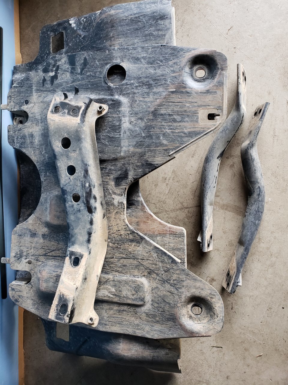

    My tranny skid arrived last week and I finally got a chance to install it. It's a pretty impressive pile of metal that you yank off to put these skids on. If you get aluminum, you are adding very little weight overall. I didn't weigh the pile of stuff that came off but here it is.
    The new skid went in perfectly and bolted up to the front skid I installed.
    I'm still having trouble with the center pocket bolts. I tried the trick mentioned above and I'm sure the aluminum is flush with the mounting spots. As I was taking the round junk bars off that are replaced by the tranny skid, I discovered those bolts are longer versions of the ones that were too short. I thought "score"... and did a little victory dance.
    But my revelry was in vain, as even they are too short. I'll hit the hardware store tomorrow for even longer ones that will reach the threads up here...
