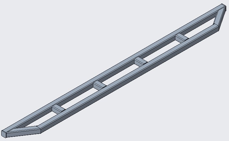

    Here's what I was thinking for the sliders:
    Made from 2" Square - 0.12" thickness, ASTM A500 steel tubing. 5-8' long pieces costs about $150 around here. These can be welded up while waiting for the mounting plates to show up. They also can be made to be flat (parallel to the ground) or tilted up 20* by adjusting the mounting tubes. I'm not a huge fan of round tubing just because of appearance, so that's why I thought of square tubing.

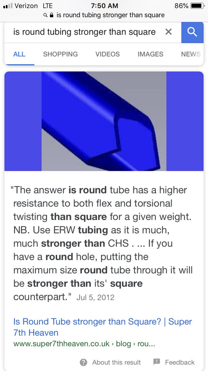

    I’ve also considered this route and gusseting the joints for strength. The only downfall is square tubing isn’t nearly as strong as round which is why that’s typically used

    I’m pretty sure it’s the opposite. At least that’s what I remember when I was talking with @Mobtown Offroad the other week.

    Cool, you can google and screen shot. I just did a quick search for sliders specifically and found that square is stronger in this application. Like I said, Joe can chime in and give his .02. He mentioned the reason why it’s stronger for sliders but I forget.
